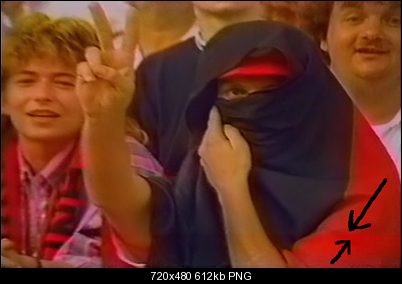

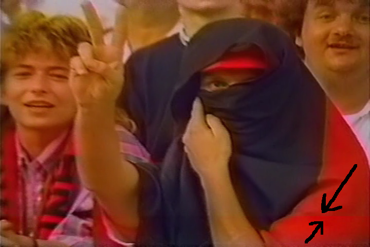

    Since we're on the subject, a little help if I may ask?
    I've had great results using the methods in my last post on those very badly damaged tapes, but, alas, life is not perfect sometimes.
    Most of my final results show no evidence of stacking, however, some, on maybe less than 1% of the frames here and there will, as you can see in the photo.
    The (good) problem with this is that it will show up on only a scene or two sometimes, not throughout the video (as you can see in the video sample attached). So I'm thinking of, maybe a more intelligent solution, or some sort of smoother of the seams.
    I would think certain parameters with autoyuv(), or smoothadjust() with its various functions, may be good candidates. Sure one can do some fancy editing for such scenes, but anyone have any ideas on a better solution, whether it's an automatic or manual one?
    Thanks in advance.
    PS: Since this is World Cup time, I've included a clip from a 1990 game. No copyright infringement is intended. As well, used DivX for low file size, hope it still can be worked with.
