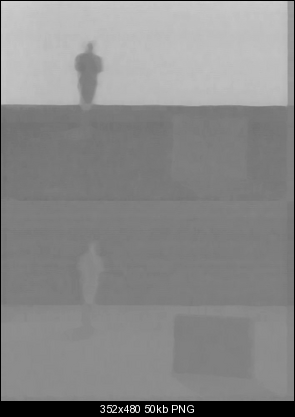

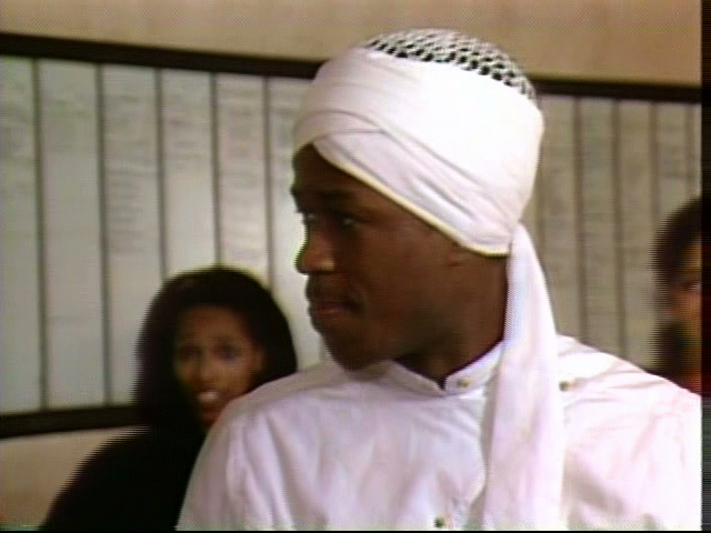

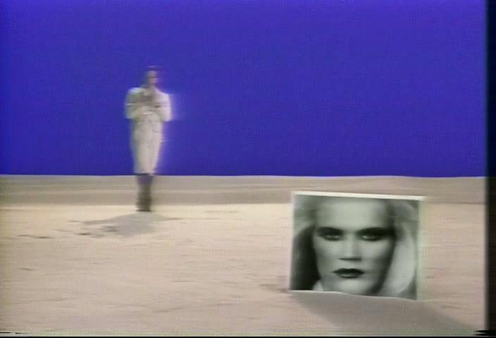

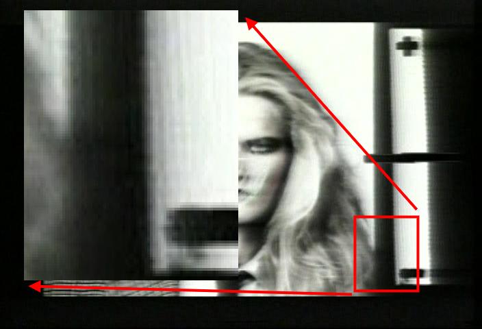

  1. I've been working on restoring some old music videos transferred to DVD-R from a U-Matic tape (from April 1983). The audio/video quality's great for the time (the music and the videos range from OK to hilariously awkward, on the other hand :P ). However, I've noticed that there's a strange smearing, almost like color-bleed. None of my chroma-shift filters have any real effect on it, so I'm guessing it's a luma issue. Strangely, it only appears on certain portions, which leads me to believe it's either a production error (proper greenscreens mustn't have been invented 'til 1990 ), or a recording issue with the original tape.
    Smearing:
    No Smearing:
    So...can this be fixed? I mean, it's not a super-huge issue, but if it can be fixed easily, then so much the better

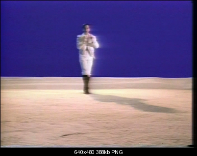

  2. Well the 1st one screenshot does have some color bleed. You can use avisynth filters to address improve the bleed a little
    e.g
    mergechroma(awarpsharp2(depth=36))

    But the black & white one obviously doesn't have color bleed That just looks like low resolution to me and exposure issues. Can't do anything about low luma resolution. You can local contrast enhancements, or try to sharpen a bit, but you will get halos
    EDIT:
    In the video sample, you have highlight areas that look to be previously clipped. That can lead to this "luma bleeding" effect , also details will be obscured in those bright areas . You can try to selectively bring down the highlights to recover some details, but most of the damage is permanent. It's tough to get rid of the actual "glow" or luma bleeding around objects in those overexposed sections, short of some rotoscoping / masking work

  3. Member Cornucopia's Avatar
    Lots of machines from that era, particularly U-matic & VHS/Beta, exhibited "overshoot" smear, where a bright or dark object left a small & slight trail to the right. The brighter/darker, the worse it got.
    This is likely caused by the electronics not being fast enough to accommodate the rise/fall time in the voltage changes of the signal. It goes to the right because that is how it is scanned (both in analog & digital) - that is "later".
    I see exhibits of that in all of those clips, though least in the last clip (2 clips, since it's from the same source).
    AVISynth is your best bet. Which filter to use...I'm not your best guide there.

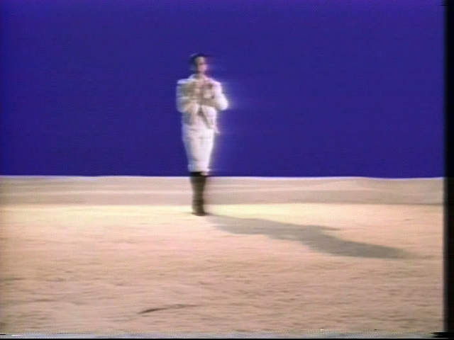

  5. I just tried something called Exorcist (which is meant for ghosting) and a simple color shift filter, and it seems to have ameliorated the situation:

    I've tried that, and all it did was make the highlights look like crap. I did lower the contrast just enough to make the video safe, and for whatever reason, that didn't harm the video much.
    I actually just looked up the VEVO upload of the first video, and you can just make out a bit of smearing on that copy, too (in addition to some chroma noise on the blue shots). So, I guess it's safe to say it was there to begin with and it's only compounded since I have an nth generation dub instead of the master.

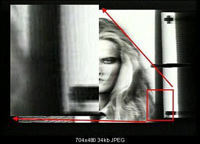

  10. You can run AviSynth under wine. I've done it before. But i'm not sure what you're talking about. These severe echos from an oversharpening filter?

    Those appear in both your videos. On all the sharp, high contrast, vertical edges.
  11. Hmm, maybe I've just had bad luck :\

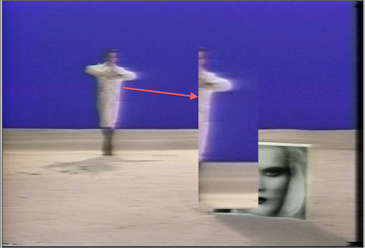

    That's not really what I was talking about. That ringing is easily filtered using a standard DotCrawl filter. This is what I'm talking about. As you can see, the chroma shift doesn't do anything to it.

  12. You need to sharpen the chroma as well as shift it.

  14. I did it with AviSynth:
    MergeChroma(src, src.aWarpSharp(depth=24).aWarpSharp(depth=24).ChromaShift(C=-2))
    MergeChroma() combines the luma channel of one video (the first) with the chroma channels of another (the second). aWarpSharp() is a sharpening filter (both luma and chroma but we don't use the luma in this example). I used it twice in a row. ChormaShift(c=-2) shifts the chroma 2 pixels to the left (I may have used 4 in the uploaded sample image).

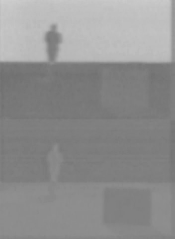

    Here are the U (top) and V (bottom) channels before sharpening:
    and after:
    You may be able to do this with an NLE by creating two version of the video, one normal, the other highly sharpened (a big unsharp mask). Then overlay the chroma from the sharpened video onto to the luma of the normal video.
