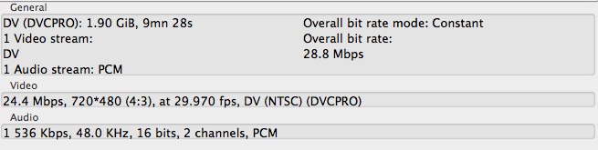

    I ran one of the DV files through MediaInfo:

  4. Wow. You are correct -- looks like QT DOES double the video track to create the audio track. I guess none of my normal processes have taken me this particular route -- or I simply haven't noticed.
    Without getting into a high-end NLE simply for remuxing, you might want to try something like ffmpeg and a command line like this:
    ffmpeg -i 123.dv -vcodec copy -acodec copy -f mov 123.mov
