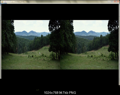

  1. I don't know if this is the right spot for this but I really need some help I have several MP4 videos the are playing as dubble image on VLC and Windows media player I have a program called Freemake video converter and I have tried converting the files to MKV (just to see what would happen) and I even burned them off to DVD and nothing is working here is a picture of what one video look like Click image for larger version

  4. looks like a normal sbs encode, if it isn't a sbs encode some detailed mediainfo might shed some light on the subject,..
  5. From a quick cross-eye check, it appears someone made an sbs encode of a 2D source.
  6. Member Cornucopia's Avatar
    That's EXACTLY what this is, smrpix. Or, at least that portion of the video has little-to-NO 3D in it.
    But yes, parsons483, that video is encoded in "sbs 3D" (aka Side-by-Side 3D), a common form for sending stereo 3D material through 2D channel. I'm guessing that whoever encoded this didn't really know what they were doing, and so ended up encoding identical perspectives from the same 2D source. Who knows, maybe they thought the app would "create 3D from 2D", which as well all know is not likely to look even close to good using simpleton apps.
    If you want this to get back to a normal 2D image, you'll have to crop out 1/2 the image and then resize to fill back to the original resolution. There are some fairly simple AVISynth scripts that can do this, but I am reluctant to take you down that path if you are already struggling with Freemake.
    The cropping+resizing WILL lose quality (as would the re-encoding to another lossy format).
    BTW, neither Freemake nor most other "converter" apps would be able to "FIX" this by a mere conversion to another codec or container (which is what you have so far attempted). It requires PROCESSING the image first.
    You already have a "compromised" image (only 1/2 horizontal resolution), which won't get better even though you may succeed in cropping+resizing. It'll always be reduced quality. Is that what you want? Why don't you get a replacement copy, that is appropriately created, from your source?
