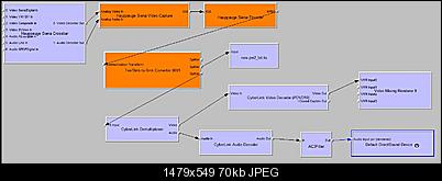

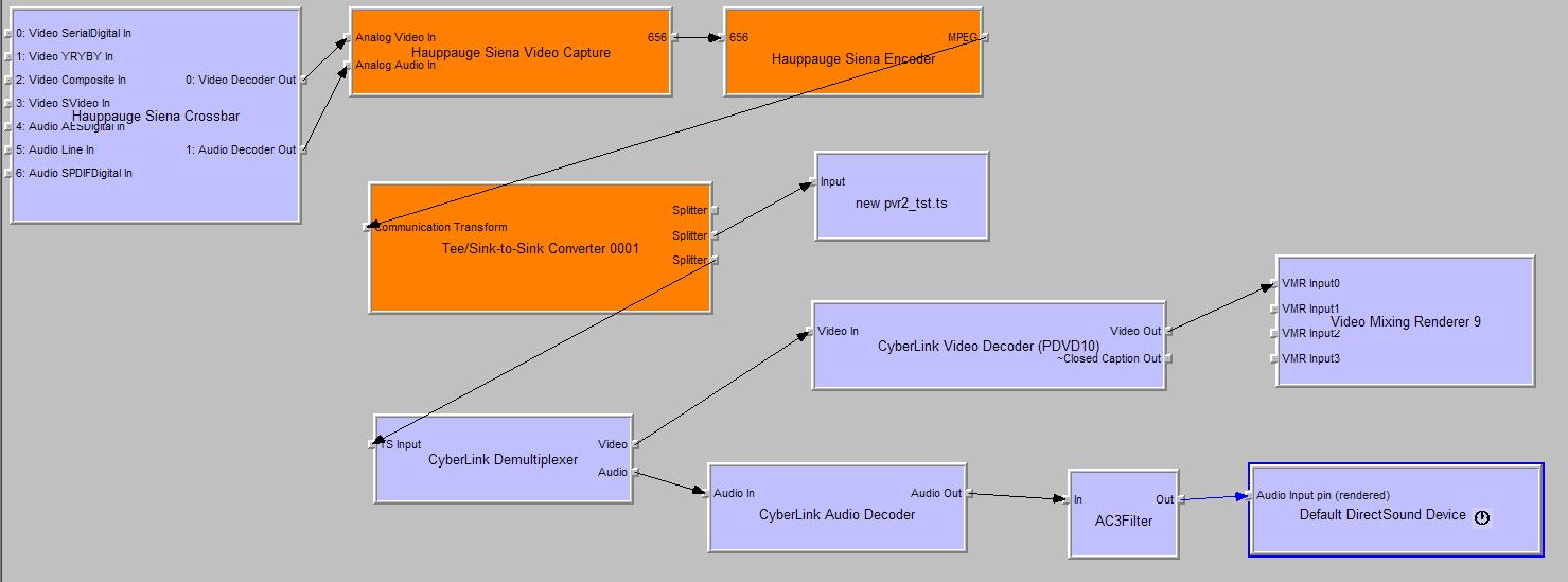

    The Hauppauge HDPVR 2 1512 (or similar gaming edition version) captures HD hdmi. If you use a graph you can pause / continue the capture with no split file (personally done and tested). Capturing 1080p 30fps (max 30 fps output for 1080p) will be only available if the source is 1080p either 30 fps or 60 fps although you can down convert real time but not on the fly change from i to p within the device driver.
    Here's what a simple graph might look like depending on the available filters on your system
Name:	HDPVR2 cap and preview latest  b.jpg
    There's not much to do but then I can't do much anyway.

  8. Thanks for all your hard work, gll99!
    That's great news!
    Here's what a simple graph might look like depending on the available filters on your system...

  13. Renegade gll99's Avatar
    May 2002
    Canadian Tundra
    That's great news!
    I must admit that, while I've seen quite of few of them, I'm nevertheless not very familiar with the concept of "graphs". I've tried reading up on them, but for me, the explanations require explanations which in turn require additional explanations, etc. Might you either point me to a very basic explanation or perhaps just summarize in words what your graph is telling me?
    Best to let Microsoft explain the nuts and bolts of Filter Graphs.
    http://msdn.microsoft.com/en-us/library/windows/desktop/dd407188%28v=vs.85%29.aspx
    Just do a quick read but don't miss reading the Hardware section.
    Check the program directory of any multimedia program installed on your computer and see if there are any files ending in .ax (DirectShow). Some of these will provide access to hardware driver functions for tuners, capture cards and all sorts of devices installed on your system. Others read input files, split outputs to create multiple output streams, demux or mux video/audio/CC/subs, convert video, resize video, convert audio, write/dump output files, display video etc... All that is needed is for these filters to be linked via pins in a specific order and manner so that they can communicate with each other.
    The image of the graph I posted is the type used in a small program provided by MS in their DirectX SDK known as Graphedit (graphedt.exe). Many software programs make use of the filter modules by linking them together via input / output pins to create a program with a nice GUI wrapped around it so the activity happening underneath is invisible to the user. Graphedit is a tool to manually build graphs using drop down lists to select and load the needed filters. The individual filters are graphically represented as picture boxes with pins that you link by drawing lines to connect them. For the programmer it saves time because it allows them to see how things connect up and make sure things work before writing any lines of code. It happens to be very handy for the average Joe too because it allows us to build, save and run graphs multiple times without actually writing a program. GraphStudio is another option.
    I'm not suggesting that building your own graphs manually is good for every situation because it is very dependent on the filters installed on your own computer and their ability to cross communicate with others. Even if I gave someone the .GRF file of the the graph I posted it probably wouldn't work if they don't have an HDPVR2 installed or the Cyberlink drivers. It might not even work if they don't have a drive "I:" because that is where I dumped the output file. It's just a picture of a sample type that can be built.
    For me what it does prove when I run it is that the Hauppauge hardware capture driver has the capability to pause and continue a capture without generating multiple files. If Hauppauge, Arcsoft or any other developer wanted to they could easily add a pause-continue function to their capture programs. After all they are running filters too with a fancy wrapper program around it.

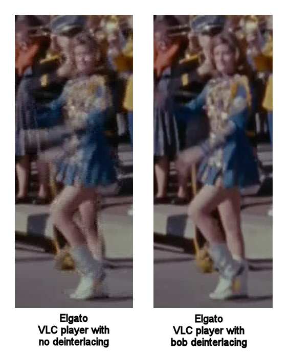

  15. What I've learned: Elgato Game Capture HD vs. AVerMedia C875 Live Gamer Portable
    As I indicated earlier in this thread, a great deal of reading here at VideoHelp Forum and elsewhere had me leaning toward the AVerMedia C875 Live Gamer Portable. So a bit prior to my reading this post by usually_quiet, I went ahead and ordered it.
    But then I did read that post, and due to a bit of uncertainty and some premature buyer's remorse after reading it (considering his comments about the Elgato), I went ahead and ordered that, too!
    They both arrived Saturday, so I had the fortunate ability to directly compare them both.
    Both devices were trivially simple to setup, and I was virtually immediately able to capture HD material from my HD DVR. Here are some main comparisons:
    PACKAGING: They both were well-packaged, but the cables that came with the Elgato Game Capture HD were vastly superior! The AVerMedia cables were ludicrously short pieces of third-rate junk, for which they have no excuse. Boo!
    CAPTURE SOFTWARE: In terms of the capture software, again the overwhelming edge goes to Elgato. Why overwhelming? Because unlike the Elgato software, the pitiful AVerMedia RECentral software doesn't provide ANY monitoring information on the computer doing the capturing while recording whatsoever! No video monitor, no audio monitor, not even recording time! [ETA: Although the lights on the capture device changes to let you know when you're actually recording]. Apparently you can do that if you connect another computer, but that's absurd!! From what I can tell, it doesn't appear to be a matter of CPU cycles either (though I didn't do any significant testing of that yet). So if the Elgato software can display smooth video, audio, and recording time, why can't RECentral? I'd really like to know the answer.
    AUTO TIMING: To my sad surprise, neither software has the ability to set recording limits by either time or disk space. In all my years of video capture, I've always had the ability to start a timed recording so that I could go and do other things without having to keep running back to check it. That's a very poor decision on the maker's fault, and it probably represents the unwarranted assumption that only gamers will be using their products. And although I can almost certainly work around that by creating a QuicKey or AutoIt script, not everyone has that ability.
    PAUSE/RELEASE, ETC: Sadly, neither piece of software allows pause and release, as usually_quiet and others correctly predicted. However, to me it's even worse than that, since the Elgato software refuses to recognize the AVerMedia LGP device, and RECentral refuses to recognize the Elgato device. Here, though, the AVerMedia LGP has a strong potential edge, in that it does provide a software interface that other capture software can theoretically connect to the device through. That interface was available to all the third-party video capture software I tested so far, such as Corel VideoStudio and ArcSoft ShowBiz commercial tools, and a couple of open-source capture tools. Unfortunately, no video ever appeared (possibly because the device needed some kind of "start" signal), and I couldn't find any way to capture audio via HDMI. Still, these are early days, and I may well be able to overcome these difficulties eventually, and if so, I might find myself with pause/resume some day.
    CAPTURE QUALITY: For myself (and I imagine a great number of others), all the forgoing factors only matter when the capture quality of the devices are reasonably close. Are they? Is it true that, as usually_quiet predicted in his previous post, the Elgato Game Capture HD probably delivers the best picture quality?
    No! In my opinion, the two devices are NOT comparable in capture quality!
    Why not? Although I was challenged in this thread on my notion that progressive video/capture is better than interlaced, that turns out in this case to be absolutely true!
    Also, the chart I excerpted earlier tells a hugely important tale. Here it is again; compare the Elgato with the AVerMedia :
    Originally Posted by vhelp View Post
    Mbps    Kbps   div   max MB datarate over usb2
    13.5    13500   8       1.6 -- hauppauge hdpvr-1/2
    30      30000   8       3.7 -- elgato
    60      60000   8       7.5 -- avermedia c875
    240     240000  8      30.0
    480     480000  8      60.0 -- usb-2 max
    At their highest possible capture quality settings, the Elgato Game Capture HD can only capture 1080i (interlaced), while the AVerMedia C875 Live Gamer Portable captures 1080p (progressive). I've uploaded three sets of comparisons of captured single frames matched with one another. Examine (or download and examine) the following three frame comparisons and decide for yourselves which of the two produces better quality results:
    Now, it's certainly true that not all the Elgato captured frames showed such horrible tearing / interlace artifacts. Many were pretty much as good as the AVerMedia LGP's. However, not a single AVerMedia frame showed anything like the ugly artifacts the Elgato produced! Let the truth be said: Progressive IS superior to interlaced!
    I have no idea if the AVerMedia LGP actually captures progressive (1080p) frames directly or if it de-interlaces the frames internally, but given the striking results, I absolutely do not care. Ten minutes of captured video was roughly 25% larger from the AVerMedia than from the Elgato, but again, I absolutely do not care. All the various weakness of the RECentral software and all the other factors absolutely pale given the...
    overwhelming superiority of the AVerMedia C875 Live Gamer Portable over the Elgato Game Capture HD in terms of non-gaming capture quality.
    Guess which one I'm going to keep?
    (Note: I have absolutely no association with either AVerMedia or Elgato)

  23. It appears the Elgato gives proper 3:2 interlaced pulldown while the AverMedia records 2:2:2:4 which gives a more stuttery playback.

    If your source is interlaced 1080i30, capturing it as 1080i30 is superior to capturing it as 1080p30. The former will retain more of the detail and fluid motion of the source, the latter will have deinterlacing artifacts and jerky/flickery motion. A decent player (and any HDTV) will deinterlace the 1080i30 capture on playback so you won't see those comb artifacts. You can always deinterace you 1080i30 caps after capturing. You can never restore the fluid motion of your deinterlaced 1080p30 caps.
    Your sample images show improper handling of the chroma channels in the interlaced ElGato caps. The colors from the two half-images (fields) have been co-mingled. That is not a problem of the ElGato captures. It is a result of the way you made the sample images -- an example of your lack of knowledge of how to handle interlaced video. That's one reason to upload sample videos -- which you finally did.
    The sample caps you provided are of telecined film. They source was film at 24 fps. It was broadcast (at least, what was captured via the HDMI cable) as 1080i video with hard 3:2 pulldown. The Avermedia cap has detinterlaced that to 1080p30 leaving a duplicate frame every 5 frames (ie, 24p has become 30p by duplicating every 4th frame). On playback that shows a little jerk every 1/6 second. The ElGato cap shows "normal" 3:2 pulldown judder when played back at 60 fields per second.
    You might be better off capturing real HD material to evaluate the abilities of the two devices. Try capturing some liver sports like soccer of American football. You'll see what a flickery mess 1080p30 delivers.

    A last gift to the OP, EmmB, who will undoubtedly complain that I should have posted this in the first place rather than give him/her a richly deserved verbal kick in the pants for his/her rant.
    Here are sections from two screenshots made by VLC. Although these are just highly compressed jpegs, they should be enough to prove a point about software players and interlaced video playback
