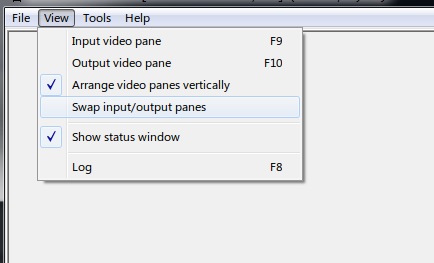

  4. Member Cornucopia's Avatar
    The output pane would be previewing the output of the FILTERS that are applied to it. It DOES NOT EVER show output AFTER compression encoding (at least not in Virtualdub).
    So, to repeat - make sure you:
    1. Have the [View | Input Video pane] checked
    2. Have the [View | Output Video pane] checked
    3. Have the [View | Swap input/output panes] UNCHECKED
    4. Have the [View | Pane Layout | Both panes] checked
    And I just confirmed, if you have a null transform filter in line, your videos WILL and SHOULD look identical.
    The output pane is NOT meant to be a "compression" preview window.

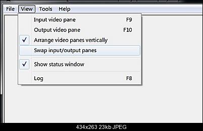

  6. Experimental Koti's Avatar
    Jun 2009
ID:	25730 Maybe the swap panes tab got checked ?
