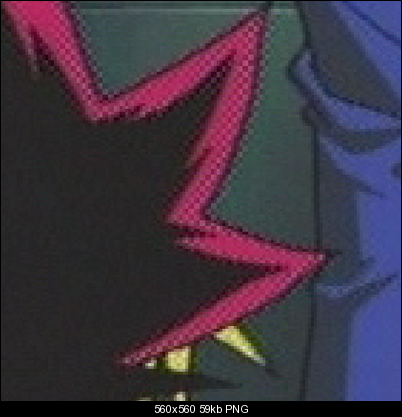

  20. I see lots of dot crawl. 4x point resize:

    Yep, that could be looked at as dot crawl. Looks more like chroma upsampling error (CUE) to me, but whatever. Resizing blurs it, sharpening brings half of it back. I've seen similar effects with the AVT-8710 TBC. I tried some anti-dot plugins, but little or no effect without killing everything in sight. You don't see this effect in some areas, but you see aliasing.
    I couldn't find the frame you used, but I tried several others. I'll take everyone's word for it, but IMO the cures look worse than the disease. Whatever.
  22. Dot crawl is caused by incomplete removal of the chroma from the luma when splitting a composite signal into chroma and luma components. So it shows most intensely when the chroma signal is very strong -- ie, with highly saturated colors. The OP's video has been through a 2d comb filter which has removed a lot of the dot crawl from still parts of the picture. But it takes a 3d comb filter to remove dot crawl from moving parts of the picture. Further, the video has been MPEG 2 encoded creating DCT ringing artifacts of the dot crawl dots.
    I don't remember exactly what frame my crop was taken from. But it was somewhere between 185 and 194.

    Yeah, I can see it that way after your explanation. At first it just looked like old fashioned CUE that I've looked at since my first DVD player years ago. I think I'd settle in this case for partial cleaning -- getting all of it is gonna result in zero video to look at. If what you describe is the story behind this DVD, it just bolsters my belief that when it comes to processing, enough is sometimes too much. Anyway, thanks for the story on this one.

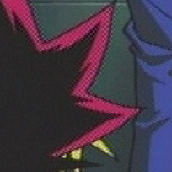

    I've cleaned up dot crawl alot with checkmate. Yeah it can have its side effects but I don't find it utterly horrible. I was just for the first time having issues with it making ghosting alot more obvious or making it seem like theirs more.
    I think this cleaned up nicely without getting destroyed.
    (Pics Removed from image host)

    Yep, that does look pretty nice. But try it on something more visually complex than standard anime. The best way to handle dot crawl is to avoid it -- and don't we all wish it was easier done than said, LOL !!
