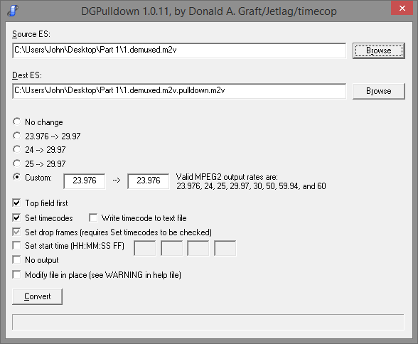

    OK. At the end of the DGIndex, it tells me that a "Field order Transition is detected" and asks me to correct it. Should I?
    Also both framerates in DGPulldown should be 23.976 right:
    This is what i'm using.

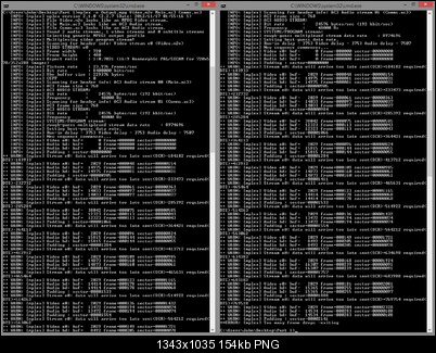

    OK, i've tried now, it's failing to encode it, saying "too many frame drops"
  30. Anonymous
    Guest
    Are you using the GUI app from my site that I linked?
    First try it leaving out the commentary track.
