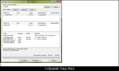

    1) Make a copy of your entire Blu-Ray folder somewhere on your computer. This copy is for editing; keep the original just in case you make a mistake. You may eventually get confident enough to skip this step. Also in "Options" you can enable backups and specify a folder to put the backups in. I think there's less chance for confusion/mistakes if you just work on a copy to start with.

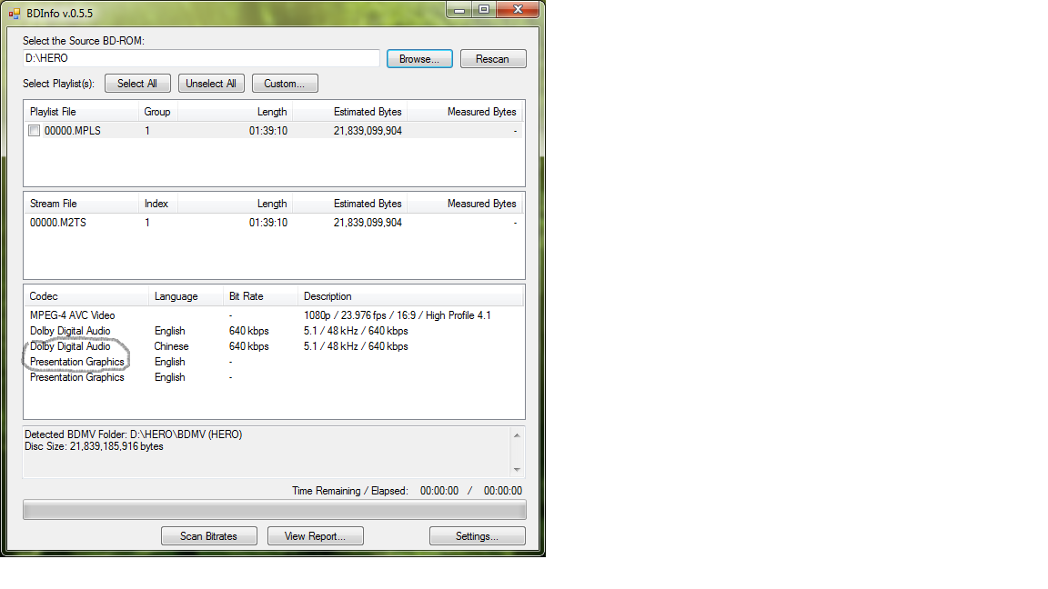

    2) Analyze the folder with BDinfo. You need to know the ordering of the audio/subtitle streams.
    For this guide, I chose the movie Hero (movie release 2002, Blu-Ray release 2009). I want the default audio to be Chinese and to turn on the main English subtitles (translation of the Chinese audio, not commentary). Note that the audio stream wanted is listed second, after the English dubbed stream. The subtitles wanted are listed first.

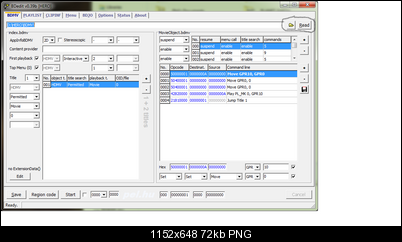

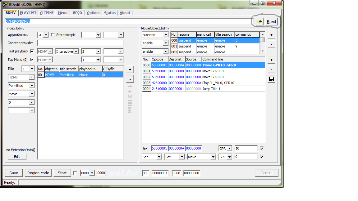

    3) Open the ripped folder with BDEdit and click "Read".

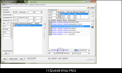

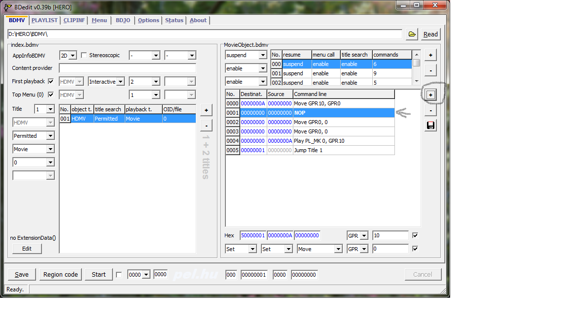

    4) On the right side there are two fields. Click the "+" next to the lower field; this creates a new line for the command you're going to add. Click on the new line (NOP).

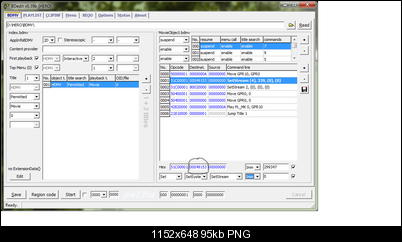

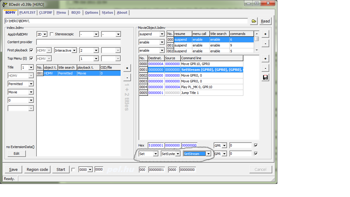

    5) On the three drop-down boxes at the bottom left of the field, do the following, starting from left to right: "Set" for the first box, "Set System" for the second one, and "Set Stream" for the third. In that order.

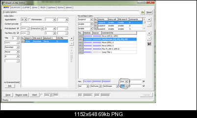

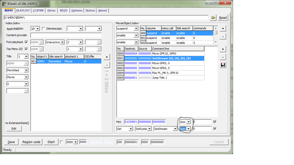

    6) There are to the right of the three set boxes two more drop-down boxes, stacked one on top of the other. Set both to "Imm".

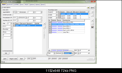

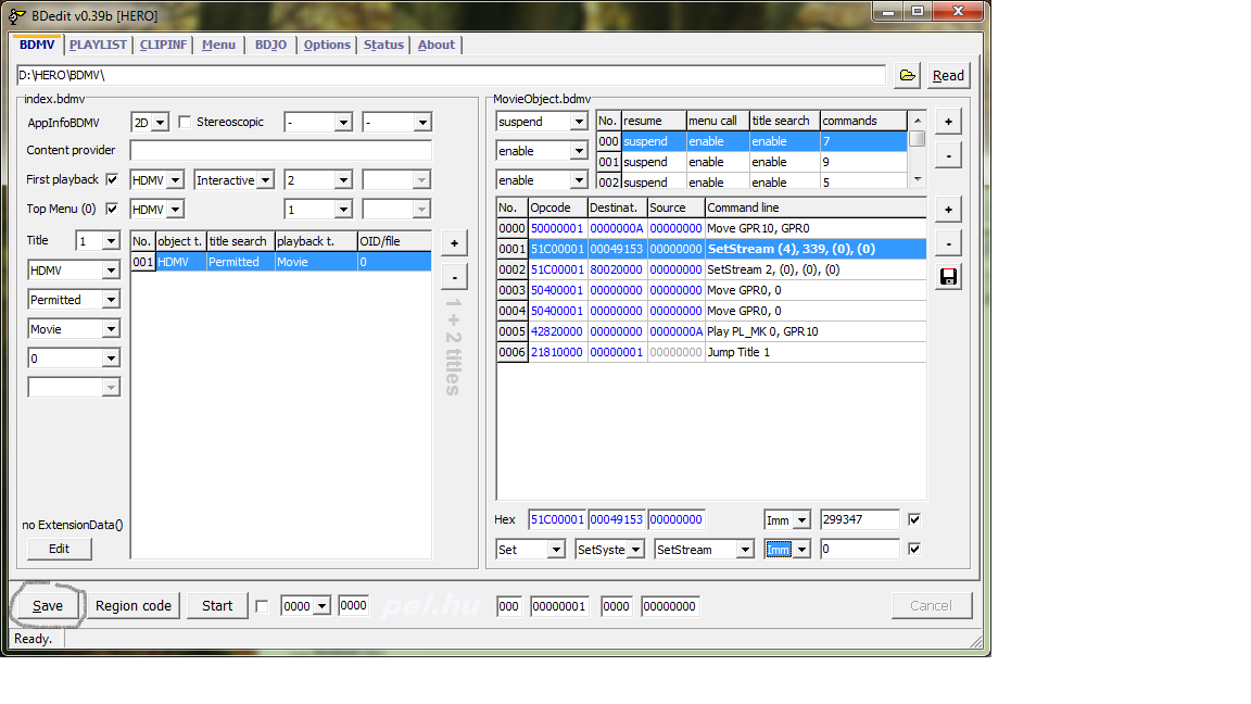

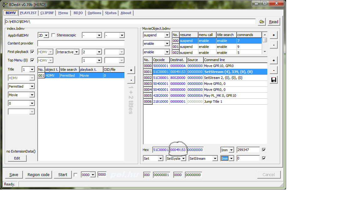

    7) Now you're going to enter the stream number in the center "Hex" box. For turning on a subtitle, the values are from 49153 for the first subtitle stream, 49154 for the second subtitle stream, and so on. If you only have one it's easy, enter "49153". (Make sure the two stacked check boxes all the way to the right are ticked.) Save before you do anything else.

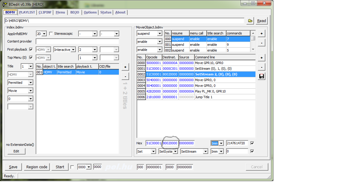

    8) For turning on a specific audio stream (making it the default) the procedure is the same, the values starting at 80010000 for the first stream, 80020000 for the second, and so on. Hit Save. Each command requires creating a new line, BTW, by clicking the "+" button.
