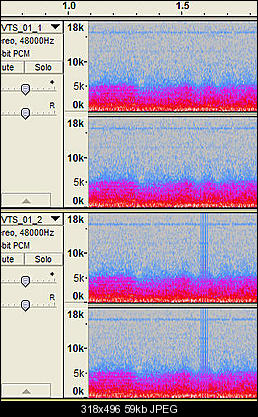

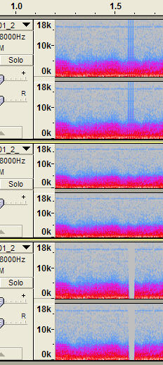

  6. By the way, I noticed that Audacity's spectrum view makes the beeps very visible:
    That makes it a little easier to find them.

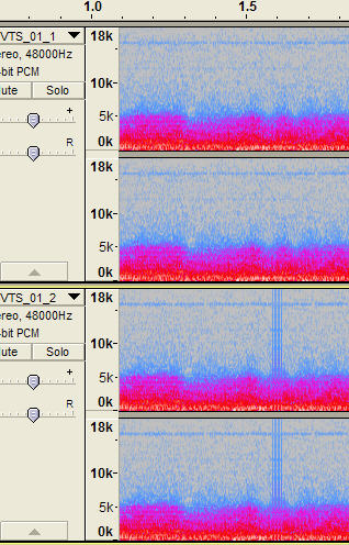

  8. Describe exactly what you did to get the VOB, all the steps
    1st was demuxed with dgindex, 2nd demuxed with eac3to , 3rd was the 1st run thru delaycut
    delaycut log from the dgindex demux

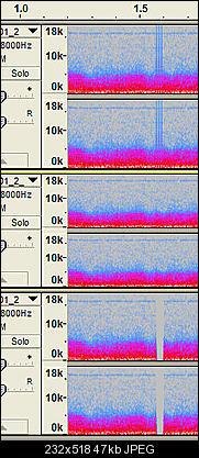

    Those time frames coincide where audacity shows a blip, and you can hear a beep
    Delaycut can fix the errors, but the repair isn't perfect, it just reduces the volume, deletes the area leaving a gap
    Eac3to produces perfect results, but the running time is shortened by the end. I think those gaps/blips might keep it in sync with the video, I'll look into it more later

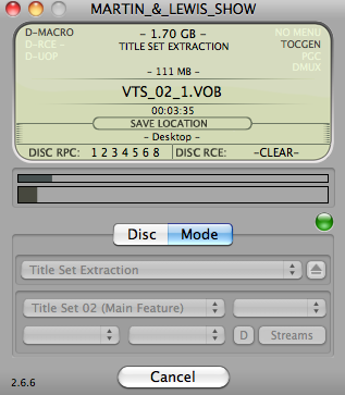

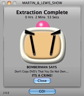

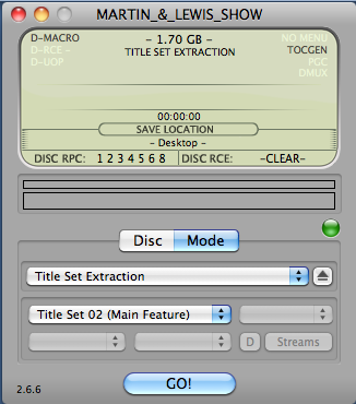

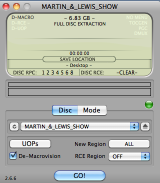

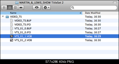

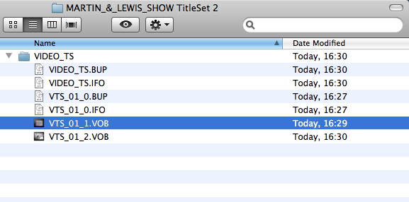

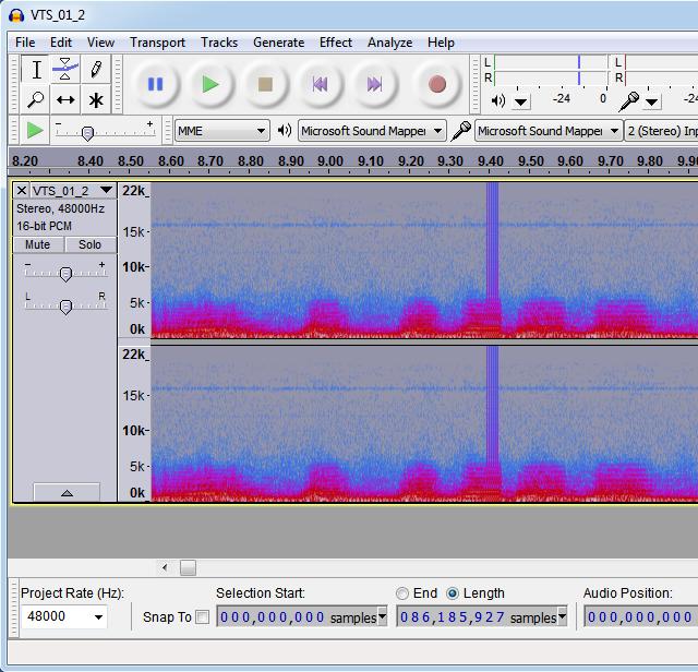

    Here goes:
    Name:  Screen shot 1.png
    Name:  Screen shot 2.png
    Name:  Screen shot 3.png
    Name:  Screen shot 4.png

  10. I'm not sure if some of the problems were caused by decrypting / ripping . You might go to a friend's house and try some PC tools for that part.
    But this workflow works correctly (at least for this latest sample); proper duration, no blips, in sync when remuxing if you're going back to DVD-video (tested on several players) :
    1) convert to wav with ffmpeg
    e.g
    ffmpeg -i input.vob -vn -c:a pcm_s16le output.wav
    2) apply whatever filters/restoration in your audio editor (the original topic of this thread )
    3) either keep it as uncompressed wav or re-encode back to AC3 (I tested both)
    4) use compliant DVD-video muxer & authoring tools

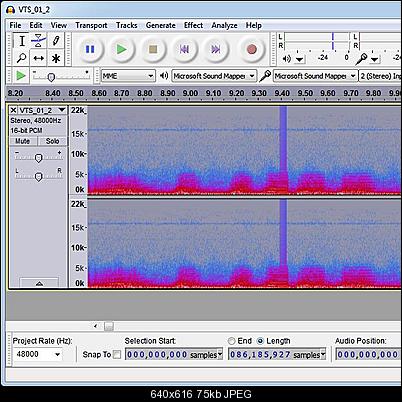

    (1st is the processed final VOB , 2nd is the original VOB , both loaded directly into audacity (not demuxed audio)

  21. Originally Posted by HitTheRoad View Post
    Poisondeathray, Do you mean you found 39 bleeps in the VOB? Really?
    Yes, 39 . Check for yourself - open the original VOB in audacity. Look at the times and errors in the delaycut log file in post #38 - 39 entries. It's more than coincidence that each error entry time matches perfectly with the blips visible and audible in audacity. Some are much more noticable than others, some sort of blend in to the background music
    If you leave it as is, you might only hear a few of them. Some software players may conceal or have error correction built in - you might not "hear" all of them until you start applying some manipulations. For example, with MPCHC, I can hear them all clearly played from the VOB directly. Other players might be using different decoders, I might only hear a few (e.g. with KMPlayer which is related to Mplayer). The point is there can be variation in how it's played back depending on the decoder used. Did you want it "ok" with only a few players, but still defective? If it was up to me, I would want to do it properly. So it's perfect everywhere. Recall on the previous page where a processed sample was uploaded and there were more beeps. And the beeps aren't limited to audacity - I verified this in other software like sony vegas pro, premiere pro
    I wouldn't be satisfied that the problem isn't from the decrypting and ripping until I checked with various pc ripping programs. This is not a "Mac vs. PC thing." The fact is there are many more tools available on the PC platform. Yes, many of them are crap, but many things aren't even available on a Mac
    Eitherway, clearly there are problems with this particular VOB. Do other properly ripped DVD's "act" even remotely like this? Hell No . If only 1 title was a problem - ok there might be something wrong with that particular disc. Or it might be using some new fancy encryption. But now you say you have over a 1000 rips in your collection that might have beeps. I think that strongly suggests there is something wrong with your process, or the tools used in your process
    And what about other potential problems ? Maybe there are other issues from the decrypting you haven't noticed yet. And maybe there were other issues caused by those processed by mpegstreamclip as well

    I've always had the same workflow. I'd let MacTheRipper do the ripping, and I used MPEGStreamclip to select fragments from VOBs and convert them to MPEG2.
    I never did any editing. So that's why I never noticed there was something wrong.
