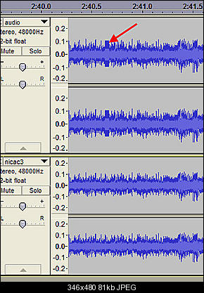

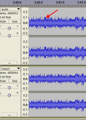

  21. Yes there are errors in the stream. They coincide temporally with the beeps. If you run the audio through delaycut:
    (windows only)
    ====== PROCESSING LOG ======================
    Time 00:00:25.760; Frame#= 806. Crc2 error SILENCED: read = D1A7; calculated=B1A4
    Time 00:01:09.888; Frame#= 2185. Crc1 error SILENCED: read = 3F15; calculated=86E3
    Time 00:02:40.640; Frame#= 5021. Crc1 error SILENCED: read = 102B; calculated=C8EA
    Time 00:03:08.736; Frame#= 5899. Crc1 error SILENCED: read = A71A; calculated=78E7
    Time 00:04:32.960; Frame#= 8531. Crc1 error SILENCED: read = EA21; calculated=1FFE
    I remember Scott saying there were a bunch of issues with mpegstreamclip, maybe this is one of them?
    It seems some AC3 decoders have different types of error handling. Avidemux uses ffmpeg libraries, so it should have the "beeps" too if decoding
    NicAC3 seems to ignore the errors, or you can't see them on the waveform or hear them
    Anyways it would probably be a good idea to start from the beginning

    The funny thing is, whenever one of my MPEG2s has a beep it's always at the very end of the file, when it stops playing. The Rosemary Clooney kinescope has a beep too. You can hear it when played in MPlayer OSX Extended. It's only since yesterday that I learned more beeps can be heard when listening to the remuxed AC3.
    It's clear to me now I'd better avoid MPEG Streamclip whenever editing clips from VOBs.
    But what can I do to repair the damaged MPEGs from my collection and get rid of the beeps? Can I do this without having to demux them and repair the audio in Audacity or some other audio editor??
