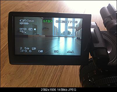

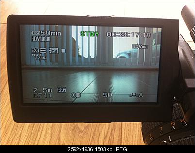

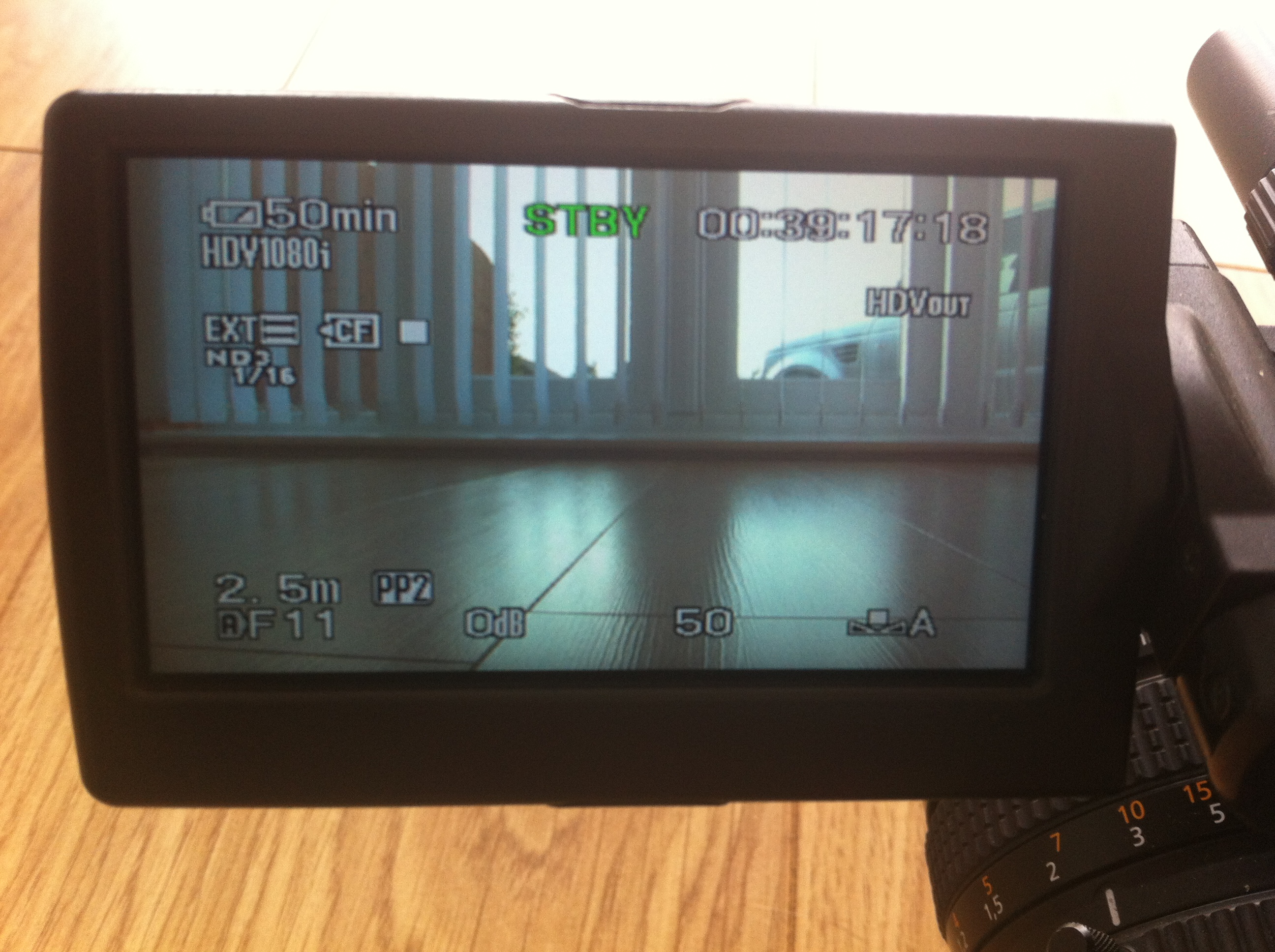

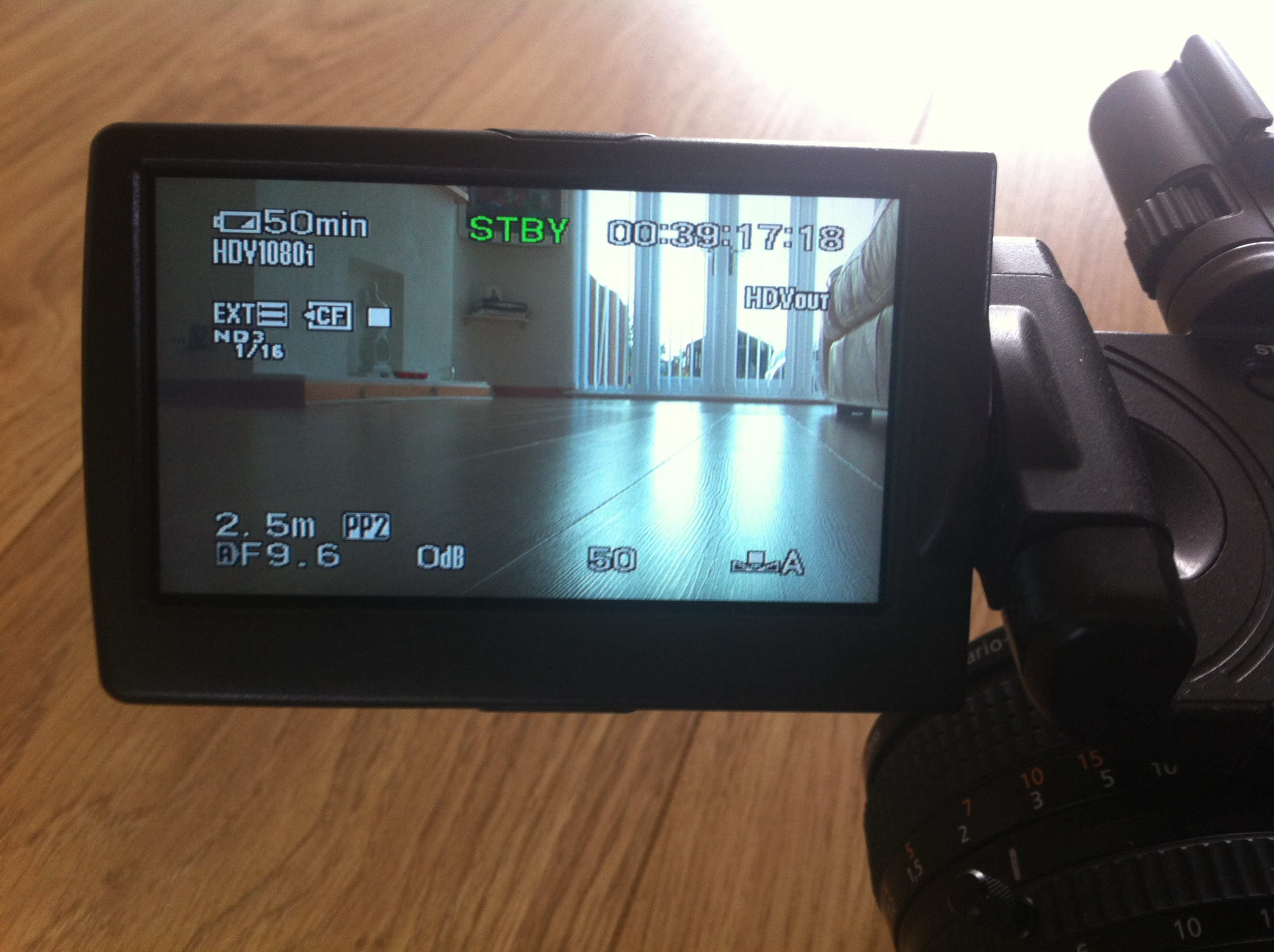

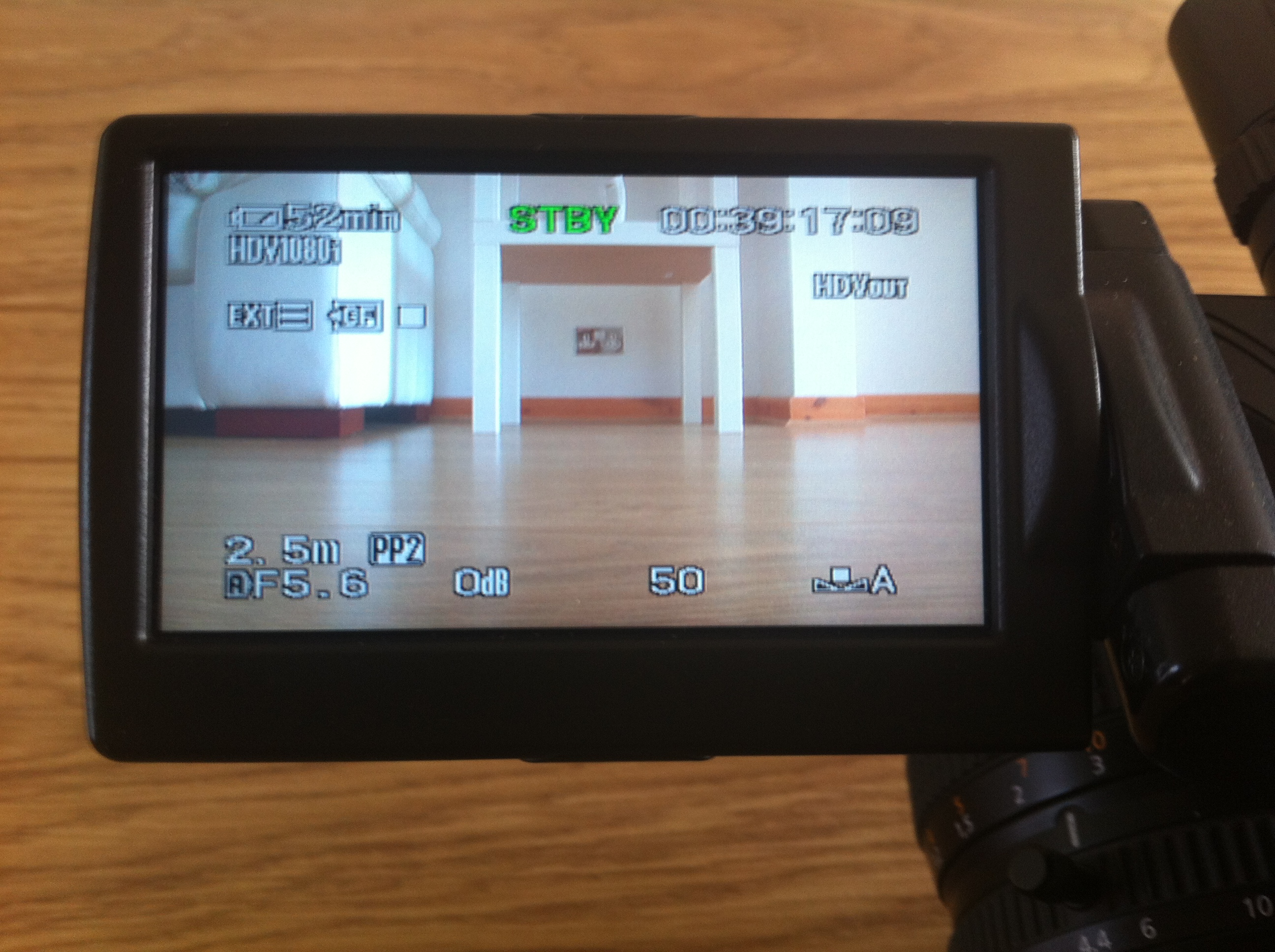

    Hi, reset normal picture profile and just seems the same, for all i know this could be normal, I have attached 2 pictures and on both its set at nd2 and calling for nd3, the light comming in is not direct sunlight but is bright, do you think the appature numbers looks right for the conditions? Thanks Click image for larger version

  8. It doesn't look unreasonable -- but an actual captured frame, or short clip, would be more helpful. Point it at something other than a light source -- even better a test chart.

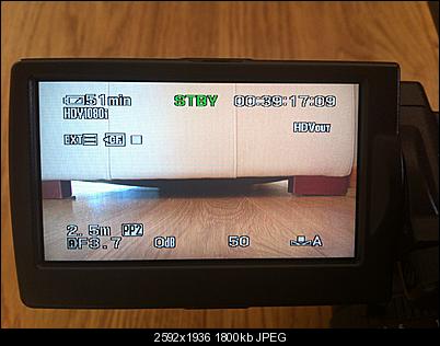

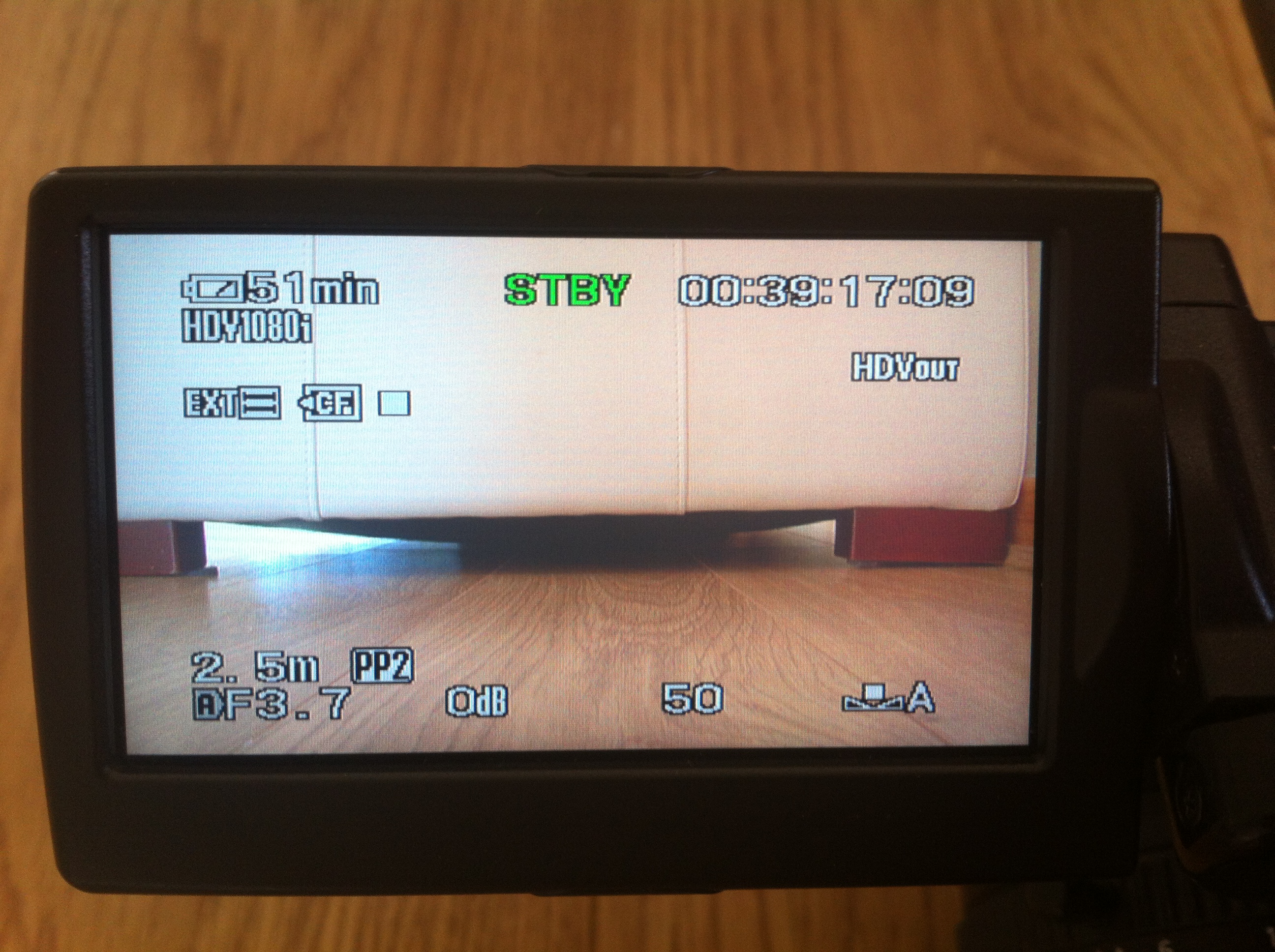

ID:	25684Click image for larger version
    No nd on these 2 pictures will upload a clip in the net few mins , thanks for your help btw

  11. Aside from normal YouTube artifacts, nothing looks noticeably off for an auto iris shot. 1/50th is the slowest shutter speed you can use, so the iris will be open the most. If you're looking for a lower f. stop, (short depth of field?) raise the shutter speed, lower the gain and add ND's. (You can add filters to the front of the lens if you need to.)
