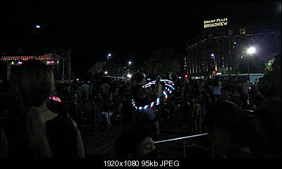

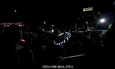

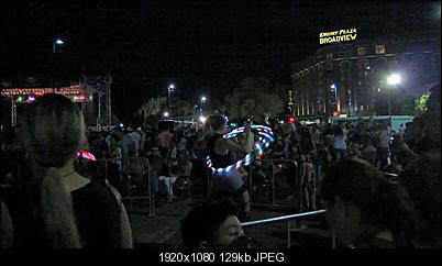

    If look at that video you'll see that it isn't just "dark". It's pretty grim with super-blacks. Capture a frame from the vid and throw it in a gaphics app that lets you mount a histogram, and you'll see the sharp cutoff of dark detail. You ought to be able to eyeball it, actually. There's a point where dark detail just stops dead, even if you brighten it. You can make it lighter gray, but you won't get much detail. What you do get could depend on some masking and contrast filters, or in something like Premiere Pro, Vegas Pro, or AfterEffects you could play with contrast adjustment layers, levels controls, and other fancy stuff. Even with those tricky tools, when you get below black clipping level what you're going to see is noise, pure and simple. You can already see what happens when you raise the common "brightness" control. It just makes super-blacks into super-grays. So it all depends on how deep you want to go into heavy duty processing.
  14. There's no "best" adjustment. It's a matter of what you want it to look like and what compromises you're willing to make. If you want to bring out dark detail without blowing out brights you want gamma ajustment, not brightness/contrast.
    source with incorrect rec.709 interpretation (what most players/editors will use):
    source with correct pc.709 interpretation:
    after gamma adjustment and increased saturation (to bring out colors in the dark areas):
    Of course, you don't have to go that far with the gamma. Or you could go further.
    That video was reencoded with x264. Where's the original?
