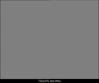

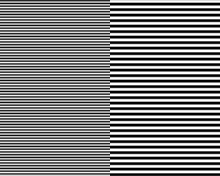

    Try resizing this vertically by 2 percent:
    Obviously, that's a special case but you often see thin near horizontal lines in real world video. Things like blinds in a window, skyscrapers in the background, etc. You end up with buzzing moire artifacts.

    Thanks jagabo, that is a pretty convincing test!
    These effects did not show in the 'Universal leader' but now I also see serious blind-like artefacts in actual movie clips which I overlooked before.

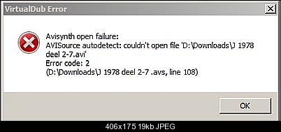

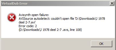

    A few months now, I have been using johnmeyer's great script. It worked fine at least until August 30, when I used it last.
    Today I tried using it again, but all of a sudden I am getting this Error code 2:
    The error description refers to line 108, which in John's script reads:
    source1= Avisource(film).killaudio().assumefps(play_speed). converttoYV12().
    Furthermore, all the other (similar) scripts which I used succesfully until August 31st now return exactly the same error message!
    Consequently, I suspected my Win7 computer and tried System Restore, but that does not work any longer. It appeared that an "Essential update" had been performed on August 30 and I got more suspicious. However, when I tried to unistall that update, I found that the very last update had been done on August 19th (KB 3087985), i.e. NOT on August 30.
    I'm at my wit's end. Who could help me getting this fantastic script working again?
    Many thanks in advance!
  23. In what codec is the AVI? If you don't know use MediaInfo on it. Do you have that codec installed? For example, can you see it in VDub in Video->Compression? If everything is okay there, maybe reinstall it.

    A deep MBAM scan did not show any important threat. So I am back to square one:
    the johnmeyer script does not work anymore and shows the error mentioned in #232.
    Any help will be greatly appreciated!
  26. Does a simple AviSource() script work? What about loading some other file with DirectShowSource() or ffVideoSource()?
    I think "error code 2" means no file with that filename was found. Check the full path and filename of your video file.

    Thanks jagabo. Meanwhile I did some simple scripts with Avisource, like this one:
    colorbars(720,480)
    KillAudio()
    BicubicResize(320,240)
    Trim(0,300)
    and this one, with one of my own avi's:
    Avisource("D:\Desktop\AVS tests\J 1978 deel 2-4.avi")
    Trim(0,300)

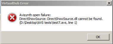

    They all run on Vdub AND, surprisingly, on Windows Media player but NOT on MPC-HC, which simply crashes each time I try to open any of these scripts !
    When I changed the latter to
    DirectShowSource("D:\Desktop\AVS tests\J 1978 deel 2-4.avi")
    Trim(0,300)
    I got the following error message:
    I looked into C:\Windows\System32 and C:\Windows\SysWOW64 and in both directories DirectShowSource.dll is missing indeed.
    I seem to remember it has been there once but I'm not sure. Moreover, as you can see in that 'famous' line 108, the johnmeyer script is using Avisource.
    In case I do need the DirectShowSource.dll please let me know how to download and install it because the Sourceforge-site is driving me fairly crazy..
    I may not have been quite clear in #232, so allow me to elaborate a little.
    I have been using the johnmeyer-script successfully on some 20 different avi's. The only thing I changed every time was the title of the avi and each one of these scripts ran fine and resulted in near perfect movies, until August 31st.
    Luckily, I saved these already used scripts. However, when I try to open them in VDub now, they all return the error message mentioned in #232.
    I'm looking forward to any clue you may have!

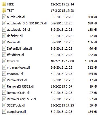

    Thank you manono. What you find on your computer looks very similar to what I found.
    And yes, Source1 and the other things are mentioned elsewhere in the script and, again, please note that the script has been running perfectly and that I have not changed anything other than the avi title, as I did before on each of the avi's processed.
    Your efforts on my behalf are highly appreciated!
  29. directshowsource.dll should be in avisynth's plugins folder. If that's missing maybe something else is too.
    And keep in mind. All components must be 32 bit, or all 64 bit. For example, you can't play 32 bit AviSynth scripts with a 64 bit media player.

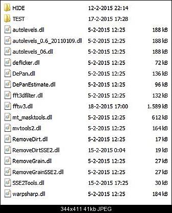

    This is the AviSynth plugin folder on my PC:
    DirectShowSource.dll sits in the sub-folder HIDE. Somebody advised me to put it there in February this year. It has been there ever since and the johnmeyer script worked alright in this setup until August 31st. Should I put it back?
    As far as I know there is nothing else missing.
    Do you see anything irregular in that line 108?
    Yes, I know everything should be 32-bit, thank you.
