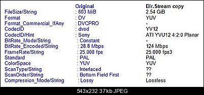

    Now I am at the stage where I wish to import the resulting avi in Premiere.

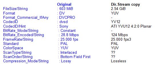

    MediaInfo specifies my original scans as follows:
Name:	Orig vs Dir.Str.l.JPG
    In order to change as little as possible I set VirtualDub to 'Direct stream copy'. Apparently AviSynth has changed a lot. Anyway, too much for Premiere, since it does not accept the resulting 2.5GB avi.
    Then, I tried a 2 pass XVID compression (at max. bitrate: 4369Kbps!). Only the second pass resulted in something useful as it was accepted by Premiere, but only 93MB in size which is too little and visibly so. Further specs: MPEG4 visual, YUV, Lossy, Progressive.
    The first pass resulted in a useless avi file of only 111 kB.
    By the way, the 2 passes were not performed automatically as I expected and resulted in 2 separate avi's.
    Now my question is whether, from your vast experience you could advise me on how to get an avi out of VirtualDub that stays as close to the original specifications (and size) as possible.
  3. Your problem with Premiere has nothing whatsoever to do with the script, but instead is caused by the codec you use. Some editing programs won't import certain codecs.
    HuffYUV, Lararith, or MagicYUV are lossless codecs, and if you have the disk space, those are the best choices, and I think you can get most editing programs to accept video encoded by these.
    Since you started out using a DV codec, it would be easiest to stay with that. I use the MainConcept DV codec. I forgot how much I paid for it. You used to be able to download a DV codec made by Panasonic. Google that, and perhaps you can find it somewhere.
    If you use the DV codec, it is hard-wired to encode the video as interlaced. Don't worry, this won't hurt your captures. However, when you edit the result, you'll have to override the interlace setting and tell your editor that the video is progressive. I only use Vegas, so I don't know how to do this in Premiere.
    XVid, MP4, X.264, and MPEG-2 are all lousy format for editing and I would not recommend using those. They are great formats for delivery, but not for editing.
  4. I would avoid using the DV codec for your intermediate unless you need that much compression. There's no need to introduce DV artifacts (however light) after your careful filtering.
    The output of your AviSynth script is YV12. When you set VirtualDub to Direct Stream Copy the resulting AVI file will be marked as using a YV12 codec (though in this case it's not really a codec but the AVI file has to identify what form the video is in). I don't use Premiere but the problem is probably that it doesn't understand what the YV12 codec is. You probably need a VFW or DirectShow YV12 codec. Try using ffdshow and enabling its YV12 "decoder". Or you can use one of the lossless codecs that work in YV12. Like Lagarith or UT.

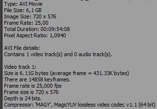

    You may remember the lengthy thread on my efforts to get johnmeyer's perfect script running..
    Thanks to your help, I succeeded and I'm still amazed about the results!
    As I said in my last posting #190, for the resulting avi I decided to stick to MagicYUV since this is a lossless format, which is probably beneficial during further processing in Premiere.
    However, to my regret I found that MagicYUV changes the
    Display Aspect Ratio to 5:4 (1,25) instead of 4:3 (1,33) and the
    Pixel Aspect Ratio to 1.00 instead of 1.07.
    The result is that the image becomes slightly stretched vertically: heads e.g. are somewhat egg-shaped.
    Could somebody tell me how to correct this in Magic YUV?
    Meanwhile, I have also done numerous experiments with XVID but there too the problem is persistant.
    Thus far, only the Panasonic DV Codec produces a 4:3 image, but it is a lossy format and the quality is slightly less than the results with Magic YUV.

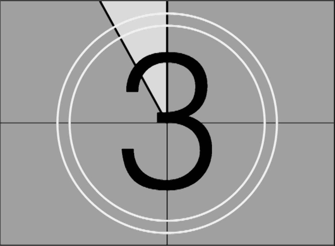

    Thanks jagabo, as a direct result of your comment I found that possibly the cause lies in Premiere.
    This is what I did.

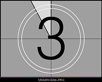

    Premiere contains a 'leader' used by Universal in the old days in front of every reel of film. The important thing is that it contains a perfect circle.
    The project monitor in Premiere displays this as indeed a perfect circle in a frame with an aspect ratio of 1.37 : 1 (!)
Name:	1. Premiere Monitor 1.37 x1 .JPG

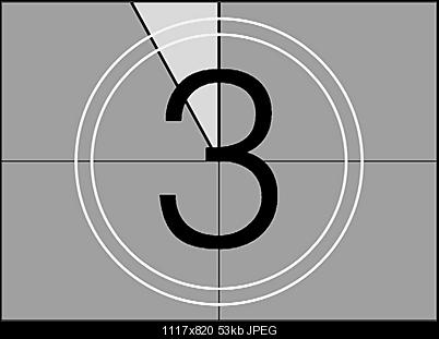

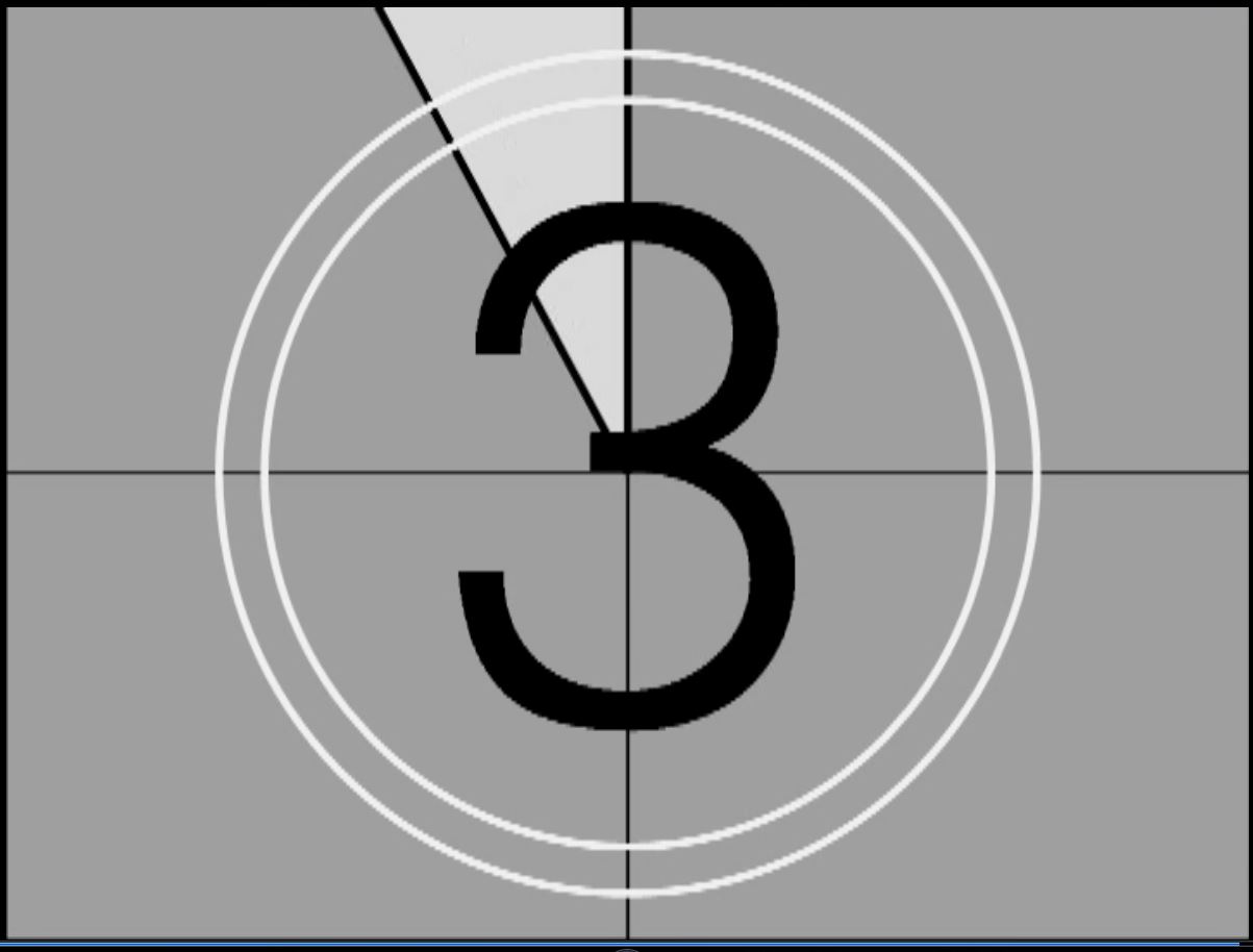

    Part of this clip I exported as an avi and now the aspect ratio is 1.33 :1 which represents the normal 4:3 ratio. However, as you may see, the circle now has become slightly egg-shaped.
Name:	2. Premiere Exported 1.33 x1 .JPG
    This is part of the Mediacoder report.
    Name:  3. Exported avi.JPG
    Everything here looks in accordance with the standard, but it is annoying seeing e.g. the cars in my movies having egg-shaped wheels..
    Of course I can reduce the image height in Premiere but then I am left with black bars above and below the picture.
    The whole thing seems illogic. I realize being off-topic with this question but I would be most grateful for any comment you may care to make!

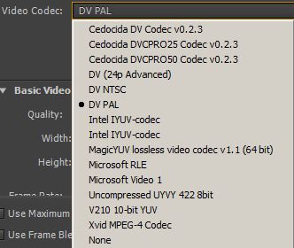

    Nothing can be changed here. That is possible only in the Export window where I can choose from different codecs:
    However, this is what I described in #197. In some of these codecs there is an option to change the AR. I have tried that in all available codecs, but with no result. Even if I chose 4:3 (1,33) the egg shape is still there..

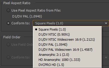

  25. Member
    Oct 2014
    The Netherlands

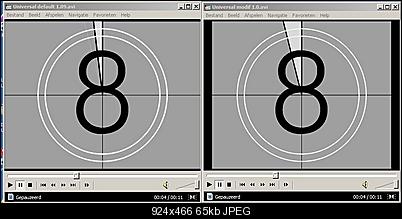

    Thank you again for the excellent tutorial by Andrew Devis. Unfortunately, it did not help in getting a better result. Premiere does allow a change in Pixel Aspect Ratio, but not in the desired direction, since I could only change PAR from 1.09 to 1.0 i.e. square pixels:
    Name:  Interpr. footage.JPG

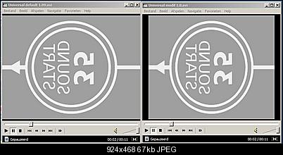

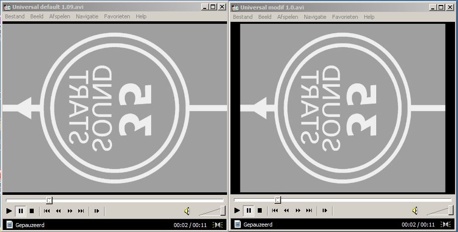

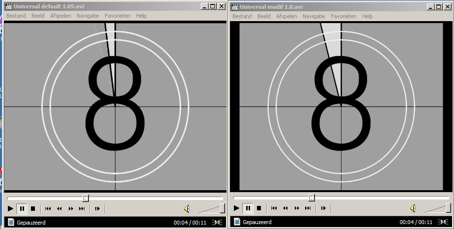

    Nevertheless, I tried the 1.0 square pixel ratio and then funny things occurred!
    Left you see the default 1.09 avi which (as reported earlier) has a slight vertical egg shape. In the right picture (PAR 1.0) one would expect an even stronger egg shape, but that does not happen; the circle's dimensions are exactly the same as those in in the left picture. In the right picture only the frame is somewhat narrower.
Name:	Univ. Circle Eight 1.09-1.0.JPG
    However, purely by accident, I found that in a different part of exactly the same clip a different circle did become more egg shaped:
Name:	Univ Start Sound 1.09-1.0.JPG
    1. How this could occur in one and the same clip, only seconds apart from each other is an absolute riddle to me. I do hope it gives you a clue as to how the original problem could be solved i.e.
    2. The slight but disturbing egg shape as in the left pictures above..

    3. In #206 I mentioned that in one and the same clip, only seconds apart from each other there are 2 different circles. One is displayed slightly egg-shaped (as mentioned before) but the other is strongly distorted.
    Any idea how this could happen?
  28. Originally Posted by minimax View Post
    Although things are fine in the Premiere project monitor, the resulting avi is not, being slightly stretched vertically.
    Your method of comparison may be flawed. The AVI container doesn't really flag pixel or display aspect ratio. Some codecs do internally but players may or may not respond to the flags. And even when players do respond they may not do so accurately. For example, with DV the codec can specify 4:3 or 16:9 DAR. But unless a program knows that DV uses a rec.601 pixel aspect ratio (where the DAR is contained in a 704x480 or 704v576 portion of the 720 pixel wide frame) it may play the video incorrectly. For example, as 1.33 DAR, not ~1.36 DAR (1.33 * 720 / 704).
    This should not happen. Are you sure you didn't apply different filters or something? Try creating the video again from scratch.
  29. Originally Posted by minimax View Post
    If you could advise me on how to solve this, I would be most grateful.
    I've no idea as I don't use Adobe Premiere. Ordinarily, Academy Ratio films on DVD fill the whole 720 width of the DVD with active video (no black bars on the sides at all). That's still no guarantee it'll be played properly but it's about the best you can do short of adding slight letterboxing.
