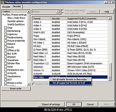

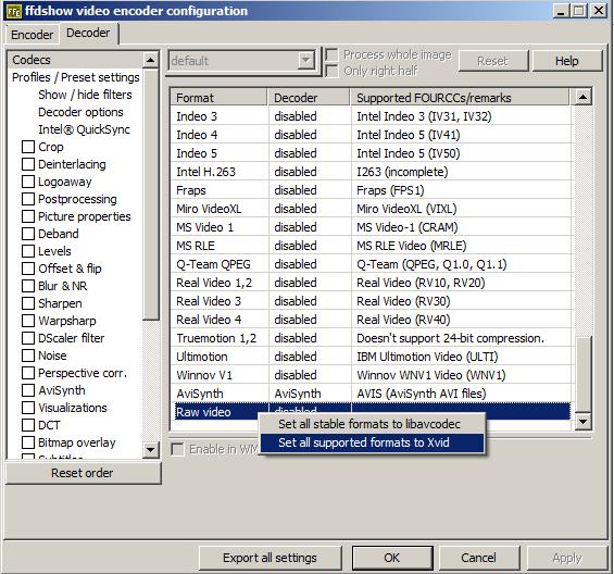

    2. I did install ffdshow, but again, I have no idea as to how to work with the program or how to enable the row video codec.
    Start -> All Programs -> ffdshow -> vfw configuration -> Decoder tab -> Codecs (left pane) -> Raw Video (right pane) -> All Supported (pulldown).

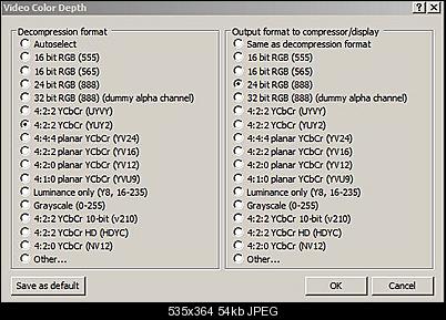

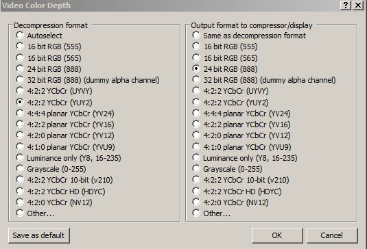

    3. I looked into Video -> Color Depth -> Decompression Format -> YY2:2 YCbCr YUY2.
    In the list I could not find YY2:2 YCbCr YUY2 and this is part of what I see:
    Cut/Paste Typo on my part: 4:2:2 YCbCr (YUY2).

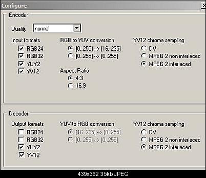

    1. Thanks, yes of course. (in #30 I probably changed it only in VDubMod....) It won't happen again.
    Now it looks like this in VDub:

    2. In ffdshow I did this and then pressed OK:
    3. I'm not quite sure of what you mean by 'Cut/Paste Typo on my part: '
    Below you see what I did: I clicked 4:2:2 YCbCr (YUY2). Is that OK?

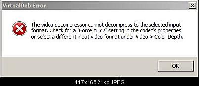

    after the above changes the avs script still runs fine and the straight avi still causes the "canot decompress" error:
Name:	Cannot decompress1.JPG

    Even after saving 4:2:2 YCbCr (YUY2) as a default, I am still getting the "cannot decompress" error.

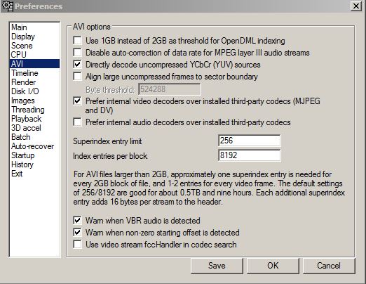

  5. If you need to directly open then in vdub and play with the input button for some reason, one way to do it is change back to vdub's internal DV decoder in the preferences. AVISource() won't use vdub's internal decoder (it will still use cedocida)
  6. You don't really need to play the videos in VirtualDub anyway. You just need to see the result of the script.

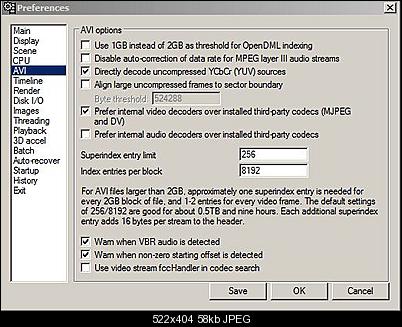

    Thanks poisondeathray, it works fine again.
    Are there any disadvantages to this change?
    Here is the present state of 'Preferences, AVI'
Name:	VD Preferencesl.JPG
    Disadvantage is you use vdub's internal decoders for DV and mjpeg. Whatever that might be... Generally you're safe , but there are times when you might want to use a 3rd party decoder

    b) Could you let me know whether I did the right things under 1, 2 and 3 in post #62?
    Those look fine. Now that you know Cedocida is working you can reenable RGB24 and RGB32 output from Cecodida if you want. I use libavcodec rather than Xvid for raw decoding in ffdshow. I don't think it makes any difference for YV12.

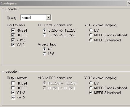

    Earlier (#27) you told me to "disable all outputs except YV12" in the Cedocida configuration dialog.
    Nevertheless, at present both the YUY2 and YV12 boxes are checked. Is that a problem?

  18. Originally Posted by minimax View Post
    That was when we were trying to figure out why you weren't getting YV12 from Cedocida. It turned out your video wasn't DV but rather RGB.
    No. As has been pointed out numerous times, you can use the pixel_type argument to specify what format you want out of the decoder if you don't get what you want by default.
