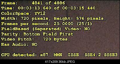

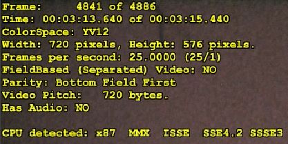

  1. That should be fine. Try the following script:
    AVISource("D:\AVISYNTH\Exercises\Carnaval-0.avi")
    Info()
    Does it show YV12?

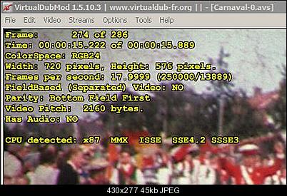

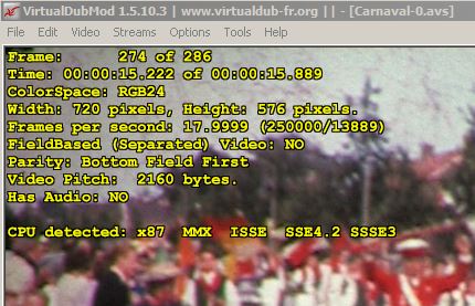

    Interesting! I replaced the script by this, as advised:
    Info()
    and this is the result:
    Seems to be RGB, not YV12. Looks like it is interlaced after all and, as you thought, a complete frame consisting of 2 fields.

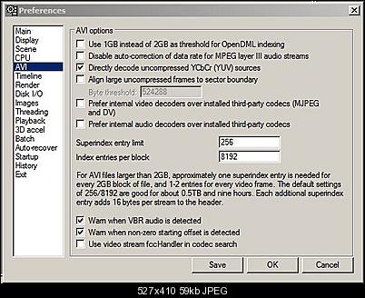

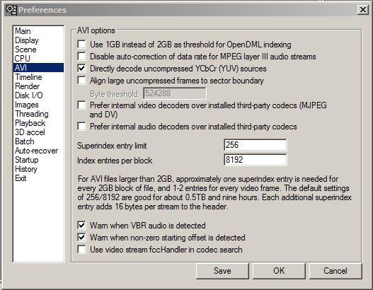

  4. Probably you have another DV decoder currently installed, and cedocida isn't being used
    Make sure the internal vdub decoder is disabled first (options => preferences => AVI => uncheckmark prefer internal video decoders over installed third party codecs) , then load a DV-AVI file directly into vdub, and use file=>file information; what does it say ?
    You can use something like VCswap to disable/enable various VFW codecs
    Oct 2014
    The Netherlands
    Hello poisondeathray, see below: the box already was unchecked

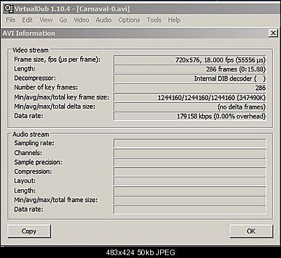

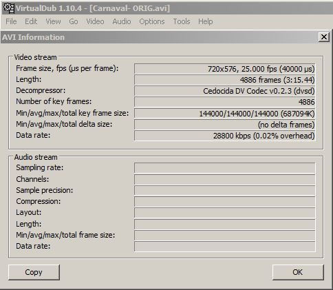

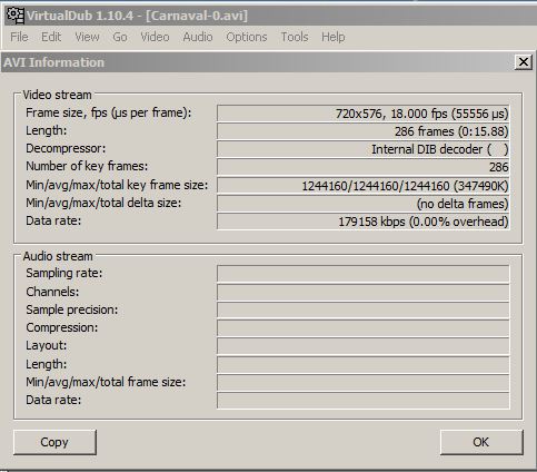

    then I loaded Carnaval-0.avi and according to file information the Internal DIB decoder is in use.
Name:	AVI file info.JPG
  6. If cedocida was installed and working properly, it should say "cedocida" . If you can't get it working by fiddling with vcswap or other VFW configuration tools; alternatively, you can use another source filter like ffms2 (external plugin, requires .dll)

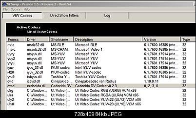

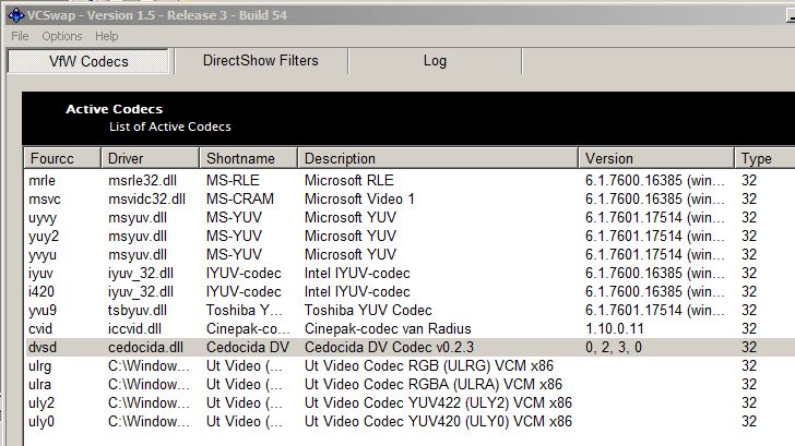

    I had a look at VCSwap. However, being a newbie I have no experience with swapping codecs.. So what should I do next?
  8. Are you sure you are using 32bit vdub, 32bit avisynth , and have cedocida 32bit installed ?
    In vcswap, cedocida should be under the list of "active" codecs. If it is not , and instead under "inactive" codecs , then select it, right click and choose "activate"
  9. Also verify what you have is actually DV (fourcc should be dvsd)
    Use mediainfo (view=>text) on the source file, copy & paste the text back here
    Oct 2014
    The Netherlands
    poisondeathray,
    Many thanks for your fast comment.
    This is what I see in vcswap:
    1. It looks like cedocida is active. Does the 'Type [32]' indicate that it is 32-bit?

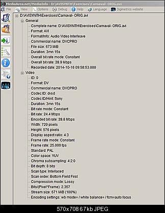

    poisondeathray & jagabo,

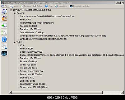

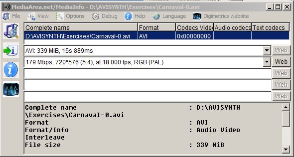

    I got MediaInfo installed (offline) and saw no mention of OpenCandy. I'm hoping for the best..
    I ran MediaInfo and here is what was found:
    It still does not say whether the avi-file is interlaced or progressive.
    I do hope it gives you a clue and I am looking forward to what you would suggst next.

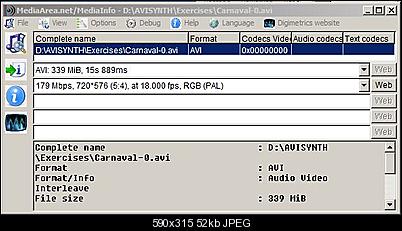

    Oct 2014
    The Netherlands

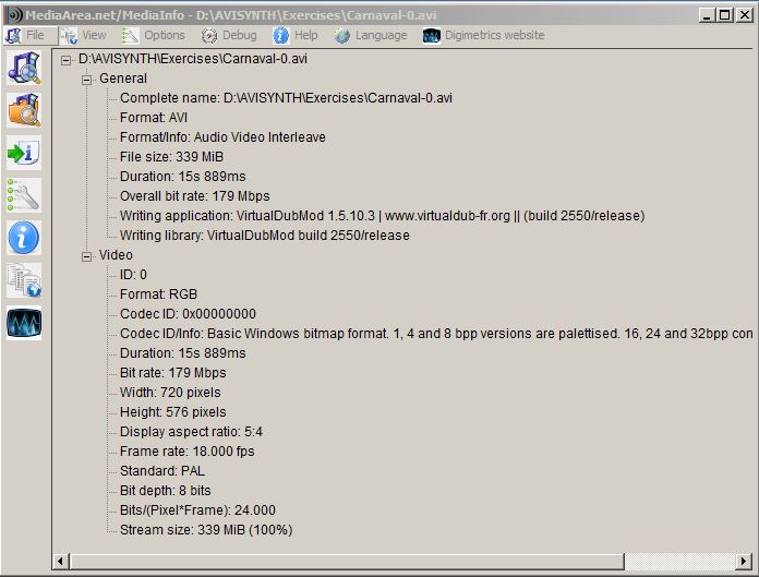

    Found more information in the Tree-layout:
  16. Member Cornucopia's Avatar
    @minimax,
    So clearly that AVI is NO LONGER a DV format but an uncompressed RGB format, counter to what you led us to believe.
    You can fix your RemoveDirt stuff by prepending a "ConvertToYV12" or "ConvertToYUY2" command.
    However, this leads me to ask - What happened to your original DV capture?
  17. Your video is uncompressed RGB, not DV AVI. And it's only 18 fps, not the 25 fps PAL DV would be. How did you make that AVI? If you used a firewire port to capture from the DV camcorder you should have gotten DV AVI.
  18. Member
    Oct 2014
    The Netherlands
    A deep red is colouring my cheeks, obviously I made a terrible mistake.
    What happened is that, in VDub, I cut a short test movie from the original scan, made a horizontal flip, changed the speed to 18 fps and saved it as 'Carnaval-0', without realising that this would change the properties of the file so drastically!

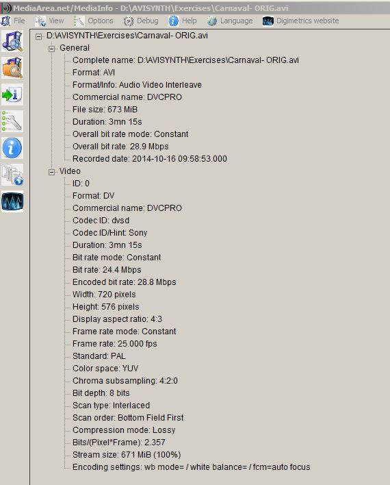

    The original scan was made with a setup much like Fred v.d. Putte's, using a Canon camcorder instead of a webcam. The scan was done at approx. 4 fps and a firewire connection was used between camera and computer.
    Here is the MediaInfo report on the original scan:
Name:	Carnaval- ORIG.avi IM .JPG
    Now I recognise many of the things you mentioned...

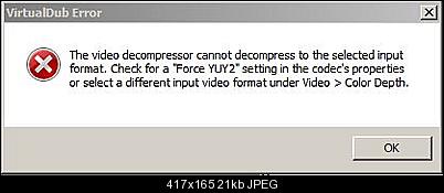

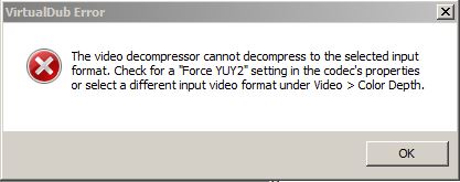

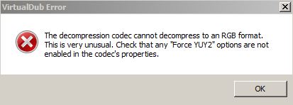

    OK, subsequently I tried to cut another short from the original (in VDub) and I got this message when
    pressing Input-playback:
Name:	Cannot decompress1.JPG
    I could play the movie only when pressing Output-playback.
    In VDubMod, I cannot play the avi at all and I get this message:
Name:	Cannot decompress2.JPG

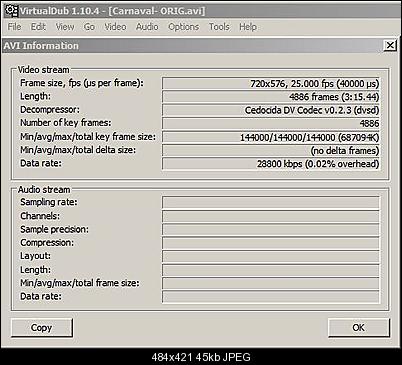

    This is what VDub's file info says, with te Original clip loaded:
Name:	ORIG file info.JPG

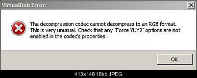

  22. Originally Posted by minimax View Post
    [Attachment 28293 - Click to enlarge]
    I don't know why, but when opening AVI files VirtualDub won't play YV12 video via the play input function. On the other hand, it has no problem playing YV12 from an AviSynth script. Since you previously limited Cedocida to YV12 output VirtualDub won't play the video when opening the AVI directly. If you open the video using an AviSynth script you should find that it plays.
    Now if you enable both YUY2 and YV12 output in Cedocida you can specify which you want when you open the video with AviSource() -- pixel_type="YUY2" or "YV12". And VirtualDub will probably negotiate YUY2 when you open the video directly.

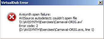

    I made the avs script as you advised:
    AVISource("D:\AVISYNTH\Exercises\Carnaval-ORIG.avi")
    Info()
    Trying to open it resulted in this message:
    Name:  Error ORIG-1.JPG
    What would you suggest I do?
  24. Are you sure the name is correct? Is there a space between Carnaval- Orig.avi ? It looks like that from the mediainfo report in post #48
    Carnaval- Orig.avi
    or
    Carnaval-Orig.avi

  26. Member
    Oct 2014
    The Netherlands
    You're absolutely right! Sorry, stupid mistake and I'm getting sleepy; it is 2:45 AM in this country...

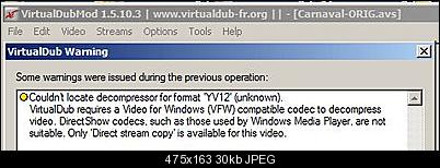

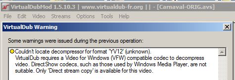

    However, it does not run in VDubMod, which returns this message:
Name:	ORIG-info VDubMod.JPG
    and it does not run in Media Player either, as it seems to be missing the relevant codec.
  27. I told you before that VirtualDubMod can't play YV12 video without an external YV12 decoder. Stop using that 10 year old piece of software. It only has one possible use these days -- muxing multiple audio tracks into an AVI file.
    If your really must, you can use ffdshow to decode YV12. It's under Codecs -> Raw Video

    Summarizing :
    VirtualDub
    1. Does play Carnaval-ORIG.avs without any problem.
    2. Does not play Carnaval-ORIG.avi when depressing 'Input Playback' and this message appears:

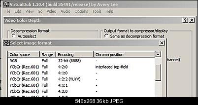

  29. Did you enable YUY2 output in Cedocida? Did you install ffdshow and enable the row video codec? If you've already enabled YUY2 outout in Cedocida, you can try forcing VirtualDub to ask Cedocida for YUY2 with Video -> Color Depth -> Decompression Format -> YY2:2 YCbCr YUY2.
    Windows Media Player is probably 64 bit and won't work with 32 bit AviSynth. Generally, you don't use media player to view scripts because the scripts are often too slow for real time playback.

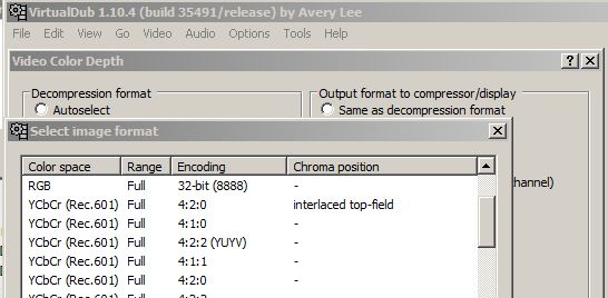

    The Netherlands
    Sorry jagabo, I'm trying to become familiar with codecs but I am not 'on the level' yet and step-by-step instructions would be much appreciated.
    1. Therefore: how should I go about enabling YUY2 in Cedocida?
    2. I did install ffdshow, but again, I have no idea as to how to work with the program or how to enable the row video codec.
    3. I looked into Video -> Color Depth -> Decompression Format -> YY2:2 YCbCr YUY2.
    In the list I could not find YY2:2 YCbCr YUY2 and this is part of what I see:
Name:	ask Ced forYUY2.JPG
