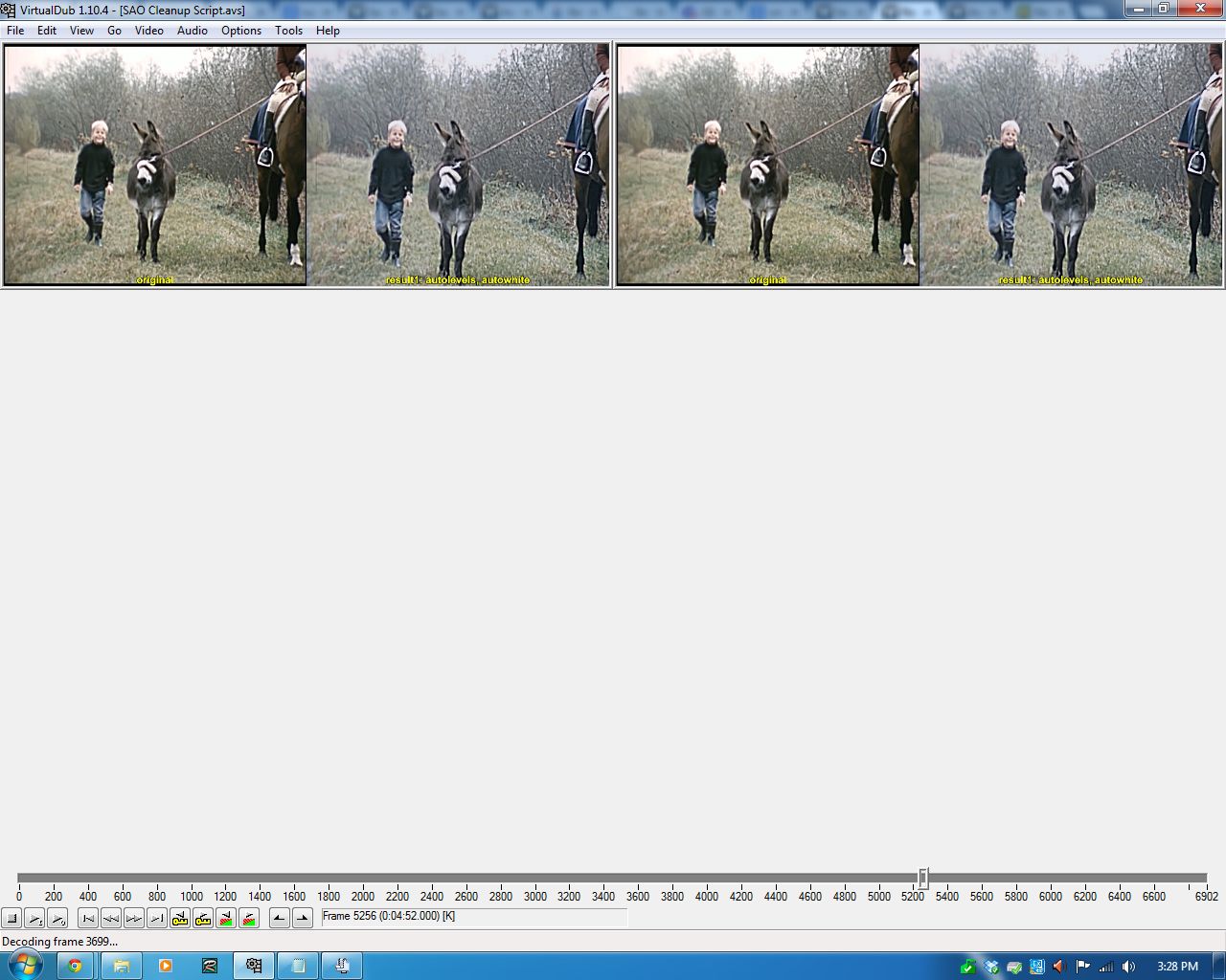

    I have a major project going transferring several hundred 400' reels of 8mm and Super 8mm film to digital. I've got the wonderful Retro-8 scanner from Roger Evans and the RetroScan HD software, and this does a great job of scanning the films. I export the scans as Image Sequences (jpg or png) and open these in VirtualDub. I then use Neat Video to Denoise the frames and am getting excellent results.
    My issue is that I would like to despot the sequences too. Being old and delicate I am reluctant to do much in the way of manual cleaning before scanning, and in any case much of the dirt cannot be removed this way having become well embedded over forty years. I have downloaded VideoFred's Film Restoring scripts and after much head scratching finally figured how to get VirtualDub to run them and again the results are good.
    What I can't do is figure out how to edit the scripts so as to remove the 'before and after' comparison built into them. Obviously my requirement is simply to process the sequence so as to finish up with a single, cleaned, full frame image with no text overlay. If I comment out what I think is the relevant section the script fails, either with a message advising the line, or it just fails completely.
    Can someone please advise me on how to do this? I'm really tearing my hair out over this, and I don't have much of it to spare. Many thanks.

  2. Look for a StackHorizontal() and remove it. Return only the "after" stream. Ie, look for something like:
    StackHorizontal(video1, video2)
    and change it to
    return(video2)
    You'll probably also want to remove the Subtitle() that labels the image.

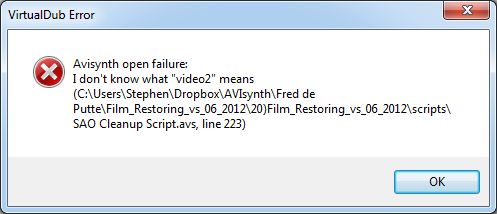

    Thanks for the quick response, at least it confirms I was working on the correct part of the script. There are in fact seven StackHorizontal entries which also contain the subtitle entry. I'm just not sure where to enter the new bit of code. Should I replace all the entries with just one instance of the new bit, or should I make seven entries?
    I did experiment a bit and tried it both ways. The script failed both times and gave the error message 'I don't know what Video2 is'. I've attached a grab of this and also the relevant section of the script. Thanks again.

  4. My use of "video1" and "video2" was symbolic, not literal. Ie, StackHorizontal() was stacking two videos side by side. One was the original (symbolicly video1), the other was a processed video (symbolicly video2). You need to return that second video, whatever it's named. That part of the script sets up several comparisons. But the names of the processed videos are result1, result2, result3, and result4. So put
    return(result1)
    just before that part of the code. Or result2, result3, or result4, whichever you want.

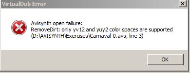

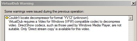

    Nevertheless, it does not work yet. This is the code I saved:
    LoadPlugin("C:\Program Files (x86)\AviSynth 2.5\plugins\RemoveDirt.dll")
    AVISource("D:\AVISYNTH\Exercises\Carnaval-0.avi")
    RemoveDirt()
    And this is the error message I got in return:
    It seems I am missing something and I shall be looking forward to your further advice.

  23. Originally Posted by minimax View Post
    [Attachment 28216 - Click to enlarge]
    So you are using a DV camcorder? And this is a DV AVI you are opening? PAL DV is natively YV12 so the decoder should be able to output YV12. There are some DV decoders that only output RGB, like Panasonic DV Codec, and those should be avoided. You want to use a DV decoder that can output YV12, like Cedocida.
    Instead of manono's suggestion to use ConvertToYV12() try changing the AviSource() line to
    AVISource("D:\AVISYNTH\Exercises\Carnaval-0.avi", pixel_type="YV12")
    Then see if the script works.
    You want to avoid conversion to RGB until you've verified that the YUV levels are legal. Otherwise super darks will be crushed and super brights will be blown out.

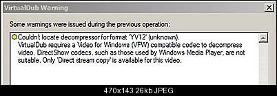

    caused this warning to appear in VDubMod:
    I assume the clip is not interlaced, so I left the relevant part out. Leaving it in results in the same warning. How can I make sure whether it is interlaced or not?
    Media Player could not handle it either and suggested that the required codec is not installed.
  25. Use VirtualDub instead of VirtualDubMod. It has internal support for YV12.
    Also, if your video is interlaced (and DV usually is) you may need some special handling to keep the two fields separate.

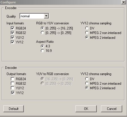

    Then I tried to find the Cedocida dialog box. I have seen it on the Cedocida site so I know what you mean, but I am unable to locate it on my computer. Where should I look?
  29. Originally Posted by minimax View Post
    Start VirtualDub, select Video -> Compression, highlight Cedocida, press the Configure button, select options...

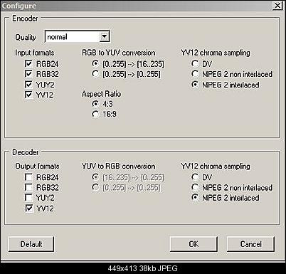

    Continuing my internet search I finally found the Configuration dialog box. Did not realize it is part of VDub!
    I changed the settings to those in te picture below. Are these correct?
    Since I am still getting the same error message:
    'only YV12 and YUY2 color spaces are supported'
