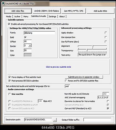

    only problem i got with this tool are subtitles
    i mean when i will add subtitle its ok when i am watching @ blu ray player but when i open with VLC subtitles are visible for 0.1 seconds and thats it
    txmuxer is ok but i want to use multiavc way better tool
    do i need to change anything or this is the way how its working?
