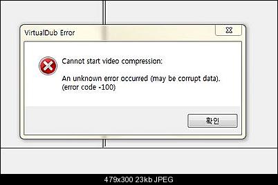

    I was trying to make a video, using virtual dub. I was trying to put the video and subtitle together using textsub plugin.
    I've done it many times without any problem but suddenly it does not work.
    When I try to "save as avi" this message pops up.
    Now, I searched for this error -100 and it says there must be a bad frame.
    But when I look at their error message, there's always certain frame number that is making problem.
    In my case there isn't any as you can see from the screen shot.
    I've searched here and went to "direct stream copy" and then "scan video stream for errors"
    There is no error.
    I've tried with many other videos just to make sure it was that video that had problem.
    But no other videos work, it all makes same pop up. There's no way all my video files has problem.
    Also I tried "save as avi" without compression - it works fine but files becomes massive.
    I tried with some other codec - it works fine but file becomes massive.
    The codec I need to use (and used to use without no problem until now) is Xvid MPGE-4 Codec.
    I really want to make this problem go away... Please help...

  6. maybe the resolution input
  7. Yes, make sure the resolution of your filtered video is a valid size for the codec you're using. For example, Xvid requires at at least mod 2 (integer multiples of 2) frame sizes, and at least a mod 4 frame height if encoding interlaced.
    Make sure the colorspace after filtering is acceptable for the codec. You can use Video -> Color Depth to force an output colorspace.

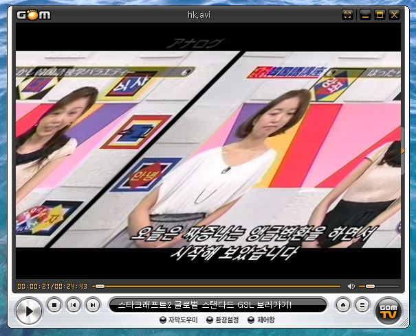

    I ended up downloading this "star codec" program. It comes with many other codecs I can use. I officially gave up on Xvid and tried this "Divx MPEG-4 Fast Motion". It worked, file size is even better than Xvid but it gave me this horrible distortion.
    I mean... WTF?
    I am so sorry that I can't even understand your help... I thought I found solution using other codec... What happened to my Virtualdub... Is he crazy...
  9. Change to mod 4 frame sizes. Ie, resize, crop, or add borders to bring the frame width and height to an integer multiple of 4. For example, 640 is an integer multiple of 4 (160 * 4), 642 is not.
