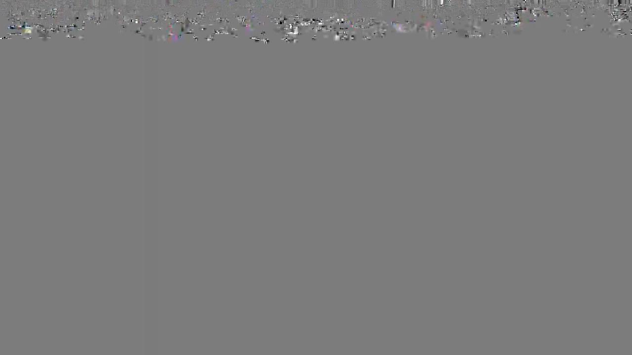

    Hey guys,
    The video is in MP4 and I just want it to be concatenate without reencoding. It was actually fine after joined but when I played it and drag it around, the video will be grey-like. The audio is fine. The only problem is the video playback after joined it.
    I've tried avidemux, ffmpeg, mp4joiner, yamb and all of them gave me the same result.
    Thanks for your concern.

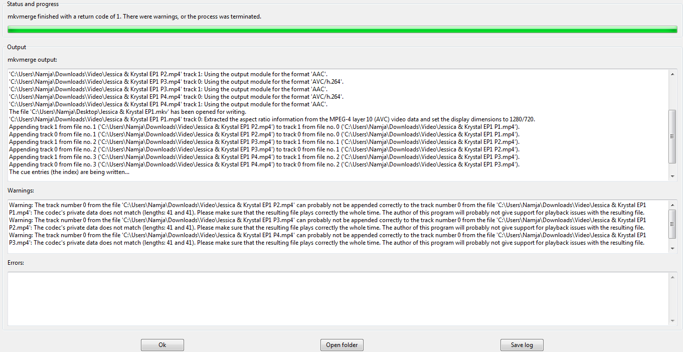

    @hello_hello: There are warning given after I mux it.
    https://forum.videohelp.com/images/imgfiles/4xHXMkA.png
    I have also tried extract .h264 and .aac using mkvextract and then remux it with mkvmerge.
    No error or warning given but the video still choppy.

  7. For the record, I'm pretty sure the problem relates to this x264 option (given the warning MKVMergeGUI offered). https://mailman.videolan.org/pipermail/x264-devel/2013-July/010167.html
    Unless the video was encoded in one go, then split, in which case it probably wouldn't apply. I think changes were made to the encoder which effected the ability to append files and the stitchable option was added a little later to fix that...... so you could originally append encodes, then not so much for a few x264 versions, then you could again.
    I'd be interested to learn how VideoReDo appends the video without it resulting in the same playback issue, assuming I'm on the right track regarding the cause. Anyone know??
