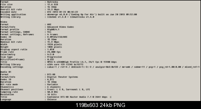

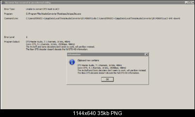

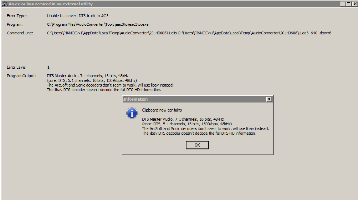

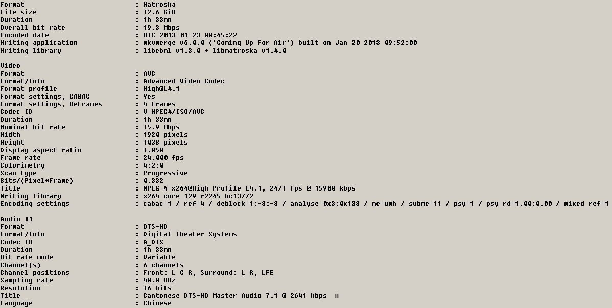

  1. Hi there.
    Thank you in advance.

    I was waiting to see if anybody else had a better idea, but since nobody does, you could use something like eac3to. If it can't convert to AC3 for you from DTS-HD 7.1 then try to extract the 5.1 DTS core which is referenced above. Most likely once you have the core file you can then convert that to AC3 without problems, using the PopCorn program above. I've never used that PopCorn program so I'm guessing, but it definitely seems to be having a problem with the 7.1 part of it, the DTS-HD part of it, or both.
    Sep 2012
    Australia
    It kind of looks like he doesn't have the Arcsoft DTS encoder installed.
    (if you read it, his program IS using EAC3To, so it really should be working...)

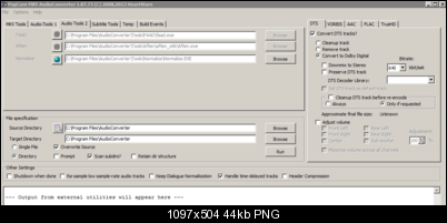

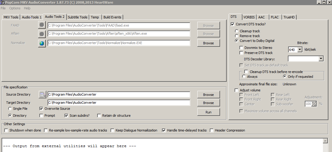

    Aften can be found at the right directory, but I am wondering, why it is not used by Popcorn.
    I can't "browse" it via Popcorn as you can see at the picture.
    Any ideas?
    Thank you.
    Sep 2012
    Australia
    I don't think Aften can decode DTS-MA, I think what you got was the core converted to AC3. Download RipBot and run it once, that should install the ArcSoft DTS decoder. After that try popcorn again. If that doesn't work then there's definitely something wrong.
