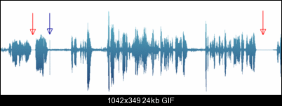

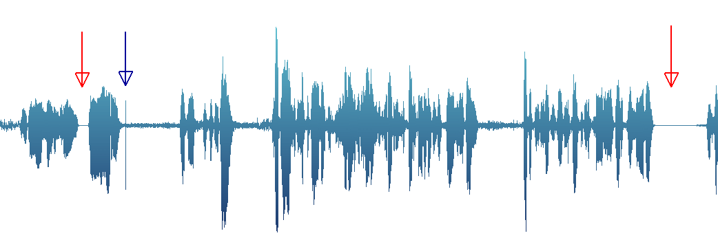

  17. If it was me..... maybe for a lack of a better place to start..... I'd disable overclocking completely, run the motherboard as close to the BIOS defaults as possible (even check for a newer BIOS version), and I'd unplug any hardware not required at the time..... just to see what happens. It sounds like it might be a hardware glitch to me. Or the soundcard is momentarily too busy, or something like that.....
    Have you noticed (unless it's just the way the Youtube audio was re-encoded) the audio drops out completely every so often in addition to the unwanted pops and clicks? The blue arrow is the glitch at 1 minute 9 seconds, the red arrows are two places where the audio isn't. Should that be happening?
  18. Member
    Nov 2013
    Australia
    [Attachment 25627 - Click to enlarge]
    Ok my bios issue is a whole other ballgame, my machine wont power off after installing the latest bios issue which is really unfortunate as my machine is super stable, now in terms of a buffer etc, I am assuming there is some sort of buffer for Audio, again I don't know where to start here but is there an audio buffer that I can increase??
    I am guessing that it would be at youtubes reencoding that would cause the silent bnits, I mean I upload to youtube with the AVC H264 encoded videos at 7000 kbps bitrate, they are very high quality in terms of overall quality and size and I use youtubes exact best practice methods of uploading etc.
    The audio where its flat is definitely a mystery, I mean I do not change any settings or normalization or anything else, the audio is recorded at the very same level every time, and if its not my commentary its the game audio playing in the game all the time, it would have to be a dead spot in the game etc, so can anyone jump in here and advise is this a buffer thing etc, where and how can I increase my buffer etc to give the audio a greater buffer etc to do its thing??
    Thanks all for your help
