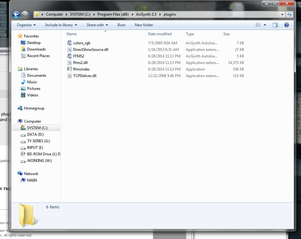

  19. Banned
    Feb 2013
    Here is my plugin folder
    Do any of these look problematic.
    Question --- could BD_RB have anything to do with this since it seems to have some plugins in its folder.
    This might get straightened out next time I re-install windows
  20. Put ffms2.dll in a subfolder, so it's not directly at the level of the plugins folders
    Open ffms2.avsi, edit the path for LoadCPlugin (it should be the 3rd line), to where the new path of ffms2.dll is, save it
    I don't know if this is the same thing, but something similar happened to me on one of my computers where only some programs crashed when initializing avisynth upon opening an .avs script. I traced it to certain versions of ffms2 plugins, and that workaround fixed it. I don't know why or what specific conditions caused it, I couldn't isolate why it only occurred on that computer only
  21. Banned
    Feb 2013
    Yay!!! It worked
    Thanks poisondeathray
