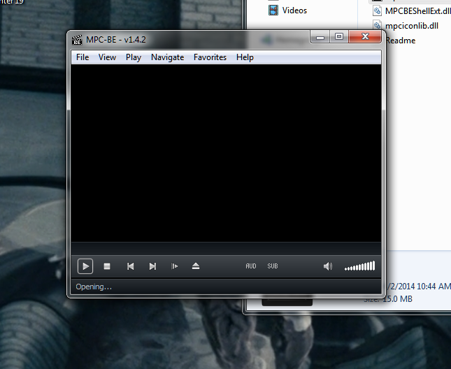

    Used Hybrid's AviSynth script, and MPC hangs on opening it

  27. You have to wait a bit, when you open that script the first time, since the content first needs to be indexed.
    Enable 'Filtering->Avisynth->Misc->LibavVideoSource instead of FFmpegSource' and then use that script.
