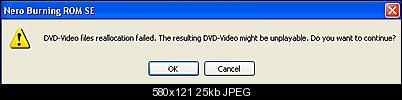

    A new error I haven't seen before. Someone uploaded the files from a DVD to Dropbox. When I go to burn in Nero 5 I get this error which I've never seen before.

    I also get another "may not play" error further on in the process. Burned it to a DVD rewritable seems to play okay.
    Insight?
    Thanks.
  2. Member Cornucopia's Avatar
    Hard to say.
    Try, NOT using Nero. ImgBurn would be preferable. What does IT tell you?
    Make sure you've fully & correctly downloaded them from DropBox.
    Make sure you've got plenty of temp space on your HDDs.
  3. Banned
