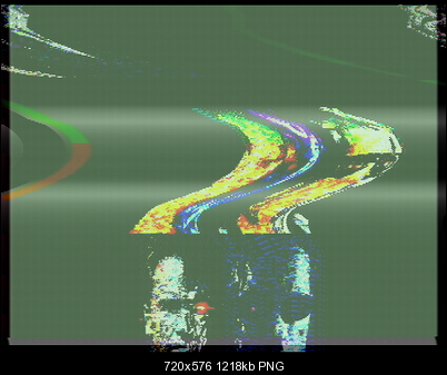

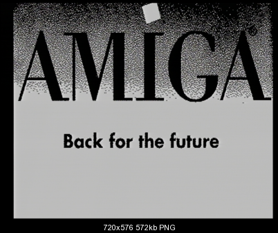

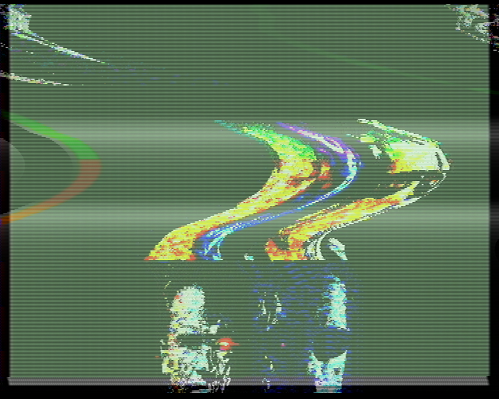

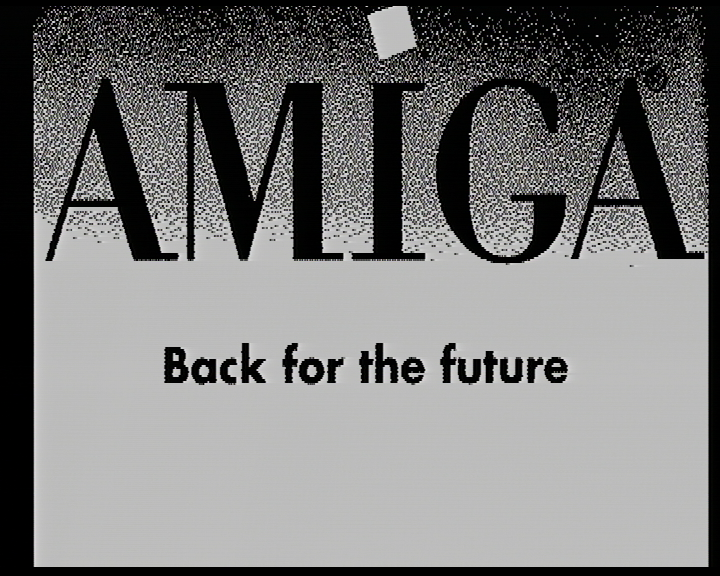

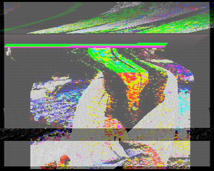

    Now I have for example two pictures:
    So, These modes AmaRecTV cannot proceed.
    Miro
    Dec 2005
    Finland
    Which outputs exactly are you trying to capture? The regular video output is fairly normal composite/s-video and should be easy to capture. The other output the C128 has is an RGBI port, which needs a different type of capture setup. I think that port also includes a secondary composite output, but it would be monochrome, and your captures are clearly in colour.
    In any case there are very few pieces of software that use the RGBI output; it's mainly used if you run CP/M instead of the Commodore DOS.
    Even if you don't consider the interlacing, your examples are quite distorted, so I don't think your capture device is syncing to the signal properly. NTSC/PAL problem perhaps?

    I tested mode 800×300 non-interlaced - look at picture - works also when is resolution of capturing 720×576...
