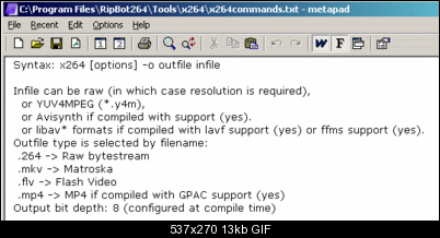

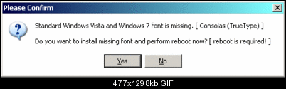

  25. Well..... at least I tried....
    Maybe one day in the future I'll be bored, the PC won't be in the middle of doing something, and I'll be happy to let Ripbot264 reboot it. Or I might just wait until I finish building the new PC and I'm running Win7.
    Edit: I found the missing font in the RipBot folder, installed it manually and now RipBot is running, no reboot required.

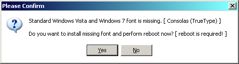

  27. Originally Posted by hello_hello View Post
    [Attachment 26525 - Click to enlarge]
    I thought this warning box was an error on my Win 7. {
  28. I haven't kept up, but I think Microsoft has changed the way Windows displays fonts once or twice. Being a CRT user like me you're probably oblivious to it, as text displays fine and doesn't require something like Cleartype to make it semi-readable.
    I'm not 100% sure, but I think Cleartype is on the way out and there's a different font rendering method now, and maybe it requires special fonts to work correctly. I don't know.... maybe someone else does.
    As an experiment though, I used the Win7 font in question (consola.ttf) to display some text with MetaPad and compared it to good old Verdana, no Cleartype to make it look like crap. Hopefully a pic will work to show the difference, but the Win7 font looks like some sort of psuedo-cleartype thing, and my guess is Ripbot uses it to make text readable no matter which version of Windows you're running with an LCD display. But..... if you still use a CRT you get crappy looking text like everyone else. Or maybe I'm completely wrong......
    Verdana:
    Consola:
