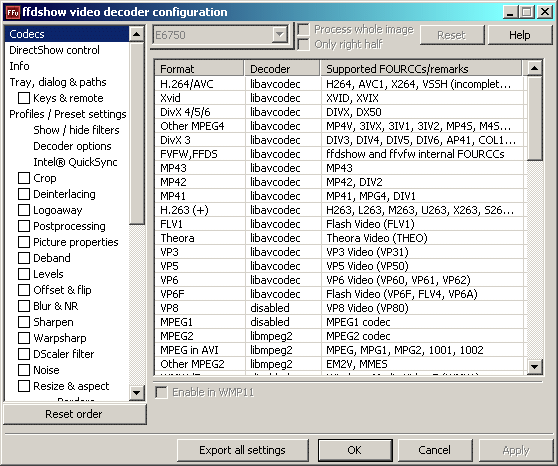

  10. ffdshow can decode all the common formats. If a codec isn't enabled by default and you need it, you can always enable it. You can install ffdshow anywhere.

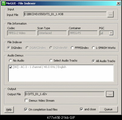

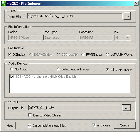

    First you need to rip your DVD and prepare it for encoding just as you would when using AutoGK. You need a single set of sequentially numbered vob files for a movie or per episode etc. Use MeGUI's File/Open menu to open the first vob file in a set (instead of opening the corresponding ifo file as you can with AutoGK). The rest of the vob files in the set will be automatically included.
    When you open the vob file MeGUI should offer to index it with DGIndex and it'll provide a list of audio tracks so you can choose which ones to extract, or extract them all etc. You can specify where to save the output files if you want to change that and/or rename the index file etc (the extracted audio will be named accordingly). Add the indexing job to the queue by clicking on the queue button, switch to the queue tab in MeGUI's main window and run the indexing job.
    When it's finished the selected audio stream(s) will have been extracted to the specified location and they should be automatically loaded into MeGUI's audio section for encoding. The script creator should also open with a preview for creating a script for the video encoding but forgetting the video side for the moment.... you can just leave the script creator open or close it.

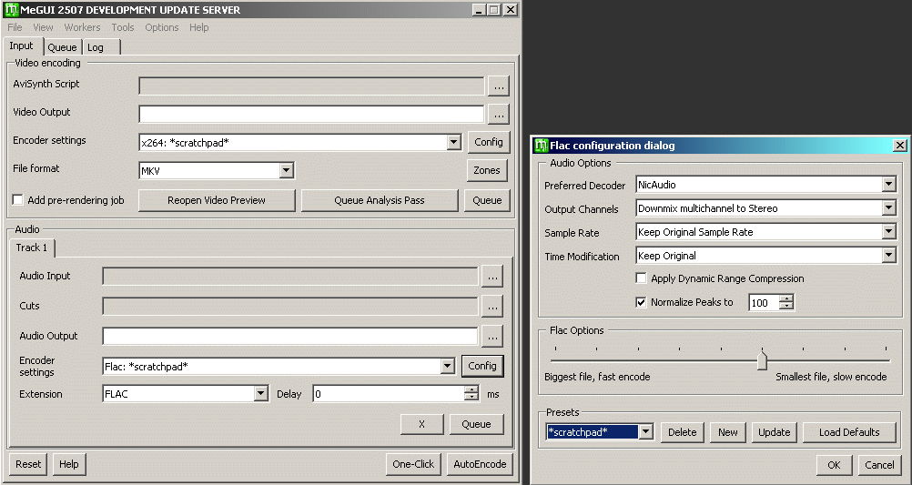

    Select "Flac: scratchpad" from the dropdown list in the audio section, click on the Config button, load the defaults, select "downmix to stereo" (if required) and check "normalise peaks". Save that as a Flac preset if you like and close the encoder configuration. Click on the queue button in the audio section, switch to the queue tab and run the job. When it's finished you should have a normalised stereo flac file you can load into Goldwave, process as you normally would, export as wave and finally load into Levelator.
    Once you've finished processing the audio with Levelator you can load it's output wave file into MeGUI's audio section and convert it to whichever format your heart desires (well..... most of the common ones.... MP3, AAC AC3 etc). You'd do it the same way as you converted the extracted DVD audio except there'd be no need to select the downmix to stereo or normalise options when configuring the audio encoder.
    Once you've done all that you'd move onto the video encoding job, and you get MeGUI to automatically output an MKV containing the encoded video and re-encoded Levelated audio etc, but maybe have a play around with the audio first and that can be the subject of a future post.

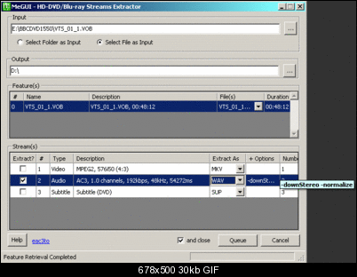

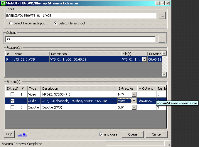

    Under MeGUI's Tools menu, open the HD Streams Extractor (it's a GUI for eac3to which comes as a standalone program and is also built into MeGUI).
    Select "file as input" and open the vob file. It'll take a little bit for the HD Streams Extractor to do it's thing, then a list of streams will appear. De-select everything but the audio streams you want to use. Next to the audio stream(s), choose "wav" for the output. The Options box needs to be used to tell eac3to to downmix to stereo and normalise. For future reference, here's the full list of eac3to commandline options:
    http://en.wikibooks.org/wiki/Eac3to/How_to_Use#Command_Line_Syntax
    In order to get eac3to to downmix and normalise, you need to add the following (without the quotes): "-downStereo -normalize"
    Click on the queue button, switch to MeGUI's queue tab, run the job and when it's done you should have a downmixed to stereo, normalised wave file you can load into Goldwave and/or Levelator etc.

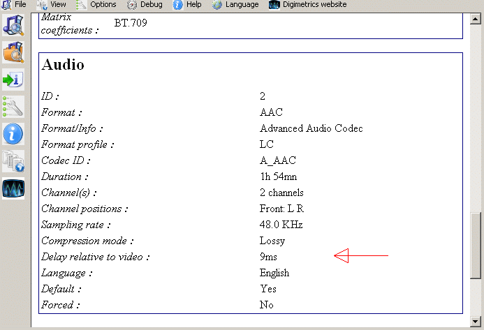

  20. MKVCleaver and gMKVExtractGUI both work fine. MKVCkeaver will batch extract. gMKVExtractGUI won't. gMKVExtractGUI checks for any audio delay and writes it to the file name when extracting (as DGIndex does when extracting DVD audio). MKVCleaver doesn't. If you want to be sure you remux with a correct delay when using MKVCleaver you need to check for any audio delay manually with MediaInfo. If there is one, it'll be listed as "delay relative to video" in the audio section (you need to use HTML or Text view with MediaInfo to see it). If there's no delay, nothing will be shown.
    Edit: If you use MeGUI's file indexer to extract the audio it'll also write any audio delay in the original MKV to the file name of the extracted audio.

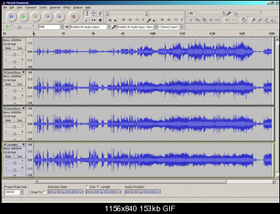

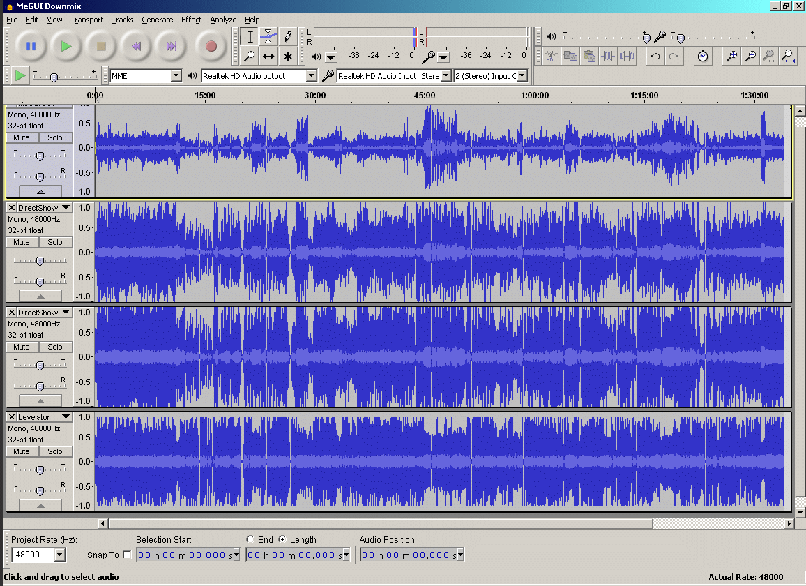

    Did you have to go and say that, because it meant I had to try it out and I really should have been doing other things....
    First a movie soundtrack downmixed to stereo and normalised using MeGUI. It was original dts audio remuxed as an MKA (so I could easily open it via DirectShow).
    Number 2 is the same audio downmixed and compressed via DirectShow. ffdshow doing the decoding and downmixing etc and the RockSteady plugin doing the compressing. They're the same settings I use on playback minus the centre channel boost.
    Number 3 is the same as number 2 but with the compressor plugin cranked up a little bit.
    Number 4 is the audio after it was downmixed and normalised in the usual way via MeGUI, then run through Levelator.
    Each downmix was stereo, but for the benefit of a smaller screenshot after loading them into Audacity, in each case I split the stereo channels to dual mono and deleted the right channel.
    Is Levelator normally slow? Compressing the audio with the WinAmp plugin while converting doesn't seem to slow the process down at all but it seemed to take Levelator a fair while to level the wave file. When a say slow..... I didn't actually time it. A couple of minutes maybe? And it seemed to progress in stages. It'd sit on a certain percentage for a while then suddenly jump a few percent etc. Is that normal?
    I'll have to listen to them properly later as what they sound like is what's important, but it's interesting to see where there's a quiet part, Levelator seemed to increase the volume more than the compressor plugin (around the 15 minute point) but where the audio was louder (just after the 45 minute point) Levelator seemed to reduce it a bit relative to everything else. I did have a quick listen to that section. It's full of gunshots and the difference between the compressor and Levelator is obvious. I won't pass judgement yet till I've come back for another listen later. I might even upload a few little samples when I do.

  24. So..... 2 minutes of audio. I converted the entire soundtrack each time and cut out a 2 minute section to use as a sample.
    1: Normal stereo mixdown.
    2: DirectShow conversion with mixdown and compression
    3: DirectShow conversion with mixdown, centre channel boosted by 75% and compression (it's how I normally do it and I wanted to see if that makes me silly..... the centre channel boost doesn't seem to make much difference).
    4: Normal stereo mixdown run through Levelator.
    It's the same section of audio each time...... speech with a little background noise followed by some action with gunshots etc.
    I couldn't decide how to make comparing them as fair as possible, but in the end I ran ReplayGain on each sample and re-encoded them to the same volume according to ReplayGain. The standard downmix version still sounds a lot quieter at the beginning but that's to be expected as it's not compressed. I kept them in a lossless format right up to the final conversion to AAC..... which I did to make the file sizes smaller for uploading, and lossy compression doesn't matter for the sake of the exercise. Same VBR quality setting each time.
    Listening to the samples, I don't like Levelator. It "compresses" quite a bit, which is a good thing, but it either compresses too much for me or it's not doing a particularly good job (although in fairness, this sort of thing isn't what it's designed for). Just listening to the first 5 seconds or so put me off Levelator..... the way the volume of the background music goes up and down. That sort of thing would drive me nuts. I much prefer the RockSteady compression I normally use on playback (sample 3). Plus it's much faster if you want to compress when you encode as you can compress, downmix and encode in a single operation.
    Anyway.... have a listen to the samples and let me know what you think. I've posted a link to this post in an "audio compression" thread, so if you want to continue discussing that topic, maybe we can do it there, so as not to take this thread in too many different directions.
    https://forum.videohelp.com/threads/364801-Any-VST-plugin-%28or-%29-to-automatically-an...-dynamic-range
  25. For the sake of completeness, here's what the samples in the post above look like. It's not overly informative though. The picture being worth a thousand words adage/proverb/thingy..... this one's possibly an exception (once again it's only the left channel each time).

    Did you listen to the samples? You don't have to agree with me, I'm just curious what you think.
    Levelator was no doubt designed to compress, and/or to increase the volume of the quiet bits, which isn't exactly what a compressor does, and it probably doesn't work the same way as the RockSteady DSP, but the end result should be the same as compressing and normalising. Obviously Levelator wasn't designed to do what you're using it for (it's intended to level the volume of speech alone), but that doesn't mean it can't level out a movie soundtrack. It can. The question for me would be does it do it the best possible way and for me the answer seems to be no.
    The thing I dislike (judging from a single encode) is hearing the volume of background sounds go up and down. Or the volume of speech go up and down (which seems to happen a bit with Levelator) although it's not something unusual as such, it's a standard side effect of compression. The more you compress, the more you risk "pumping" of the volume. My TV has a few different "night modes". The one which compresses the most results in "pumping" sometimes, but it's not bad and apparently I'm the only one who notices.
    I actually fiddled with the RockStready plugin a fair bit, and the way I run it seems to be around the maximum compression possible without any audible "pumping"..... 99% of the time. At least that's the best I could come up with. Very occasionally there'll be background music which is quite loud (or has lots of low frequencies) and if there's speech over it I can hear the volume of the speech drop a little sometimes, but it's nothing drastic and doesn't seem to happen often.
    When I downmixed the audio and converted it to flac with MeGUI I enabled normalising in the encoder configuration, so the audio should be the same as if AutoGK made it (well I didn't downmix to Proglogic). I converted the flac to wave to load into Levelator.
    Converting to AAC via DirectShow and the RockSteady plugin doesn't involve much work at all for me. If I hadn't needed to load the audio into Levelator or Audacity I would have converted the DTS directly to AAC. I already have ffdshow and RockSteady configured, so it's simply be a matter of selecting the AAC encoder in MeGUI and setting it to decode via DirectShow. Job done. Having to convert to Flac so I could convert to wave (I did that with foobar2000) so I could load the audio into Levelator and then convert it's output to AAC was a bit more work.
    MKVMergeGUI will open MP4s (and M4A's and M4Vs and AVI and VOB files and probably a few other formats I can't think of right now), so you could have opened the MP4 Handbrake produced with MKVMergeGUI, added the audio and saved them both as MKV. I mentioned that at the end of post #20, but it's a long thread so I won't be upset if you missed it.
    For MKVCleaver there's a "locate MKVToolnix" button at the top right corner of the GUI.
    AAC is fairly common in MKV/MP4 files these days. It's the successor to MP3, although MP3 doesn't seem to be in a hurry to go away (I still use it myself). It supports multi-channel audio so if you want stereo make sure to configure the AAC encoder to downmix to stereo. If you give the LAME encoder multi-channel audio it refuses to encode so it's an effective reminder to downmix.
    AAC is an elementary stream (I think), not a container as such. Just as an AVC video file would be if you extracted the video from and MKV. They need to be in a container most of the time (M4A, MP4, MKV etc) so generally AAC encoders output M4A or MP4 instead of AAC by default. You can open the M4A file with MKVMergeGUI.
    If you need it to, MeGUI will convert wave files (it just won't output wave files). You can manually load a wave file into the audio section and choose/configure your desired encoder. If you want AAC you need to put the NeroAAC encoder in the MeGUI/tools/eac3to folder and enable it in MeGUI's settings if you haven't done so yet (under the external program configuration tab). The output will be either MP4 or M4A (whichever you select) but the actual audio will be AAC.
    MeGUI has a few different muxers under the Tools menu. The MKV muxer uses MKVToolNix to do the work. I use MKVMergeGUI instead of MeGUI's muxer because it's got more options and I can stick a shortcut to it in the Windows Sendto menu.
    MeGUI will also do the muxing for you once it's finished encoding but there's a few different ways to do it, so I'll leave that for another day.

    MeGUI requires the Haali Media Splitter in order to decode some file types using some methods. I can't remember which ones exactly.... MKV via DirectShow might be an example.... so it's a good idea to install it. You need to manually add the NeroAAC encoder to the MeGUI/tools/eac3to folder but I think that's it. MeGUI should download anything else it needs for you..
    If you still have the older version of Avisynth installed (2.5.8 which came with AutoGK) I'd consider upgrading it to version 2.6.0.4). MeGUI supplies it's own portable version of Avisynth (Avisynth+ 2.6.0.5) but it'll use the "installed" Avisynth if you tell it to. The portable version is fine but if the installed version is the old 2.5.8 you might have problems opening the scripts MeGUI creates with a different program such as MPC-HC because some of the Avisynth plugins have changed. And being able to save a script and then open it using MPC-HC is nice and handy. I do it a lot so I can preview the script running fullsreen on my TV as I normally would. MeGUI's preview works fine but it doesn't have a full screen mode. Anyway.... if you're running Avisynth 2.5.8 upgrade it to 2.6.0.4. AutoGK won't mind.
    ffdshow pretty much just works in the background when needed. It decodes audio/video via DirectShow. It'll only decode when a DirectShow player is used and you specifically tell it to use ffdshow (MPC-HC for example), or when you tell MeGUI's audio encoder to decode via DirectShow. That sort of thing.....
