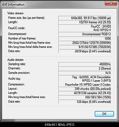

  1. I have done some searching and found others with this issue but I haven't been able to resolve mine yet. Basically at the beginning of the video everything is in synch. The farther into the movie the more out of synch things get. I have used mediainfo to compare time lengths and it shows them as the same. The output of that is below.
    I'm fairly a newbie when it comes to video stuff. I have tried avidemux 2.6 although I don't know really how to use that program. The few options I tried didn't work. I tried Frame Rate Changer 2009 without luck. The only field I changed in it was the scale. No luck with it. I tried YAAI which seems to get me the closest but still not good enough. I changed the stretch video setting as far as it would go to the longer setting, but it seems it just needs to go a little farther. FPS shows 49.9168 and stretch factor 83.3102.
    This is only happening with xvid avi files. MKV, MP4, WMV, MOV etc all seem fine. I have tried on two different computers using MPC-HC. My media PC runs Media Browser and that shows the same issues.
    I tried another xvid avi file and it plays fine, main difference is it has a FPS of 23.976.
    Any help in figuring this out greatly appreciated.

    MediaInfo doesn't actually know how long each stream is so it just prints out the play length of the file as a whole for each stream. The same thing happens with MKV's... if only someone could figure out a way to fix that...
    You may have to extract each stream into it's own container to check if there is a difference between lengths, that should give us some idea of what to do next.
  3. What can I use to do that? I did look at dgindex, but that didn't seem to work. I tried dgavcdec and dgmpgdec. I think the AVC one is the wrong one for this file type. dgmpg did extract several files, mp1 2 or 3 I think but none of them would play so not sure if I did it right.

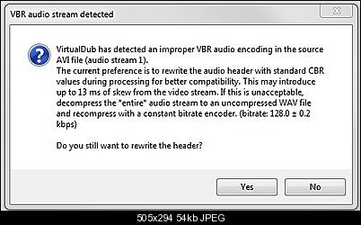

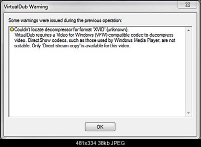

  5. ok some searching says to use virtualdubmod. I grabbed it and got the following prompts which I clicked Yes and Ok. Looks like maybe I need a codec. I have heard bad stories of installing some of these. Would this one be ok? http://www.free-codecs.com/download/xvid_codec.htm
ID:	25525Click image for larger version
    Sep 2012
    Australia
    I guess you could try a direct stream copy using VirtualDub. Ignore all the errors and just do it, as long as it doesn't change the original file there's no harm done.

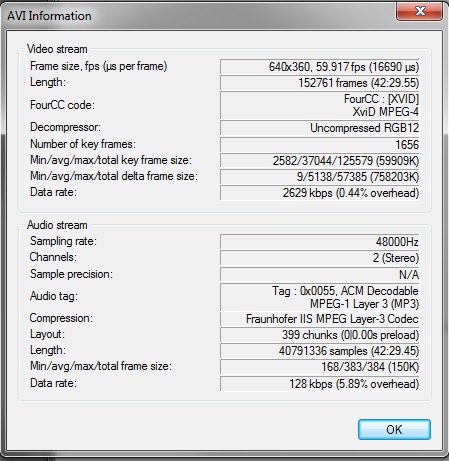

  11. Ok, I was wrong on the video length, it is 43:57. Also the FPS is different on original which it now shows. See mediainfo below. Audio is ahead of video. I haven't tried using 60fps or remux into mkv. I haven't installed any codecs, just windows 7 pro and whatever is comes with.

  12. remux into mkv and no luck, still off. Tried using 60fps and it put everything off from beginning to end.
    So I have a video file that is 43:57 and an audio that is 42.29. They start off fine together, but get more out of synch as the show goes on. How do I get them aligned?

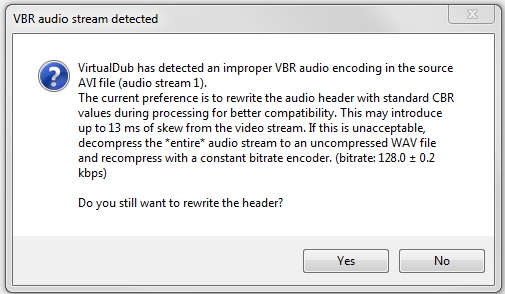

  13. Why don't you try what the Virtualdub error says? Make a CBR copy of the audio track. Also, it looks like your video frame rate is going into some screwy territory on your later attempts.

    I did I thought, I clicked yes to the prompt to rewrite the headers in post #5.

    You'll be sorry. That's a recipe for out-of-synch audio. hello_hello is asking the right questions and giving the best advice.

    Original file with vbr audio, untampered should only need what vdub vbr detection error said to do about extracting the audio as raw ... don't change compressors or anything else ... just raw extract (pcm) the audio.
    Simply replace the original audio back in vdub, set video to direct stream copy and audio compressor type needed ... thou in general 44.100 khz audio is used for cross hardware compatibility, not 48.000 khz.
    And let it rip ... this has solved 99% of files having vbr audio in my collection over the years.
