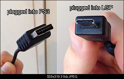

    Maybe the "monitor out" is not a direct passthrough and has some level of signal processing in-line, which would result in the delay I'm noticing. So I thought I could split the signal before the LGP and take one side directly to my display and the other side to the LGP. The only problem is how to split the signal. Because of the ps3's HDCP, I can only connect it to the LGP via an A/V cable (photo) that came included.
    1) Are there any splitters that I can use with said cable?
    2) According to this video (http://www.youtube.com/watch?v=wWPTWjUJAzY), the splitter (a Sewell) can bypass the HDCP. Is this true? Can I use any splitter or should I be looking for a specific type/brand?
