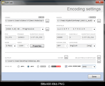

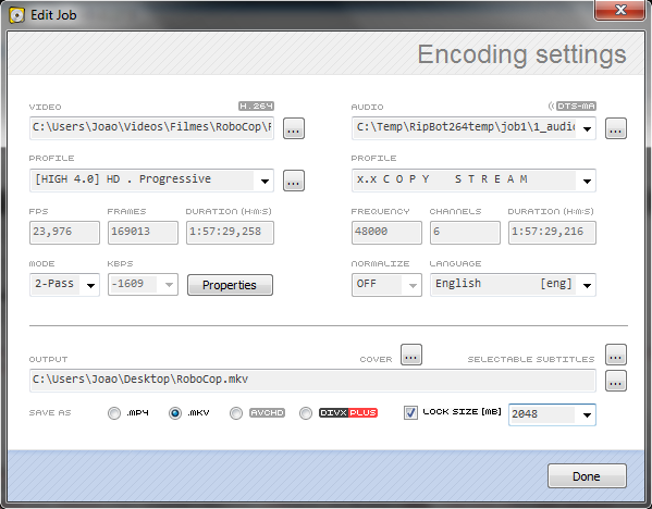

    I put 2048 under "Lock size" and "kbps" automatically go to a negative number. I just ignored that and tried to do the conversion, but I get a conversion time of 14 seconds and no final results.
    Print screen project:
Name:	Sem tÃ*tulo.png
    Log:
    C:\>"C:\Program Files (x86)\RipBot264_1.17.5\tools\avs2yuv\avs2yuv.exe" "C:\Temp\RipBot264temp\job1\job1.avs" -o - | "C:\Program Files (x86)\RipBot264_1.17.5\tools\x264\x264_x64.exe" --pass 1 --bitrate -1609 --stats "C:\Temp\RipBot264temp\job1\job1.stats" --fps 24000/1001 --force-cfr --min-keyint 24 --keyint 240 --frames 169012 --sar 1:1 --level 4.0 --aud --nal-hrd vbr --vbv-bufsize 25000 --vbv-maxrate 25000 --b-pyramid none --stdin y4m --output NUL -
    y4m [info]: 1920x800p 1:1 @ 10000000/417083 fps (cfr)
    x264 [error]: bitrate not specified
    x264 [error]: x264_encoder_open failed
    C:\Temp\RipBot264temp\job1\job1.avs: 1920x800, 10000000/417083 fps, 169012 frames
    error: wrote only 2285802 of 2304000 bytes
    C:\>"C:\Program Files (x86)\RipBot264_1.17.5\tools\avs2yuv\avs2yuv.exe" "C:\Temp\RipBot264temp\job1\job1.avs" -o - | "C:\Program Files (x86)\RipBot264_1.17.5\tools\x264\x264_x64.exe" --pass 2 --bitrate -1609 --stats "C:\Temp\RipBot264temp\job1\job1.stats" --fps 24000/1001 --force-cfr --min-keyint 24 --keyint 240 --frames 169012 --sar 1:1 --level 4.0 --aud --nal-hrd vbr --vbv-bufsize 25000 --vbv-maxrate 25000 --b-pyramid none --stdin y4m --output "C:\Temp\RipBot264temp\video.264" -
    C:\>"C:\Program Files (x86)\RipBot264_1.17.5\tools\mkvtoolnix\mkvmerge.exe" -o "C:\Users\Joao\Desktop\RoboCop.mkv" --compression 0:none --title "RoboCop" --default-duration 0:24000/1001fps "C:\Temp\RipBot264temp\video.264" --compression 0:none --language 0:eng --sync 0:0 "C:\Temp\RipBot264temp\job1\1_audio_English.dt s"
    mkvmerge v6.6.0 ('The Edge Of The In Between') built on Dec 1 2013 17:55:00
    Error: The file 'C:\Temp\RipBot264temp\video.264' has unknown type. Please have a look at the supported file types ('mkvmerge --list-types') and contact the author Moritz Bunkus <moritz@bunkus.org> if your file type is supported but not recognized properly.
    Elapsed Time: 00h:00m:14s
    Please help! Thanks

    I want my film to stay with 2 gb, so I put in "lock size" 2048 mb. Ok, but when I start convert, I get this log and no results. What I think may be it is the value of "kbps" be negative, but I don't know why this happens. Is there a minimum amount that I can put in "lock size"?
    Try and see if it's the audio that causes it. Try change it from copy to some other audio codec.
    Or else might Ripbot264 calculate the average bitrate incorrect. You can then adjust the video bitrate manually with help of a bitrate calculator ...if you just know the bitrate for the dts audio track.
    Nov 2013
    São Paulo - Campinas
    Hey Baldrick, THANKS!
    It seems that the change of the audio profile worked for me, the number in "kbps" was positive, about 2000. Moved to the "5.1 FHG AAC-LC 320 kbps [abr]" profile. Now I'm converting the movie, let's see if it will work ...
    Now just wanted to understand why this worked, it would be because of the giant size of the type of DTS format I was trying to copy?

    You told it you wanted 2048kbps total, but the DTS-MA audio was already more than that. If you take the DTS-MA bit rate away from the 2048kbps then the video has to be encoded at -1609kbps to make up the difference... Now THAT"S compression!
