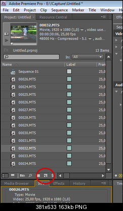

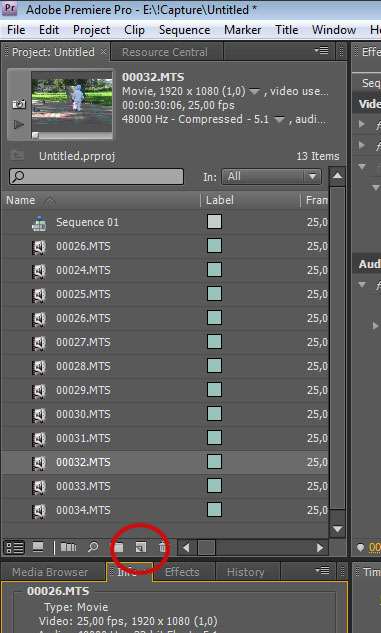

  2. I'm on CC, but all indications are you CAN create a new sequence by dropping a source clip on the icon in CS4. If that doesn't work, any 1080p30 sequence will be fine.
