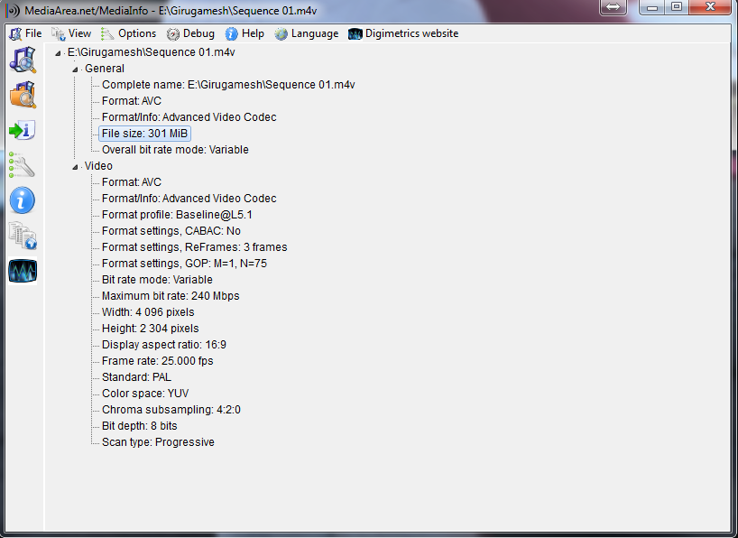

  2. Just noticed now that even when thou I always choose the output to be .mp4 it outputs .m4v. So I'm guessing like always the problem is apples shitty software that I installed due to a req in after effects?
Name:	Brez naslova.png
  3. No its unfinished render of Premiere
    Premiere when its render create .aac(audio) and m4v(video) and final stage mix to MP4
    Did bad encode happens with any sequence?
    Try encode for test bars and tone on new sequence

  7. m4v from Adobe is actually elementary video (no container) . Not very many players or applications can handle it.
    Perhaps your other computer has something installed to play elementary streams
    Either mux into container, or change your export settings
    And as smrpix said 4096x2304 is going to be difficult to play back smoothly on many systems

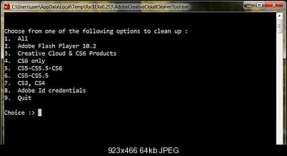

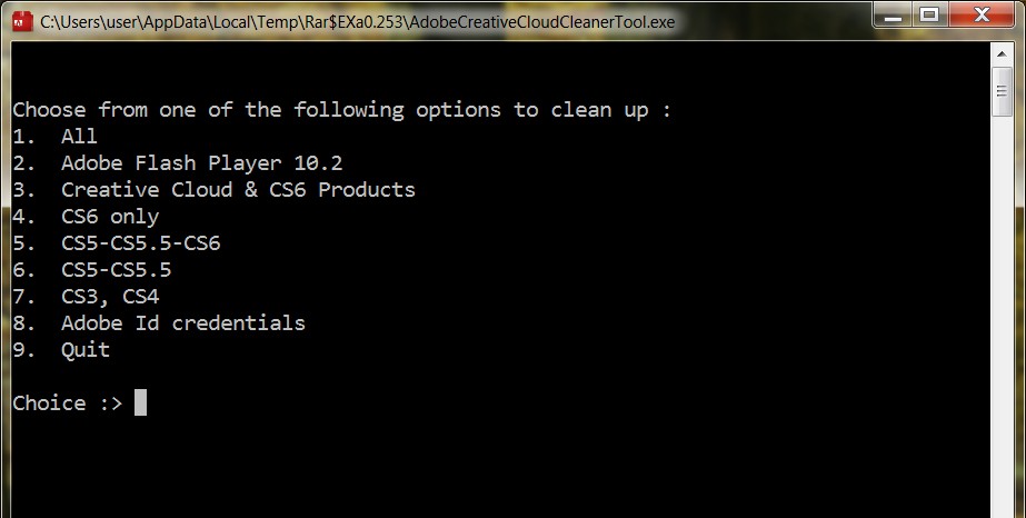

  11. Also you need run Adobe CS Cleaner Tool after uninstall
    to make sure uninstall don't left some bad configuration of Premiere:

  12. Originally Posted by roma_turok View Post
    Yes. Good catch.
