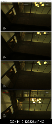

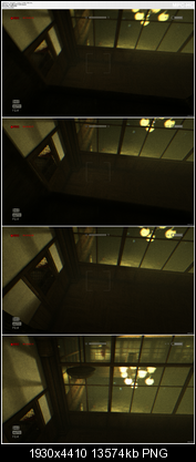

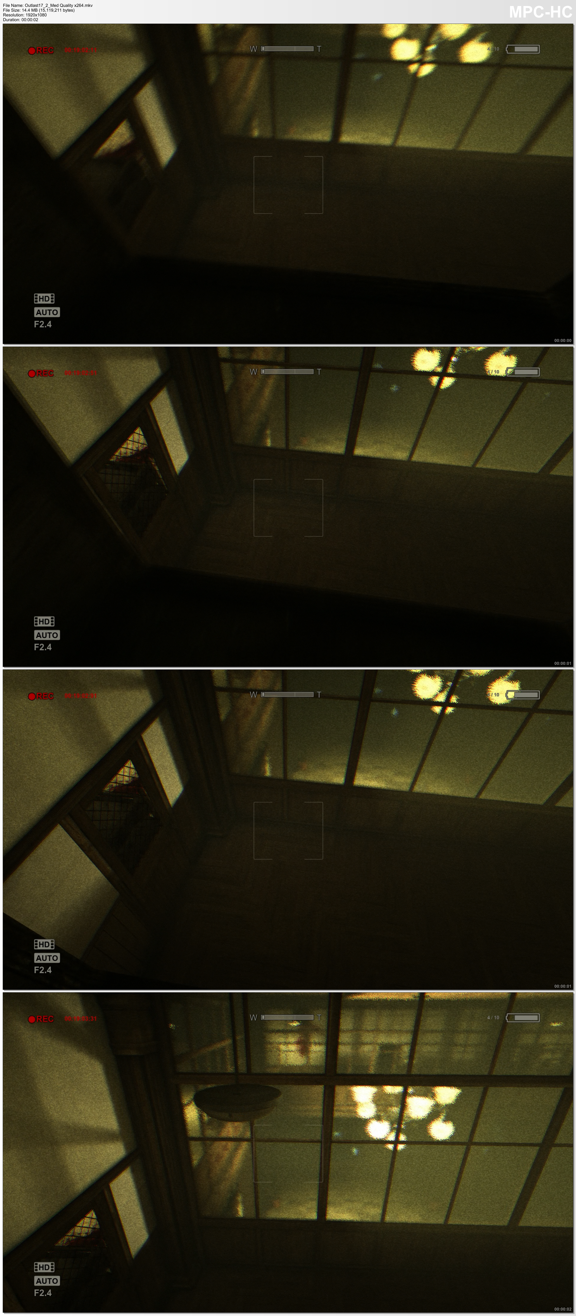

    I'm searching for MeGUI presents that will allow me to convert my FRAPS captures to videos that strike a good balance between archival quality and manageable bit rate. I have found a few that seem to work well in lighter areas and in darker areas with strong color contrast. Finding presets that perform well in lighter scenes has been easy. However, using those same presets, I notice much lower quality in darker scenes that contain areas in which the color contrast is very low.
    I have included screen shot's below. This phenomenon can be seen on the wooden floor and the lower, wooden portion of the wall, even as upper portions of the images seem to remain much more true to the original. This is especially true of the "Low" quality x264, which is still about 7 GB per hour of video, before sound is added. The "High" quality x264 seems to produce a reasonably good, but not great, quality image, but the files using this preset tend to be about 25-30 GB per hour of video, before sound is added. This seems excessive. Is there a way I can clean up the quality in these types of dark scenes without resorting to extremely high bit rates?
    Thanks in advance.
    All of the x264 streams were encoded with 10-bit color, and the screenshots were taken using MPC-HC.
    I was able to see the differences best by putting each image into it's own layer on the same Paint.NET file. That way I could toggle between any two images for comparison.
    Original FRAPS Capture - 383 Mbps
Name:	Outlast17_0_FRAPS Capture.png
    High Quality 10-bit x264 - 95.7 Mbps
    program --preset slow --crf 12 --output "output" "input"
Name:	Outlast17_1_High Quality x264.png
    Medium Quality 10-bit x264 - 60.5 Mbps
    program --preset slow --crf 16 --output "output" "input"
Name:	Outlast17_2_Med Quality x264.png
    Low Quality 10-bit x264 - 25.0 Mbps
    program --preset slow --crf 22 --output "output" "input"
Name:	Outlast17_3_Low Quality x264.png
