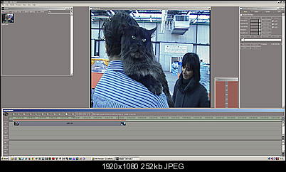

  2. this is winXP

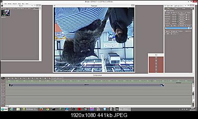

    and this is windows 8.1 64bit

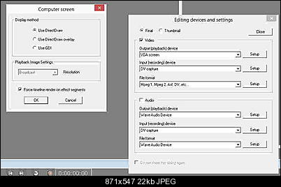

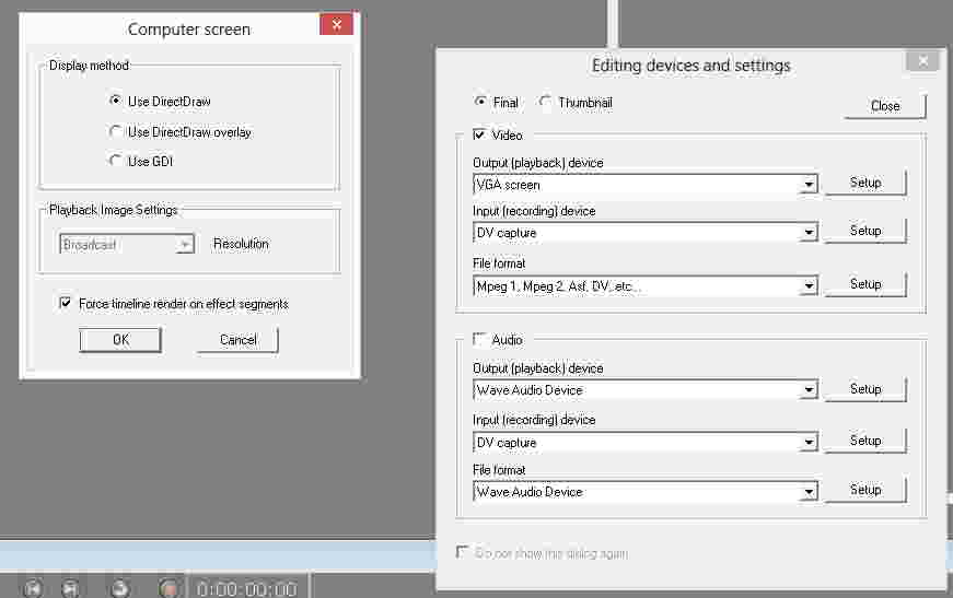

    when I set
    Use directdraw= cat upsidedown (wrong) but quality is ok
    use directdraw overlay= cat ok but quality wrong (too aliasing in details)
    use GDI = cat ok but quality lower
