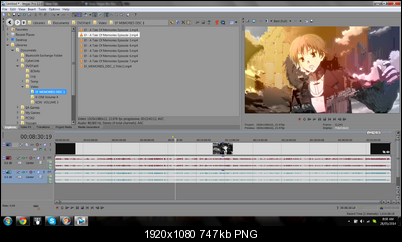

    Every time I insert a Blu-ray clip that I have ripped off a BD disk, or something along those lines into Sony Vegas 12.0,
    I get distorted imagery like this
    I have rendered it out, and nothing has changed.
    Here's an image:
    If I can get some advice/feedback on how to fix this, that would be tops.
    Thanks!

    Are those 3D clips? Do you have the project's Stereoscopic 3D Mode set to side by side?
    You can verify settings by clicking on File -> Properties on the menu bar. If the clips are not 3D or if they are and you do not want to render 3D SBS, then set Stereoscopic 3D Mode to OFF.

    Yes, Brainiac is right, that's what it looks like to me too.
    More info, please.
  4. I thought he meant the data dropout. Is this a 3D clip?

    Preview Mode is a rough idea, not accurate. Switch to Best to see what will render.

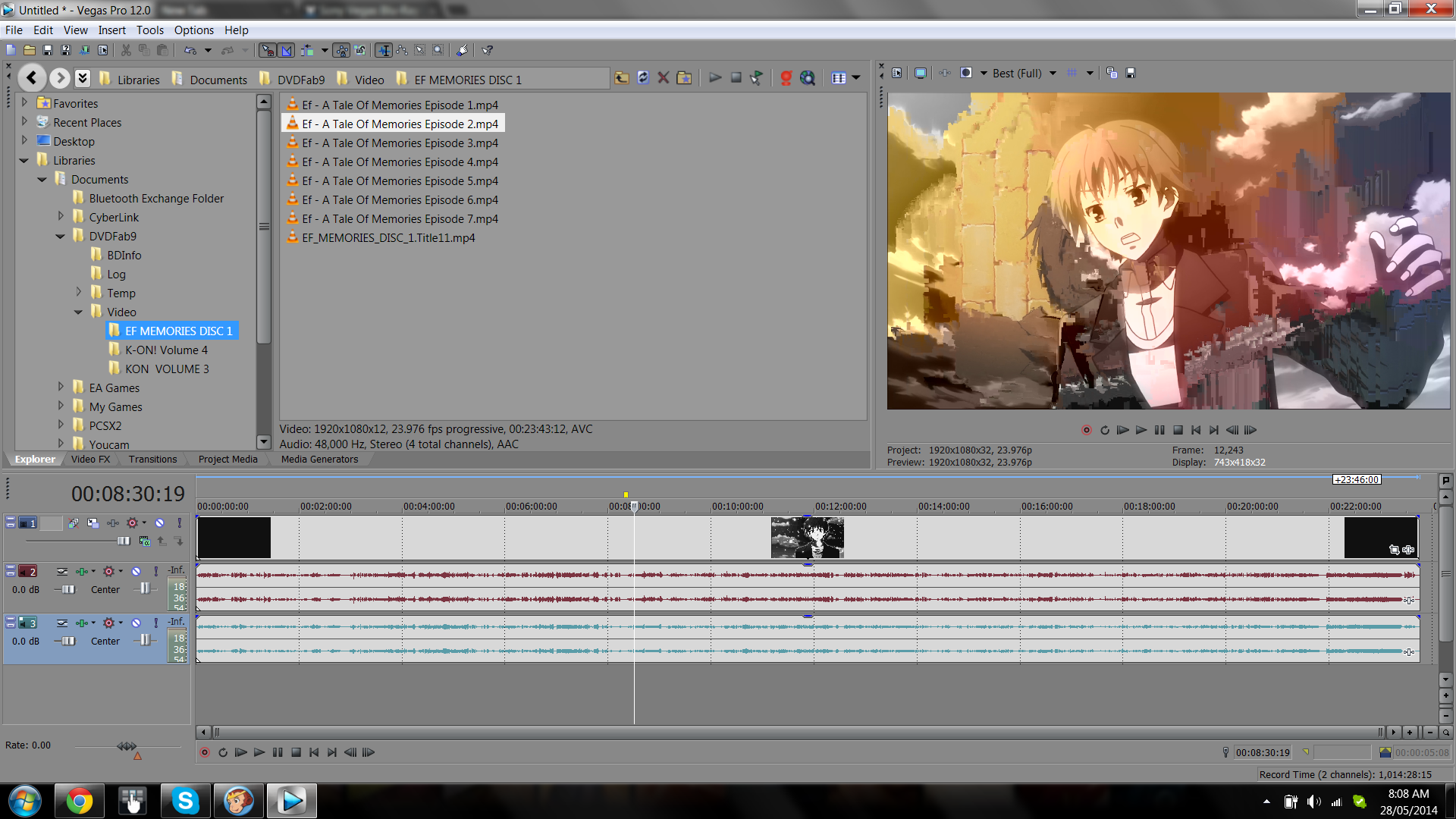

    I have tried all the above...still nothing has worked.
    Here is another image.

    That's a codec/encoding issue.
    You probably need to convert to another format like AVCHD, Cineform or Mpeg2.
    It doesn't surprise me that Vegas has an issue with a ripped BluRay. Since Sony is a media company.

    Also you should change your thread tittle. Your problem has nothing to do with blu-ray. Blu-Rays don't use mp4...........
