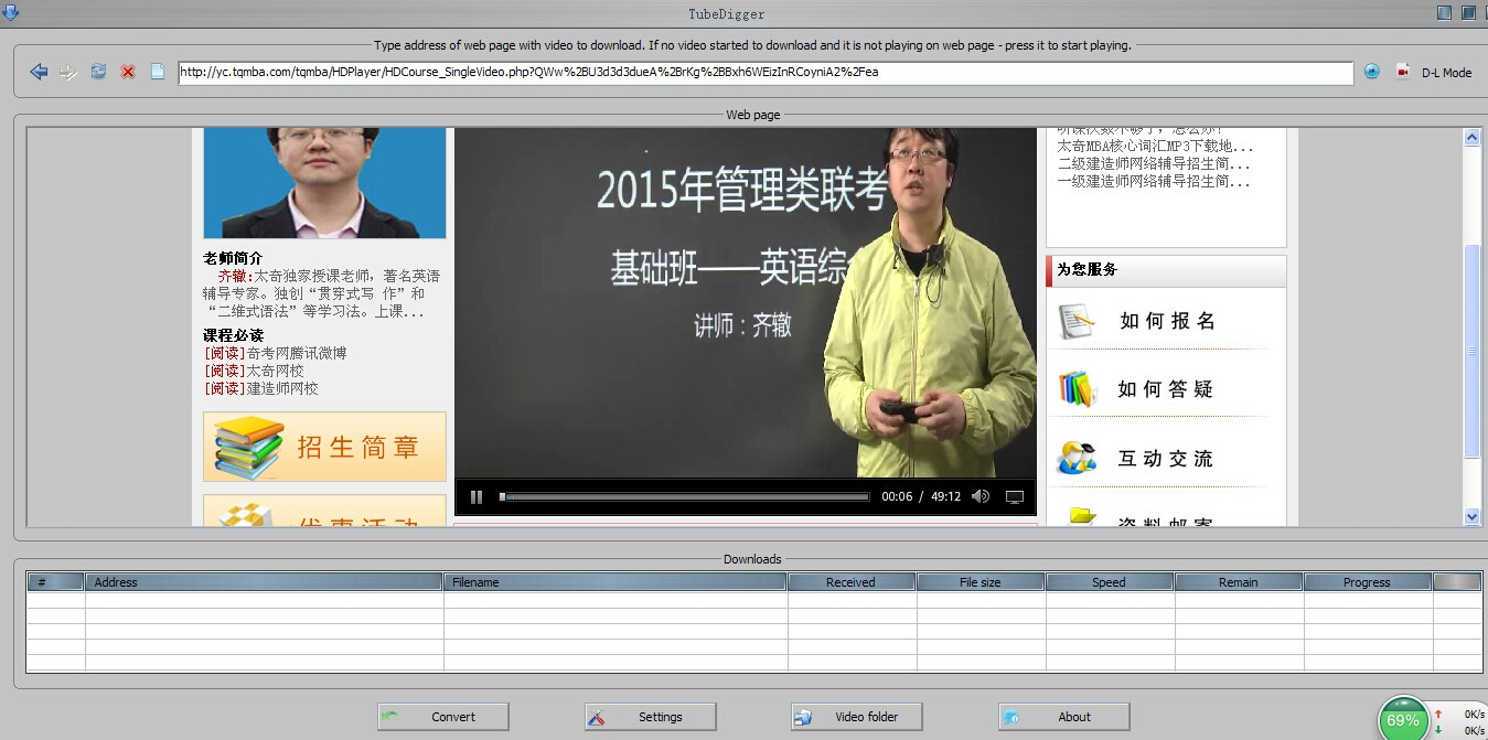

    i don't want u to be inconvenient .. but would u kind enough 2 tell me why this is happening.... something wrong with my laptop?
    BTW i use the FireFox....
  13. i reinstalled Adobe flash player and TubeDigger and restart my computer! somehow someway it is downloading right now! many thanks guy, give my thanks to all of u which would like 2 help me~
