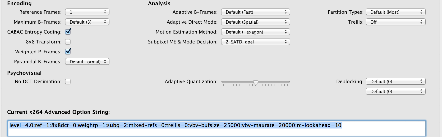

    Last time I checked handbrake had an option to start an encode at a certain frame, I know it worked, but the audio took a second or two to kick in. Maybe they've fixed the audio bug by now. I'm assuming that's how it would 'help'. If you expected to be able to cut the file wherever you wanted afterwards you were wrong, I believe Handbrake uses the default Keyint of 250 which will likely let you cut at about 10 second intervals.
    Try handbrake again and set it to start at the correct frame.

    I've included a screen shot of the default settings in the advanced options panel of Handbrake, because I don't entirely know what your referring to or how to do it. And I'll get to trying MKV Cutter too. Thanks.

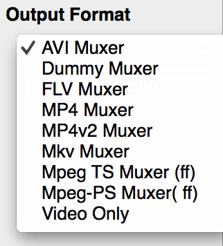

    OK, well bearing in mind that I want to keep as much of the quality as possible, which output type should I use with avidemux? Thanks.
    NB - Sound doesn't work in the avidemux preview.
    Image Attached Images
    Last edited by lapsang; 26th May 2014 at 10:25. Reason: More info about avidemux use
  9. Use mkv muxer.
    The lack of sound might only be missing in the preview , or there might be another version of avidemux that might be better . It can be a bit buggy
    For video you want to use x264 . The lower the CRF value, the higher the quality. By the time you reach zero, it will be lossless but several times larger than the original (it's uncompressed, then re-encoded losslessly). If you pick between 18-22 there should be minimal quality loss with decent filesize tradeoff

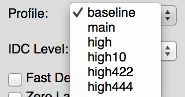

    OK then. Some follow up questions, if you don't mind:
    Which basic profile is the best selection for quality? With or without zero latency?
    Thank you!
  11. high10 is 10bit AVC , it is better, higher effeciency, but not compatible with most devices, slower to encode
    "high" is the usual 8bit variety. Probably what your source uses. That's what you should probably use
    422 and 444 are better chroma subsampling, but if your source is 420, they are not useful
    Don't use zero latency
