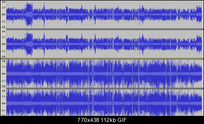

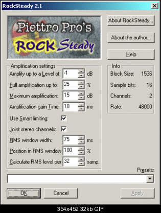

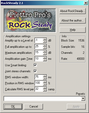

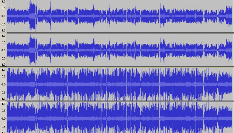

    I use the RockSteady plugin I linked to myself. I don't know whether you could call it a compressor as such (same with the Loudmax plugin) because it doesn't actually compress the loud bits..... rather it increases the volume of the quiet parts. I guess the end result is somewhat the same, although I have the amplification time set to the minimum (10ms). I've found a setting which seems to work well for me (I'm not constantly reaching for the volume control) and I rarely hear it working, but you could set it to "compress" more by increasing the full/maximum amplification amounts a little.
    This was encoded using the same settings I use on playback. The first is a soundtrack downmixed to stereo and normalised. The second was encoded via DirectShow. I used ffdshow to decode, it's volume filter enabled with a volume reduction of 6db applied (to prevent clipping and give the compressor plugin more room to work), it's mixer filter downmixing to stereo (with the centre channel boosted a bit), and finally ffdshow's Winamp filter running the RockSteady plugin.
