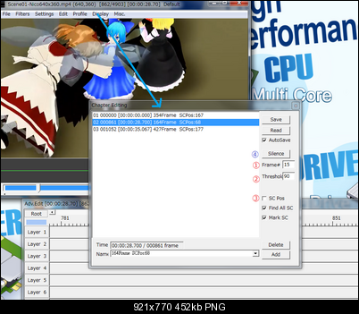

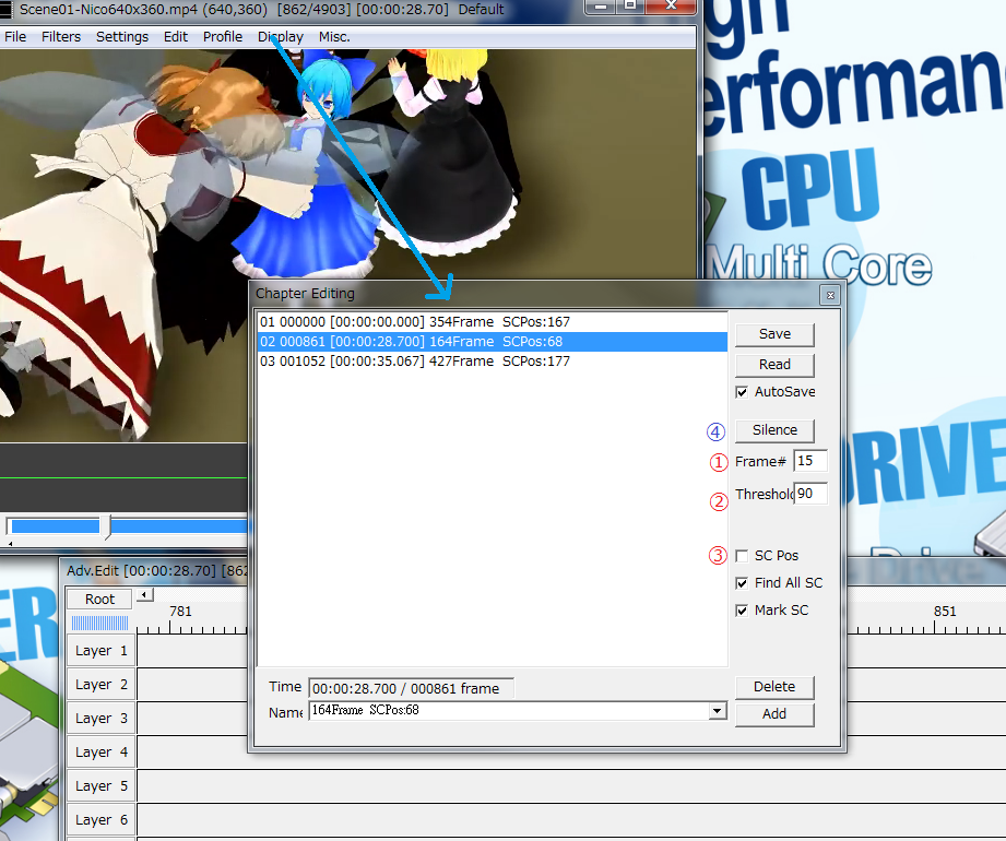

  7. If the video is silent for the duration of the black frame, there is a semi-auto way of chapter creation in AviUtl:
    Under the Window/Display menu, there is an item called "Chapter Editing". Open it...
    (1) The minimum duration of silence to trigger the addition of chapter (as number of frames)
    (2) Lower threshold allows the inclusion of faint sound/BG noise, use High threshold to find absolute silence
    (3) Adjust the chapter point to the nearest scene change (may or may not work as intend)
    (4) Click the button to begin processing
    (Optional) Click on the Name field to change the chapter's name
    When done, follow the instruction here (from step 4):
    http://mavericktse.mooo.com/wordpress/archives/1014
    To encode the video with chapters.
    You may also try to save that chapter file and mux it back to video using MKVMerge... but I haven't tried that myself and can't guarantee if the chapter format is compatible.
