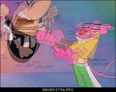

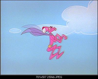

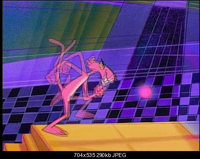

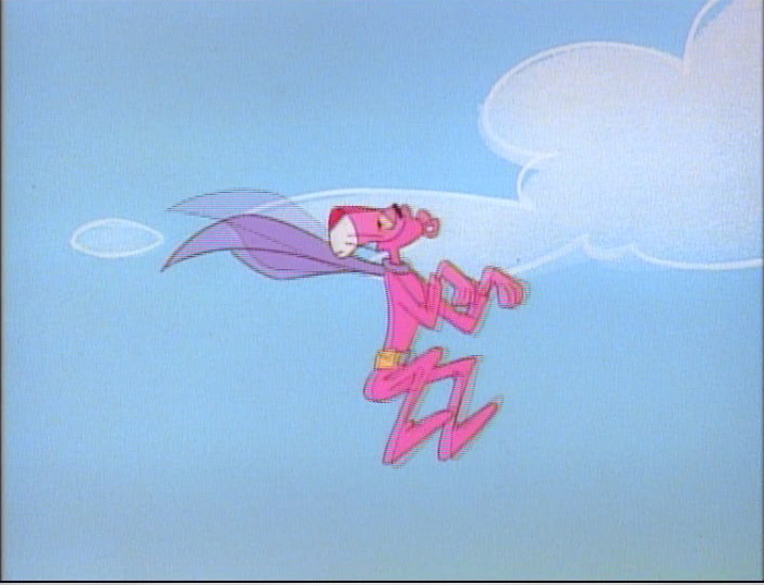

  1. I am trying to rip my Pink Panther Cartoon DVD into 576p h264 files, but I am a n00b when it comes to PAL since I live in the NTSC world.
    I thought that PAL was a 24fps to 25fps speedup so all that I needed to do was deinterlace or decomb but as far as I can see there is a "pulldown" stuck in this, but I maybe wrong so that's why I am posting and asking for help.
    So do I need to remove the pulldown like I would for NTSC? If so what would be the frame rate? 24 or 23.976?
    Below are some screen shots of what looks to me like a pulldown.
    I uploaded 2 minutes of the VOB file from the DVD if you want a look at it: https://drive.google.com/file/d/0B3fl7e8HZwOqUkI4Wmk4aEV2N0E/edit?usp=sharing

  2. Generally PAL is just "film" sped up to 25fps (unless it's "native" PAL) and it's either interlaced or progressive, but sometimes pulldown is used for film to PAL conversions. I think the pattern is 2:2:2:2:2:2:2:2:2:2:2:3, so you'd see one "interlaced frame" in around every 12 frames.
    However...... your sample looks purely interlaced to me. It just needs to be de-interlaced to 25fps.

    It's a combination of phase-shifted 2:2 and random field blending. I suppose this was an NTSC master run through a "smart" converter that incorrectly guessed a lot of the content was video. There's a lot less blending in the episode itself than the opening credits.
    Avisynth script to reverse the 2:2 part:
    MPEG2Source("PP_PAL.d2v")
    TFM(PP=0,slow=2) #frames 144, 146, 148, etc. are interlaced due to field blending
    Perhaps SRestore can help with the blends.

  15. To get vps in handbrake you select bob as the deinterlace method and specify the output frame rate as 50 fps. You'll still have blended frames, of course. To get rid of the blended frames you'll need to use a filter like SRestore() in AviSynth -- you can't use Handbrake for this.
    Mpeg2Source("PP_PAL.d2v")
    Yadif(mode=1, order=1) # double frame rate smart bob
    SRestore(frate=25) # preferentially discard blended frames leaving 25 fps
    That left a few blended frames here and there. You can play around with the parameters of SRestore() to further reduce them.
