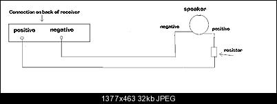

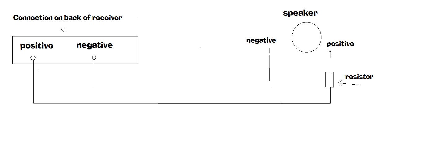

  8. Originally Posted by wingnut2003 View Post
    Originally Posted by Leon101 View Post
    Thanks you guys are really fast. MY current speakers say "impedance: 4 ohms" so guess I need new ones.
    Yes the receiver has 2 outs puts but the sub looks like it only has 1 input for the sub. That's why I thought I needed the Y splitter.
    you could add a 4 ohm resistor in series to the positive side of the speaker to give you at lest an 8 ohm impedance. have done this many times and has worked fine.
    How would one do that?
    I'm anxious to hear my new receiver since it just came in the mail. I was hoping to be able to use my old RCA speakers from my old RCA receiver until I read they were 4 ohms. That's why I'm shopping around for a match quickly.
    I chose the Yamaha because I didn't want to spend a lot of money again when I just paid around $250 for the receiver. All 7.1 systems I've seen are in the $300 mark.
  9. Click image for larger version
    quick diagram, you would do this for all speakers except the subwoofer.
    If it's an ambulance...you got a chance. If it's a hearse...it's even worse!!!--Judge Alvin "JP" Valkenheiser
    Want to extract audio from .vob files? Read my guide at https://www.videohelp.com/forum/viewtopic.php?t=187078
  10. Originally Posted by wingnut2003 View Post
    [Attachment 25359 - Click to enlarge]
    Thank you, I might run to radioshack and see if I can get some of these resistors and try this today hopefully
