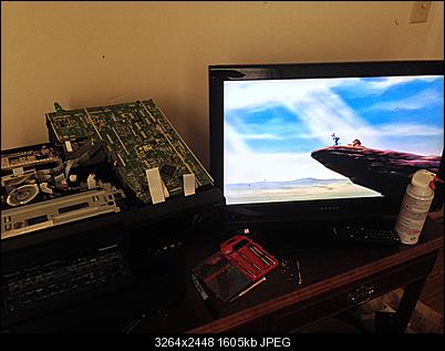

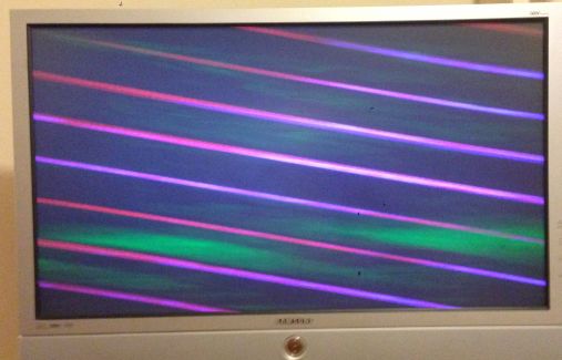

    Last week I purchased a Panasonic AG-1980. It came in cosmetically good shape, but it doesn't work properly. It loads and plays the vhs audio fine, even locks into stereo sound. The video output is the problem.... It is greenish and heavily sheared diagonally. I have tested all 3 (S-vid, composite, and VHF) outputs, all of which output the same sheared video. I also tried two different TVs. See attached photos.
    My question is - should I send it back? Im tech savvy, and if it's as simple as cracking it open and adjusting a knob or aligning it that wouldn't be a problem. I can even solder and replace faulty passive components if need be. Is there an easy way to fix this? The video tape I played is a known good one.

    Hoser Bob, these machines have more electronic problems than mechanical. DVD VHS combo's, just ask Lord Smurf about using those....You know what the old JVC combos MV1 or 5, record great, it is just u can't use the VCR part.
    1st thing try another s-video cable and tape also try to clean out the s-video port in the back. Kind of make sure u have no splintered fragments in the s-video port. Than try to clean the heads.
    More than likely send this one back. No picture on these units are a nightmare to fix, you can use it as a project to try to learn how to fix these VCR's. However when I first started working with these units, the 7 or 8 techs I sent these AG units to, could not fix them. It took me a year to learn how to rebuilt these.
    If what I wrote above doesn't work, I can fix this, but no picture usually means it is going to cost a lot and a few months or a long time to repair.

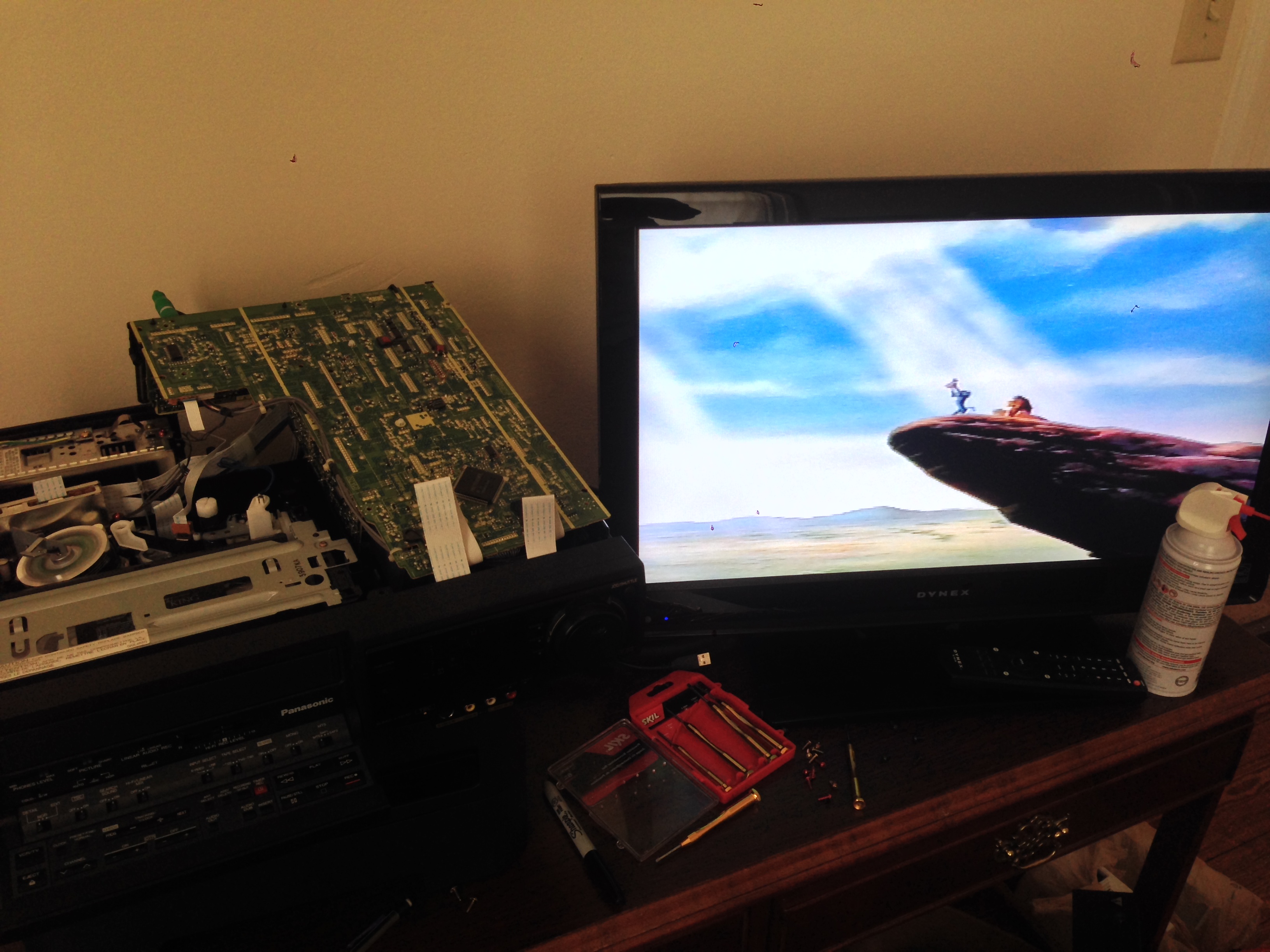

    After some gentle percussive maintenance (tapping) with a small plastic screwdriver I narrowed the issue down to a certain area of the main circuit board assembly. A clear video signal would come and go... In past projects I've had luck with moving the pots back and forth, so I tried it....
    It turns out that the 'EE Y Level Adjust' was dusty. A little de-oxit and some movement got it back into working order!
    ..I wonder how long it'll last...
