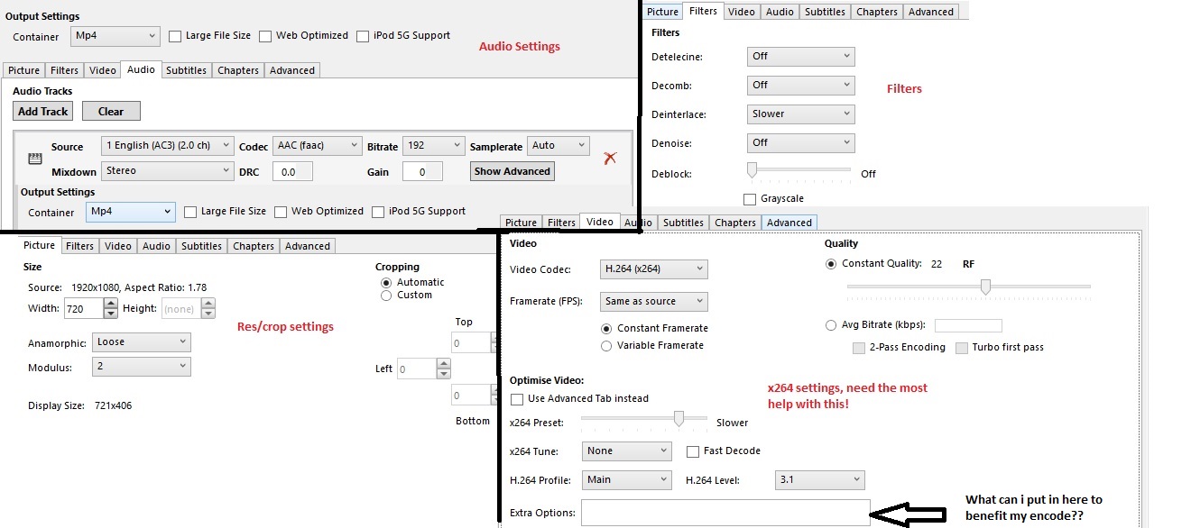

    Now that I've given you my life story my question is: How am I sure I am using the best encode settings for the resolution I use which 720x406 (around that size)? Ive read many people using more x264 settings and tweaks to get the encodes looking sharper, smoother, and generally looking very optimal.
    Here are my app settings:
    https://forum.videohelp.com/images/imgfiles/9JtcTLi.jpg

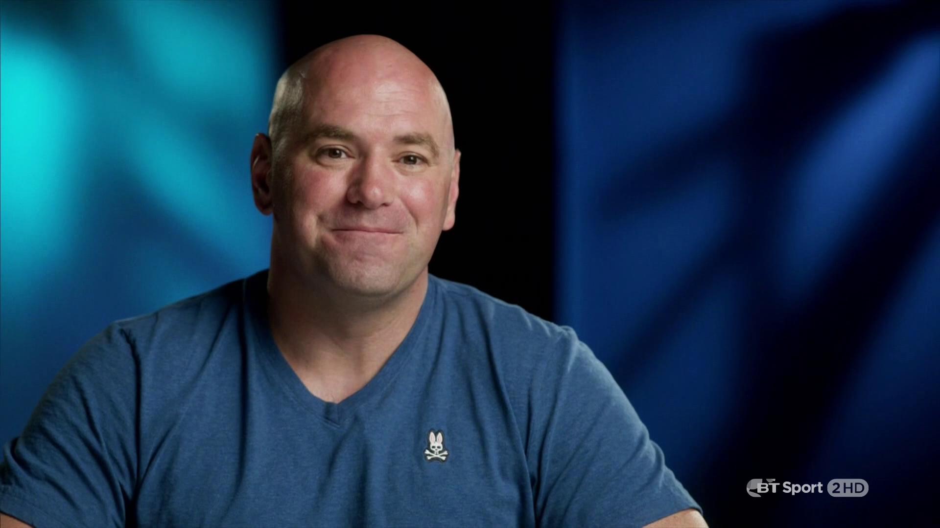

    Here's a screen of the source:
    https://forum.videohelp.com/images/imgfiles/DE0VEsO.jpg
    Here's a screen of the encode:
    https://forum.videohelp.com/images/imgfiles/VO42eNd.png

  4. With interlaced sources you want to use the bob deinterlacer (double frame rate) to keep smooth motion. Or leave the material interlaced and for interlaced x264 encoding by entering "tff" in the extra options box.
    May 2014
    Down the road, last house on the right
    Not a console user myself but I noticed typical blocking artifacts on your encode.
    What you are doing is taking 1080i source (with an ac3 audio track) to 720p to an mp4 with a aac audio codec which
    is fine.
    I would recommend changing the de-interlace to off and turn the decomb to either default or bob (which I like better).
    If you use 'bob' use constant frame rate and 'Same as Source' only or you'll get audio sync issues for sure. By the way I
    did notice a small amount of on your encode you posted.
    As for the video tab portion, try going back to the default RF 20 instead of 22. You will end up with a better looking
    encode. I tried it myself and it is an improvement.

    Thanks both of you for the replies, I will use a lower CRF & Bob in the future. Also is bob recommended for all types of shows or just for fast motion sport like wrestling etc? Also would you guys recommend me using 50 FPS instead of same as source, would this benefit the motion in any way? Ive heard people tell me Sky broadcast in 50fps but i seen on the media info its 25.000?
    Anyhow would it make a difference if i encoded the files with 50fps? Obv filesize but viewing experience? Or is 25fps best

  12. That particular source isn't very good. It's been through a frame rate conversion. It has blended fields and it's jerky.
    Jun 2011
    England
    Frame Rate conversion from the broadcaster? Or because I ran it through Video-Re-Do?
    I'm thinking the broadcaster, YOUR source broadcaster is in the UK right?
  16. Originally Posted by EzK View Post
    Yes. In Handbrake, be sure to set the frame rate to 50 fps when you bob. I don't have any 1080i PAL sources right now but here an NTSC 1080i video converted with handbrake with bob and 59.94 fps.
