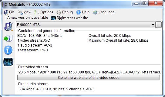

    Source MTS from camcorder:

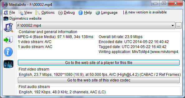

    After MKV2MP4:

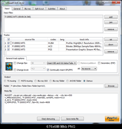

    tsMuxeR settings:
  2. Originally Posted by Lossless Lion View Post
    1. Does MKVtoMP4 re-encodes the video?
    It does not. It will reencode the audio if it's not suitable for the MP4 container. It may lose or add some metadata -- that would explain why your demuxed streams are different.
