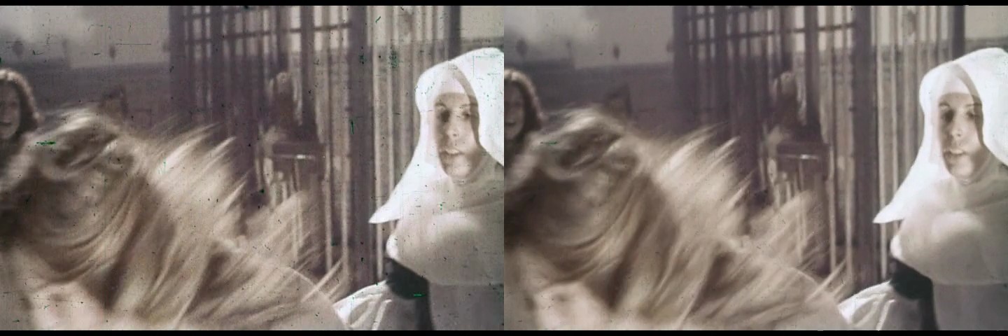

    Hi, there!
    I have a problem in my DVD after I ripped it, I saw dirt and green spots all over the movie, any idea?
    Here is the sample:
  2. A few passes of RemoveSpotsMC() will get rid of a lot of them without damaging the picture too much. It's less effective on very high motion areas.

  3. Member TeNSoR's Avatar
    Mar 2014
    Hungary, Debrecen
    [Attachment 25324 - Click to enlarge]
    wow! the result seems amazing Thank you, Can you send me a link for this filter, if you please?
  4. RemoveSpotsMC.AVS: https://forum.videohelp.com/threads/363894-De-interlacing-Is-My-Workflow-Right?p=231634...=1#post2316342
    It requires several other filters. You can see them in the script.
  5. Member TeNSoR's Avatar
    Mar 2014
    Hungary, Debrecen
    Many Thanks
  6. If you can get rid of the splices and restore the missing frames you've REALLY got something.
  7. If you're really adventurous you can try replacing some of the worst frames with motion interpolated (from the adjacent frames) frames. The original function was called RX() but I changed it to ReplaceFramesMC().
    https://forum.videohelp.com/threads/352741-Frame-interpolation?p=2226119&viewfull=1#post2226119
    It doesn't work well when there is a lot of motion. When there's no, or very little, motion you can just replace the bad frame with an adjacent one.
