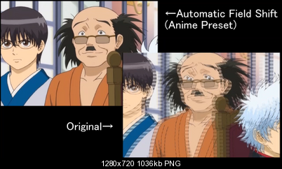

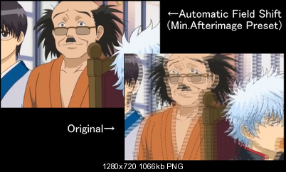

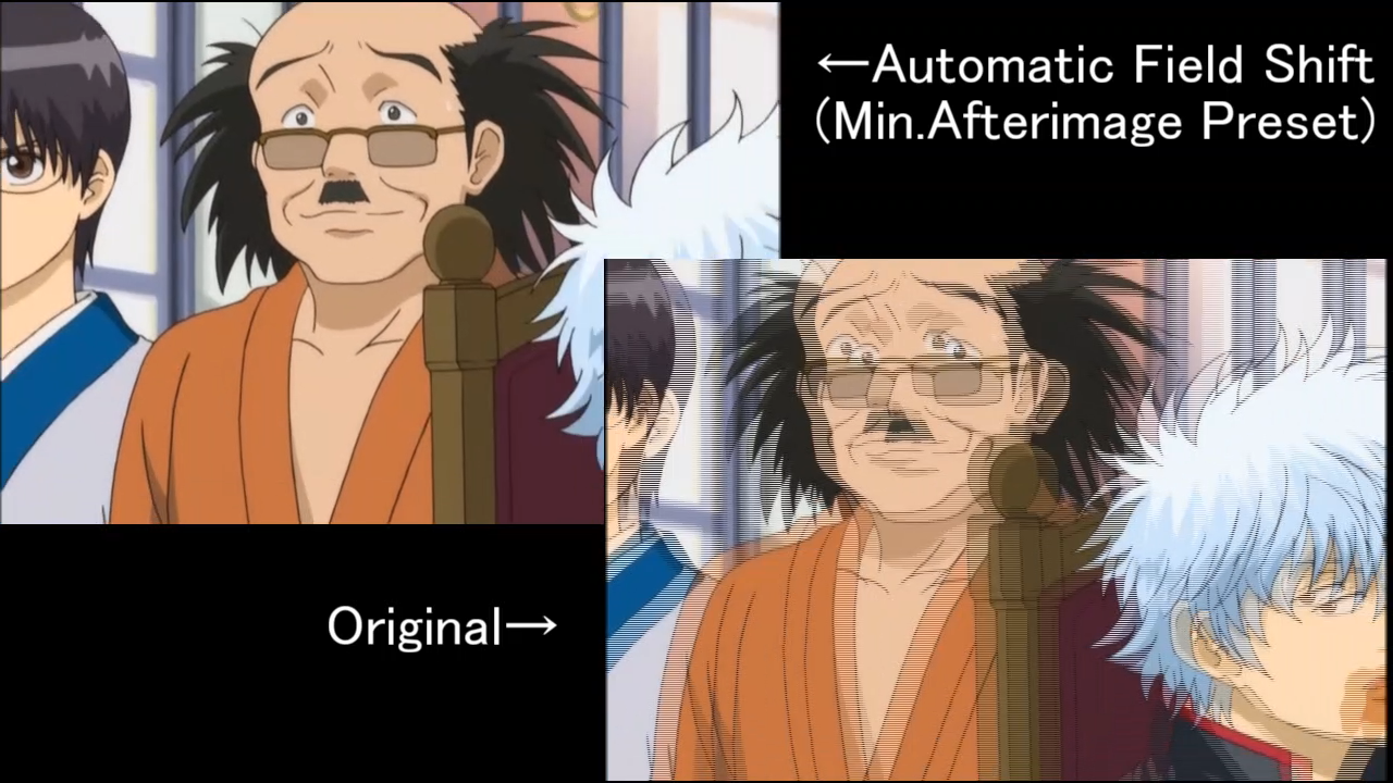

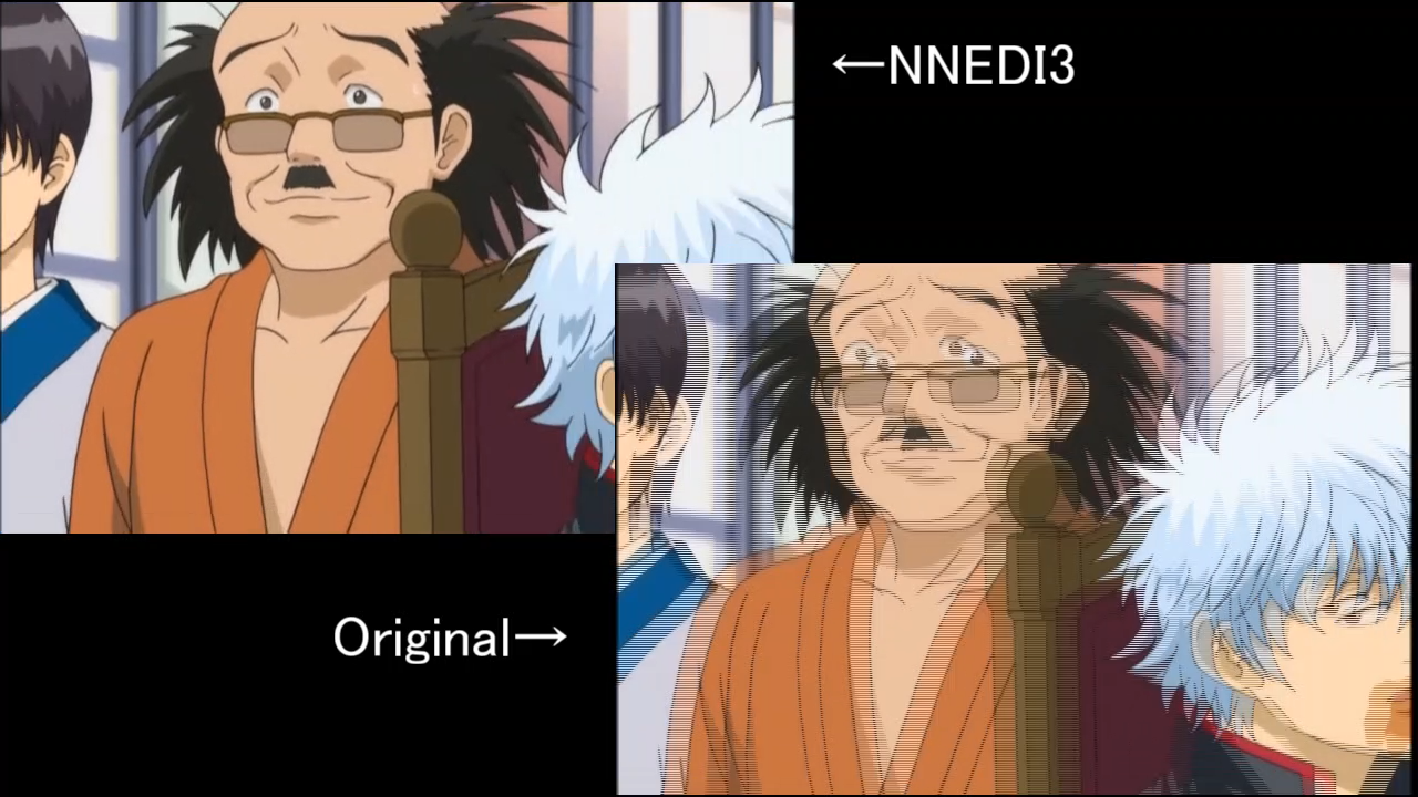

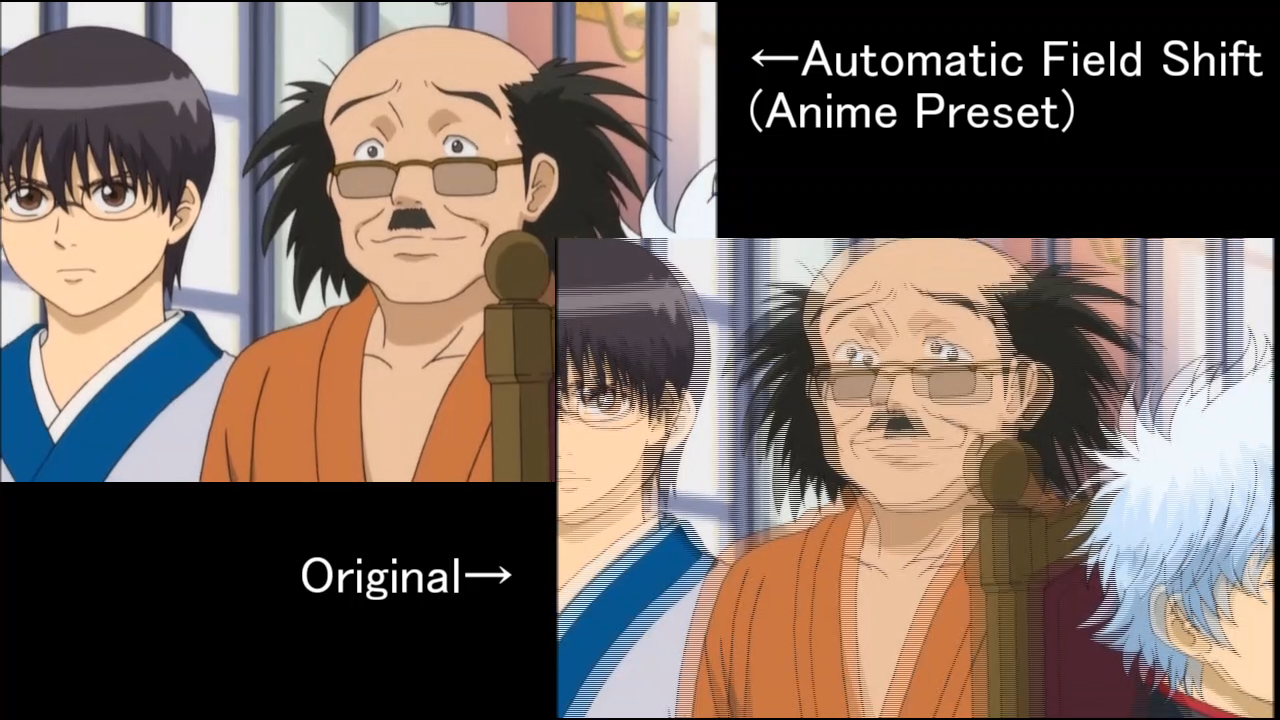

  14. Deinterlacing attempts of Sample#4 using AviUtl:
    CmpVideo.mp4
  15. DGIndex I believe just sets the MPEG flags, obviously you don't want to change VOBs to 23.976 w/ 2:3 pulldown, actually the flag you want to use if it's available in DGIndex would be "3:2 Pulldown on Playback" which is an MPEG flag that is the exact Opposite of the progressive pulldown used on interlaced video. However I have tried that before and it didn't do any better (or different) then auto inverse telecine as that's all it is but for players to optionally use. That still won't solve some of the anime issues like mixed frames w/ weird ghosting.
  16. It looks like MaverickTse has found something, thanks I am going to try that too!
  17. AviSynth also has NNEDI3 plugin and that should be good enough for most occasion.
    (field 1, nsize 6, nns 1, qual 1, etype 0, pscrn 2, rfactor 1, cshift 3)
    The alternative methods, AFS, will create Variable Framerate (VFR) video, so please beware.
