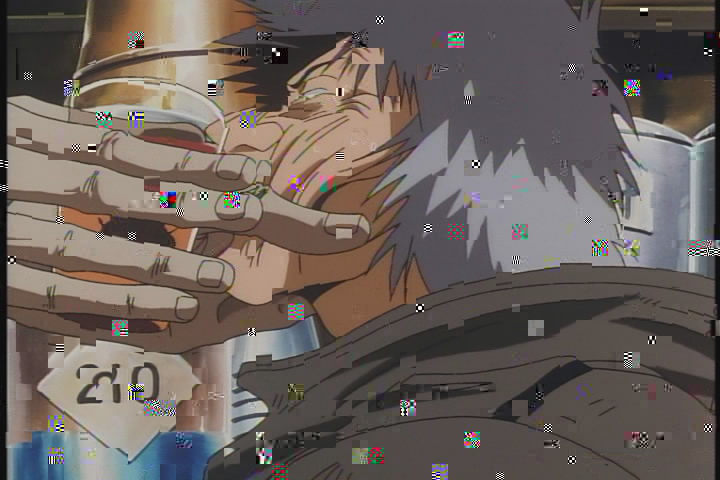

  1. It may be commercial in the sense that he paid money for it, but it's a bootleg I'd bet money. coldstatic, is this from one of those 3-DVD box sets that are all over eBay? You get what you pay for and in this case you paid for crap.

    Its a 6 disk series with single big box. The disks don't look like bootlegs either. I am curious to hear if jagabo has any other thoughts on the rip process. I went out and got the livcss.DLL file and put it into my handbreak folder like all the instructions said. Before I put that in there it wouldn't even scan the disk. For the sample cut I just followed the instructions. Open file set edit then demux.

    The 'rip process' means decrypting to the hard drive and nothing else. How about answering his question about how you decrypted it first? Handbrake doesn't decrypt.
    There is a 6-disc set that's legit, I think. Is this the one and did you pay roughly the same?
    http://www.amazon.com/Cowboy-Bebop-Remix-Complete-Collection/dp/B00102FF7U
    But if you never decrypted it properly, that might explain a lot.

    No thanks. Why not decrypt it with a proper decrypter? What you've shown us is very messed up. Maybe I was wrong about it being a bootleg, but unless and until you show us something done right no one can help. And when you do decrypt it properly, then maybe you won't have the problem you're having.

    Easiest is to use DVDDecrypter to rip. Click the link to get it. It works fine with my original disks. I don't know about what you have. Give it a try.
    I used file mode to get files VTS_03_1.VOB and VTS_03_2.VOB if you want just that episode. You can decline to set the region code if prompted. The fallback brute force cracking works fine.

    I suspect the DVD has some kind of structural protection so you can't just use DgIndex on the VOB files. You may need to rip the DVD to a VIDEO_TS folder with DVDFab (an older version that still has DVD decryption) and then use VOB2MPG to extract episodes as MPG files. Then use DgIndex on those MPG files.

    If they are the originals, there is no structural protection. And even without structural protection you still have to decrypt before using DGIndex. Finally, using DVDDecrypter there is no need to convert to MPG. DGIndex accepts the decrypted VOBs directly. Just rip the VOBs and open them in DGIndex. But of course I acknowledge there are many ways to skin the cat. I try to keep it simple for the OP.
    That livcss stuff used in Handbrake may be assembling VOBs out of order, etc. Who knows or cares?

    He says he used livcss, which I suppose does decrypting. But the hosed screens you saw looked more like out of order decoding than outright failure to decrypt. Instead of bothering to reconstruct that, let's see how he gets on with proper ripping.

    But isn't livcss just a dll a decryption library that he copied to the Handbrake folder? DgIndex wouldn't have access to that.
    But I agree that the problem with his M2V files doesn't look like encrypted VOB files.

  16. When I play his sample in MPC-HC I get video that looks a lot like it hasn't been decrypted. Other times, like in DGIndex or opening the M2V in VDubMod, I get video more like jagabo's picture. If it's the one in my earlier link it was released in 2008 and DVD Decrypter should be able to handle it. If not then DVDFab HD Decrypter.
    In addition, jagabo noticed screwy GOPs. I see completely messed up matrices being used. Whatever was done or not done to create that sample, it's no good at all.
