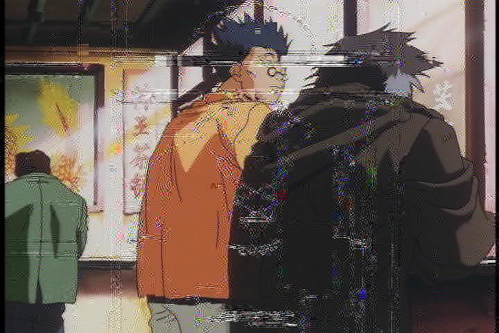

  21. I can't get clean decoding of the samples. The picture starts out OK but after a dozen frames or so it breaks up:
    It gets worse and worse until the next keyframe where it is cleaned up for a while and breaks up again. I see the same thing in several video players including VLC and SMPlayer which use their own decoders. Why are the GOPs so long (~60 frames)?
    [Attachment 25552 - Click to enlarge]
    I was getting the same results......GOPs ?? i goggled it and seeing things like should be 12 and N=3 N/M=5. But if its a setting i needed to adjust in dgindex i did not. I opened the program set my edits and hit the save and demux.
    I'll upload a nice clean sample for you later tonight. Anyway, I doubt you'll find this very interesting. The solution is simple as I have stated. Still, second opinions are always welcome. And maybe you can help with the Handbrake setup.

  26. Originally Posted by coldstatic View Post
    It's a function of the source. DgIndex can't change it. It's the distance between key frames. DVDs are usually from about 12 to 18 (the max allowed for DVD). Neuron2's sample has normal 12 frame GOPs -- and a simple TFM().TDeciamte() returns it to 23.976 fps film frames.

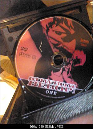

  29. Member coldstatic's Avatar
    Jun 2014
    omaha ne
    Pushed drive button and took this pic. I have all the disks. When purchased from a store afaik its commercial.Click image for larger version
